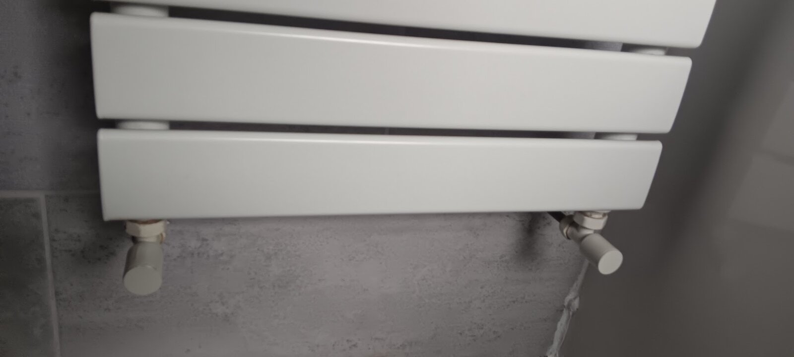

Especially, the towel drying radiator in the bathroom doesn't have any TRV right now, could we fit a Drayton smart TRV on there? Pic below.

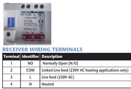

From a wiring point of view, the Salus receiver is replaced with the Wiser One Channel receiver (the version for Combi's) that comes with the Wiser.
WISER
SALUS
Provided that your Salus and new Wiser conform to the above, the wires transfer as below:
Salus 1 NO = Wiser 3 ON
Salus 2 COM = Wiser 1 COM
Salus 3 L = Wiser L
Salus 4 N = Wiser N
If there is presently a link wire between the Salus L and COM terminals, then also link the Wiser L and COM. Note: Do not add the link if it does not currently exist at the Salus.
The TRV's can be fitted where required. But should not be in the same room as the main control thermostat, this is because one will interfere with the operation of the other.
I don't think it's likely for you, but some systems require at least one radiator not be fitted with a TRV to ensure a flow of water through the system when the other TRV's are closing, and often it is the towel radiator, your local plumber should be able to confirm.

As for the connections, here's what the connections on the Salus look like right now.
If you are able to terminate the wires safely then it's fairly straight forward swap for DIY. Just move the four wires from the Salus to the Wiser terminals that have the same function, as per my first post.
Don't make the link between Wiser L and 1 COM that's shown 'dotted' on the Wiser wiring diagram.
The other joined wires stay as they are. I'm assuming they are properly connected in some sort of terminal under the insulation tape.
I don't think there's a terminal under the wire, they're just twisted together and connected. It's just the ground wires as you can see by the colours.

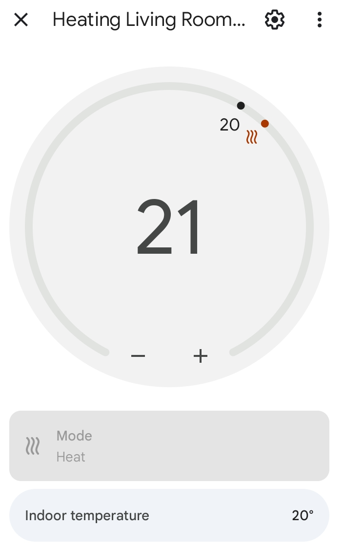

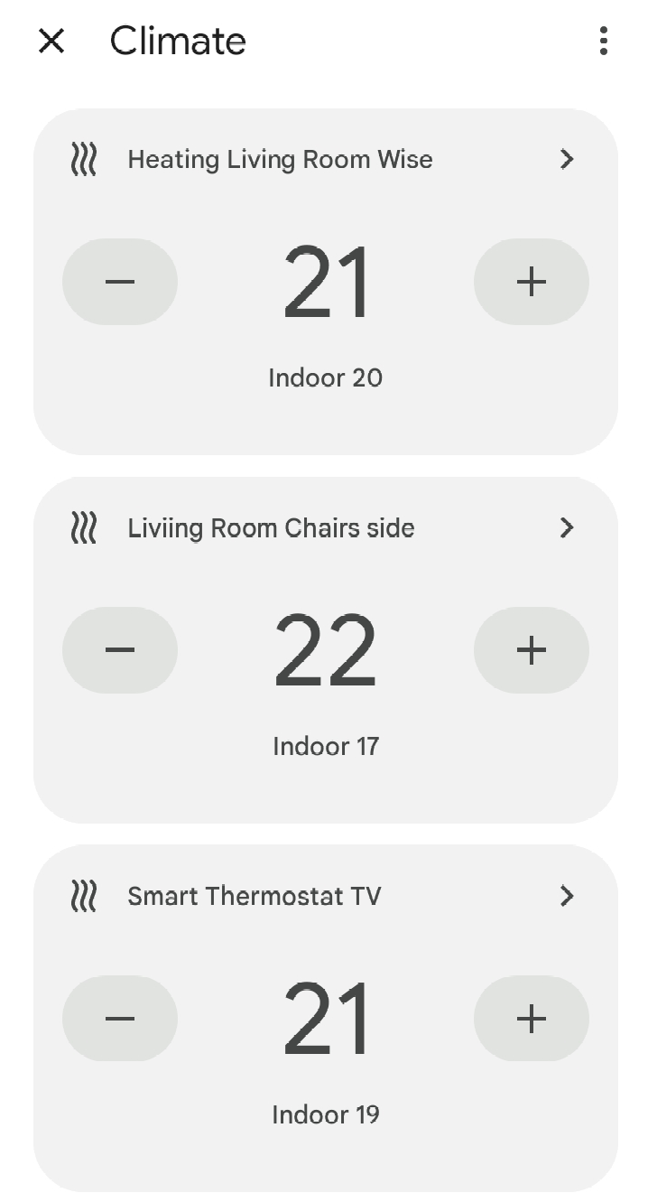

This thread just as I was thinking burr its cold, need to heat the living room. So little difference between comfortable and cold, one thermostat 1ºC from turning on the central heating, the other just 0.5ºC from turning on with the schedule set.
I see the whole idea of a thermostat, which will turn on heating before I feel cold, this room one radiator the TRV says 19ºC heating to 24ºC which it is not doing as boiler not running, the other 19.3ºC heating to 21ºC again not doing a thing since boiler not running, And not helped as can't remember the login for the wall thermostat.
Lucky google home still working 1732293910046.pngso can up the main thermostat setting. It also shows 1732294097145.pngso I can set TRV's and wall thermostat in the same app, But this is the problem, we all want an automated system, but half the time it does not work. OK, age 73 does not help, maybe if younger I could remember the pass words?
But does not change the fact that the more items there are able to turn on heating, the better. So yes, like the idea of Wiser (wish I could remember the log in) as once I fit more units (TRV heads) it will better control the house. Lucky I can manually turn the thermostat up.
