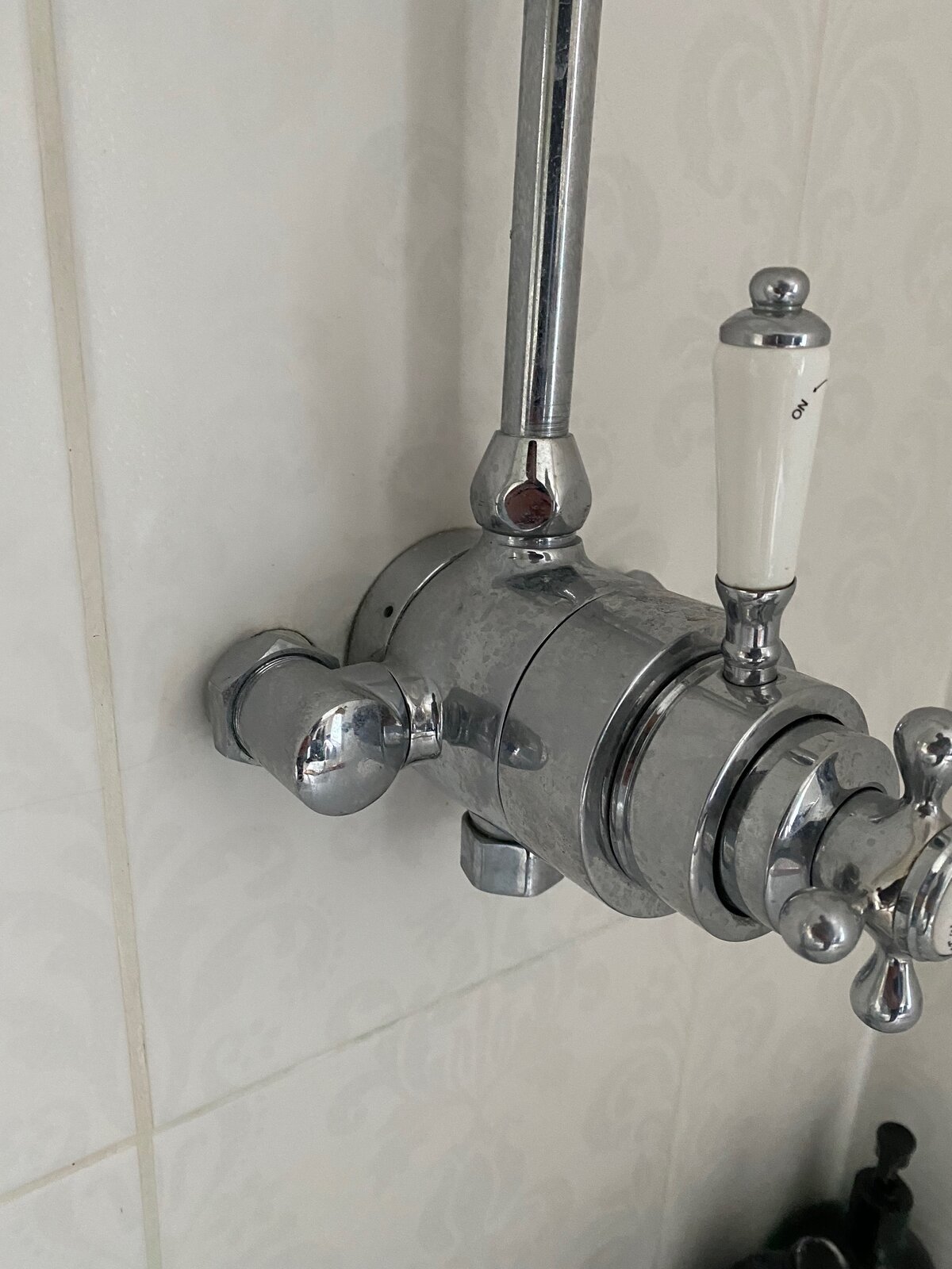

Essentially they never get hot enough (lukewarm at best) unless you turn a nearby cold tap on full after which it gets nice and hot so it feels like the cold water is overpowering the hot within the thermostatic valve in the shower. I've taken the showers themselves apart numerous times, including replacing the wax thermostat, but it had no change on performance.

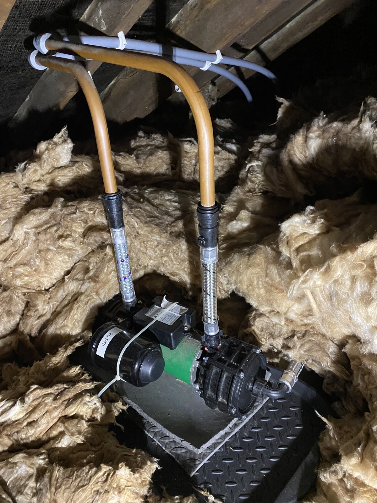

How is hot water feed to pump connected to hot water cylinder?
Picture of pump and its pipework and connection to cylinder would be useful.
Fit a one way check valve on the pump outlet on the hot side. Even though the shower and pump should already have them in place.

Photo of the pump attached. The cylinder is covered by insulation but I can take it off if you think that would be useful?

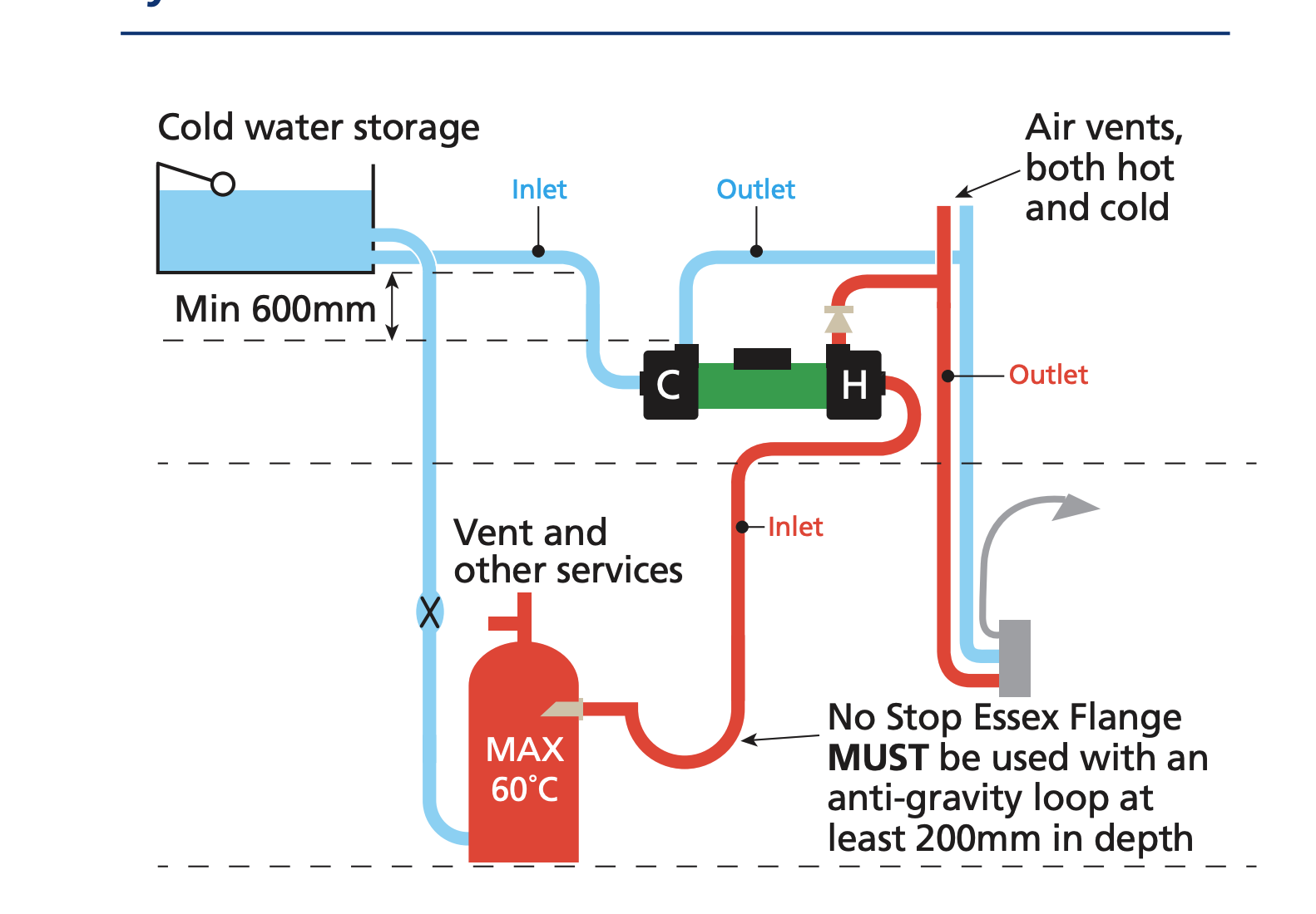

From the pump manual I note it states: " NON-RETURN VALVES MUST NOT be fitted in the discharge pipework between the pump outlets and system outlets unless specified by Salamander"
Source: https://www.salamanderpumps.co.uk/uploads/downloads/Centrifugal Installation Guide - Nov 2015.pdf
But I'm assuming it will still be okay?
I presume the pump is in the attic, the CWSC in the attic and the HW cylinder downstairs? Is there an anti-gravity loop? Pumps in the attic can always be susceptible to problems, it really isn't the best place for them to be situated.
Is this a new issue or has it always been this way? Is there an essex flange in the cylinder? Both feeds supplied by 22mm all the way and the same with the supplies to the showers?
You might be on to something here. You are correct the pump is in the attic, above the HW cylinder which is on the floor below and about the same height as the bottom of the cold water tank. All the pipework looks to be 22mm to me.

The attached screenshot in the Salamander installation guide shows our setup and says "No Stop Essex MUST be used with an anti-gravity loop at least 200mm in depth".

See the photos. There is an anti-gravity loop but only 100mm - there is not much room for any more. I'm not sure if there is an Essex flange installed.
I see that Salamander has its own non return valve so that should be worth a go as a first port of call and if the valves on the showers themselves have broken: https://www.showerspares.com/search/salamander-non-return-valve-nrv/
