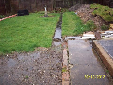

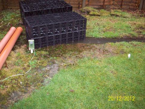

This is my - completely full - soakway test trench. Most of the pipework is already in place, but I haven't buried the crates yet.
2012 has been a rather demanding year for handling/removing rainwater from the roof.
I have seen the water table in the back garden rise to the surface of the lawn twice - i.e. completely overwhelmed!
At the far end of the trench the water overflows and runs away into other gardens. Apparently, this surface water overflow has occurred previously, in extreme circumstances, before I dug my test trench. . . . so I don't feel quite so bad about it.
This new soakaway replaces a badly-placed, clogged and inadequate old soakaway on the high side of the house.
Also, the neighbour's house was feeding into that old soakaway, via a porous pipe, running across the front of my house about 1.5 metres from the front wall.
My ( recently-acquired ) house had severe penetrating damp on three sides before I dug out the clay against the walls, installed french-drains and reorganised the rainwater drainage.
Despite a very wet year the house is is much dryer inside.
It is a pity that the new soakaway in the back garden doesn't work as hoped and will need a surface overflow.

Soakaway's don't generally work in clay. Where will your overflow drain then?
Local Building Control classify this area as "sandy clay".
Many houses in this location have been built ( in the 1930s ) with rainwater soakaways only, fed by porous pipes - although the topography and ground conditions may vary from house to house.
In this case, with the extraordinary rainfall in 2012, the old ( shared ) soakaway and pipes could only supersaturate the surrounding soil and eventually raise the water table to the surface, where it would run-off at the bottom of the garden.

In this case the deeper I dig the crates the sooner the water table will rise and fill them completely.
