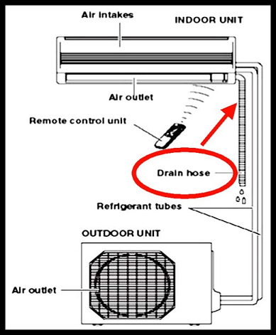

I assume you are referring to fitting the indoor unit in the basement, the "heat pump" part has to be located outdoors.
The basement location may present a problem for you. When in cooling mode any moisture that is contained in the air passing through the indoor unit will condense on the cold condenser surface and produce water. Usually a continual drip to a trickle if it is particularly humid. This water will need to be got rid of, usually this is done via a drain outside. If your basement is below ground level and won't allow the water to escape to a drain by gravity you will need to pump the condensate up to a drain.
