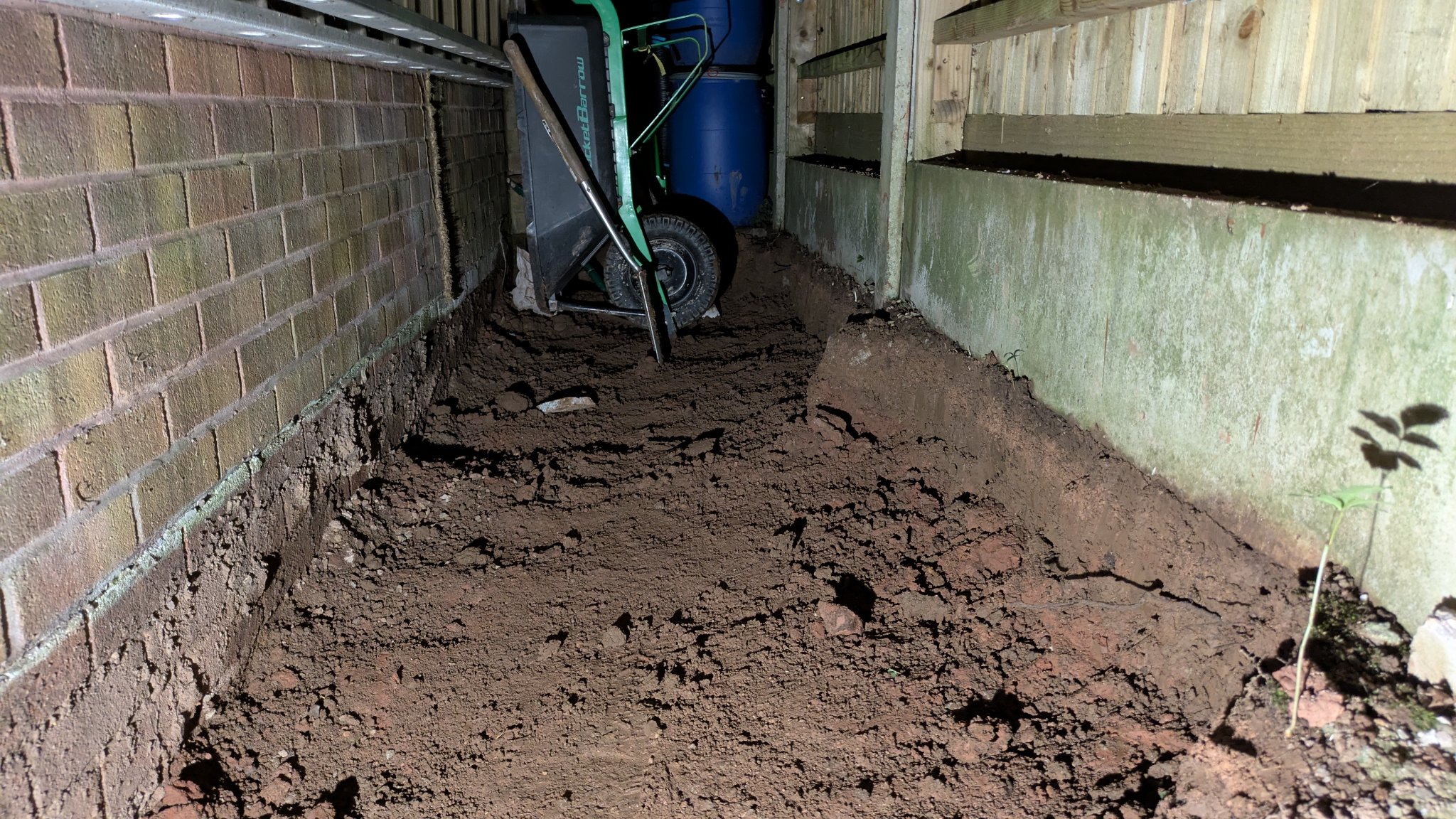

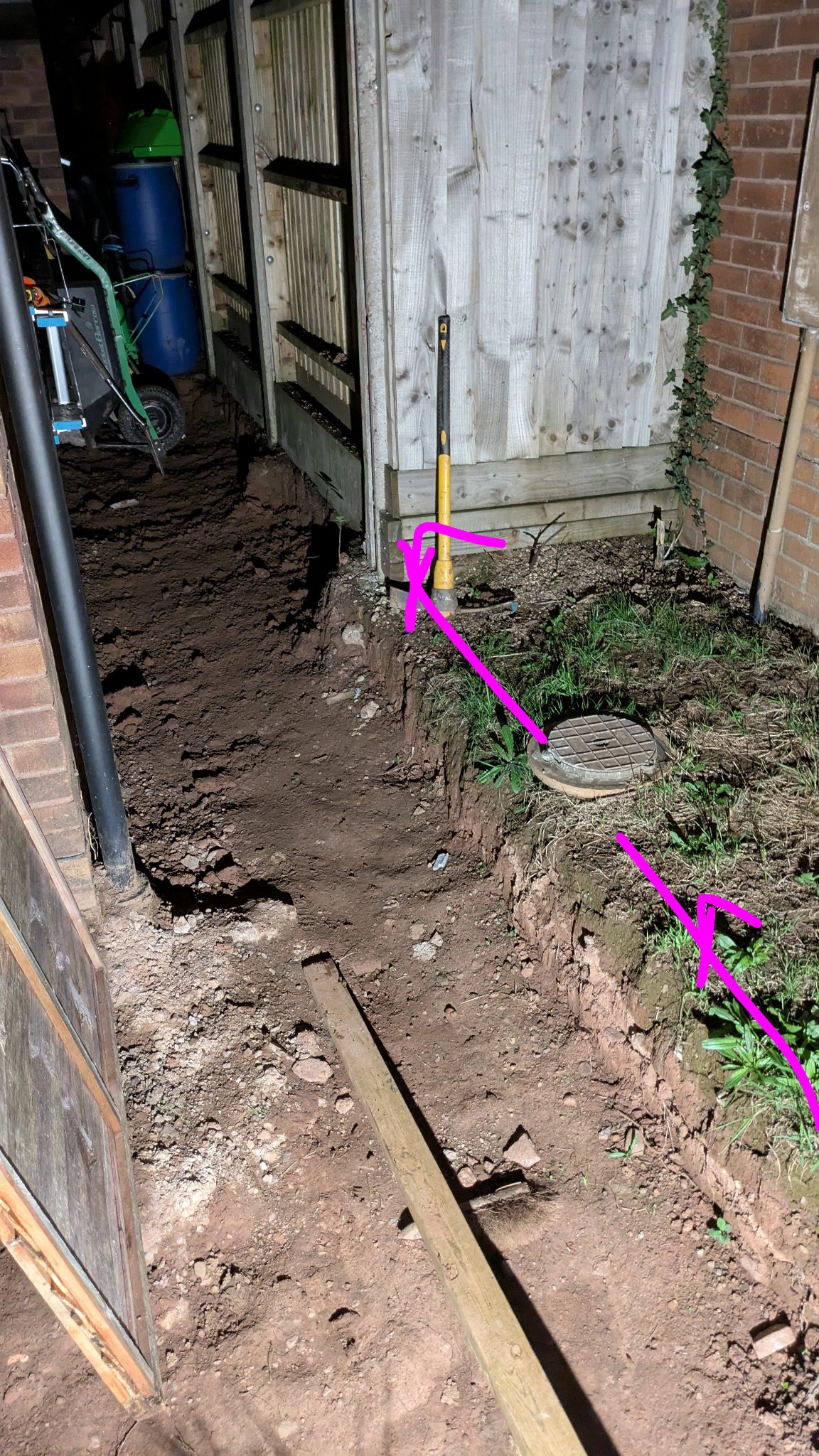

I'm digging out for a concrete path down the side of my house. Ground was up to the DPC in places so it's getting dropped 150mm +100mm slab and 100mm sub base.
Issue I have is my neighbour's house is about 1m higher than mine. Her fence (yes it is hers according to the deed plans) already has a concrete gravel board 300mm high and get soil almost to the top, but it only comes down as fast as my DPC. So if I'm dropping the path I need to drop the retaining too. Board can't slide down any further, I'm not convinced the posts are even in the ground that far. I haven't discussed it with her yet.
I know the proper thing is to replace her posts lower down with another row of boards or build some kind of retaining wall + drainage but that's scope creep. Does anyone have any other ideas about how to tackle this?
Compounding factor is her sewer line runs right next to the fence so I'd bet nervous about digging deeper posts in too for fear or smashing the pipe.

Not especially, gravel might work. The drainage is less of a concern though, that can be dealt with easily, the main issue is how to retain my neighbours garden without losing to much width.
Concrete cribs would do it, though they would take up width in your garden, or your neighbours under the fence. A metre is not much for them.
i suppose you could buy some, and keep ready for the day her garden collapses onto yours, then use them to rebuild.
otherwise you could build a RC toe wall, which I think will be harder and more expensive, even if you use precast sections.
I doubt you do do sheet piling.
I suppose you could build a L-shaped retaining wall using the new concrete path as the horizontal. It would need to be reinforced concrete, there must be plans and calculations around.
You will not want to be digging it up, ever, for pipes and cables.

Is this not what the RC toe was is?
I couldn't attach pics
Goggle "toe wall" and "L shaped retaining wall"
The toe goes under the soil bank, so it's weight presses it down. But you can also build an L wall with the horizontal outside the bank.
They are calculated in ways I don't know, but pretty common. Your retainer is quite small.
