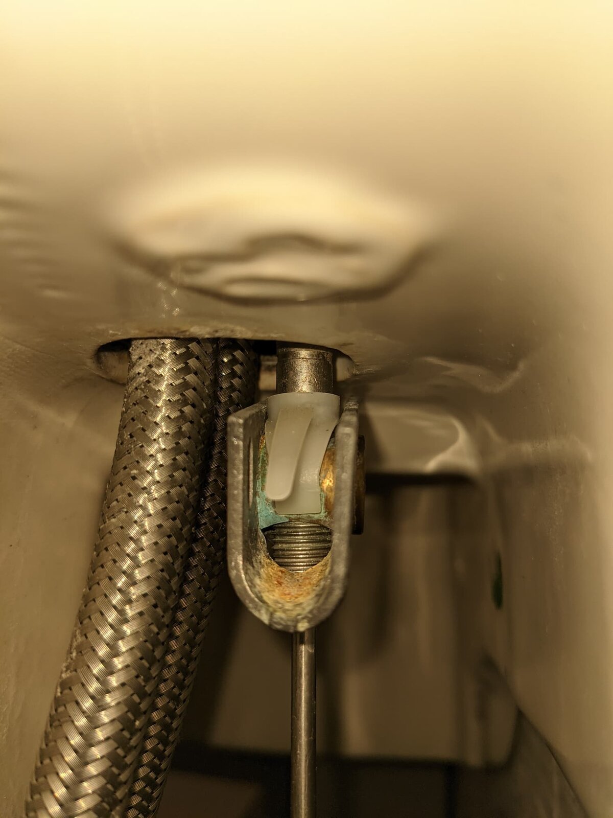

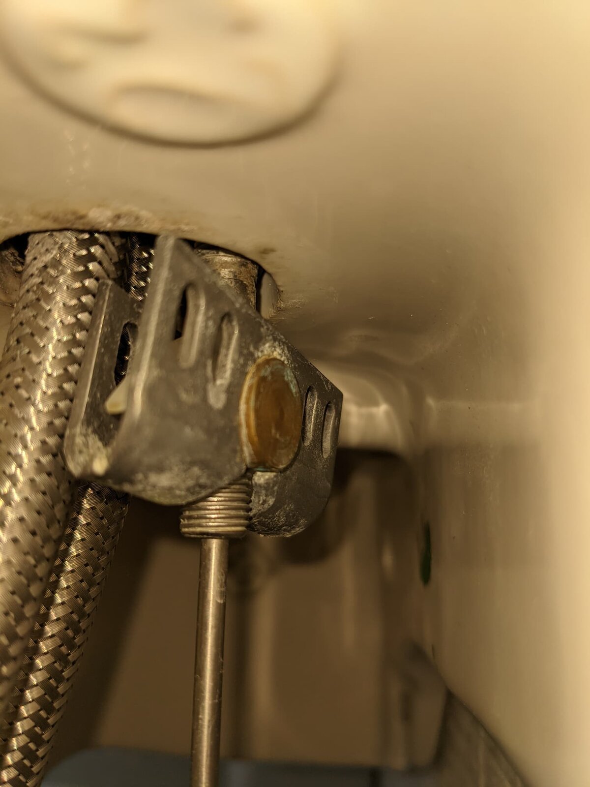

I've got a mixer tap in a basin that's super loose and I'm trying to work out how to tighten it. But this is all I can see underneath, any ideas what this thing is and why it's (presumably) blocking access to a nut concealed in the cavity above that I need to tighten?

...or is it sledgehammer time?

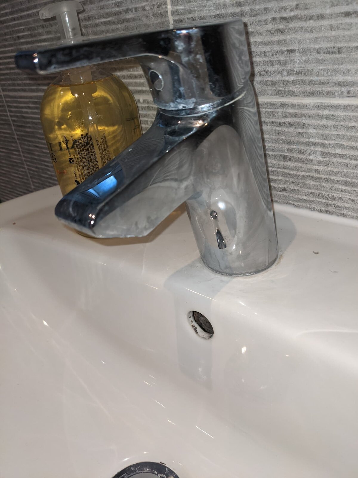

Sure, here it is from above. Looks like a regular mixer tap to me.
Is there a tiny grub screw ,low down ,on the tap body ? Maybe at the back and not so easy to see ?
Nope, nothing at all!
By all accounts it looks like a traditional fitting, and this is confirmed by other similar Ideal Standard technical docs I've seen. But no idea how to get a tool past that thing in my first picture! Maybe the white plastic wings do something?
I can't see how that can be tightened from below. There is a rod running thru the bolt ,is that for pop up waste operation ?
It is " similiar" to a tap I have seen before ,that needed a long Allen key introduced from the top of the tap ( after the rod is removed)

Is it possible there's a hexagon hole in the bottom of the threaded part, so it can be tightened from below with an ordinary Allen key? (anticlockwise to tighten). After removing pop up waste rod.

Thanks both - this was it! Removed rod, inserted 5mm hex, tightened up like a dream.
