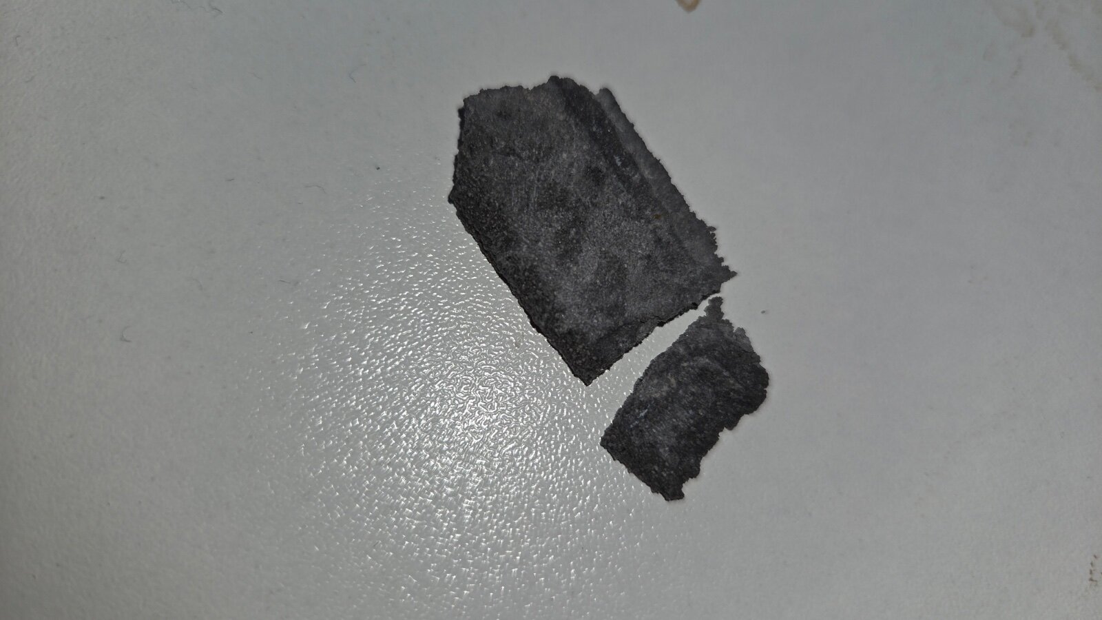

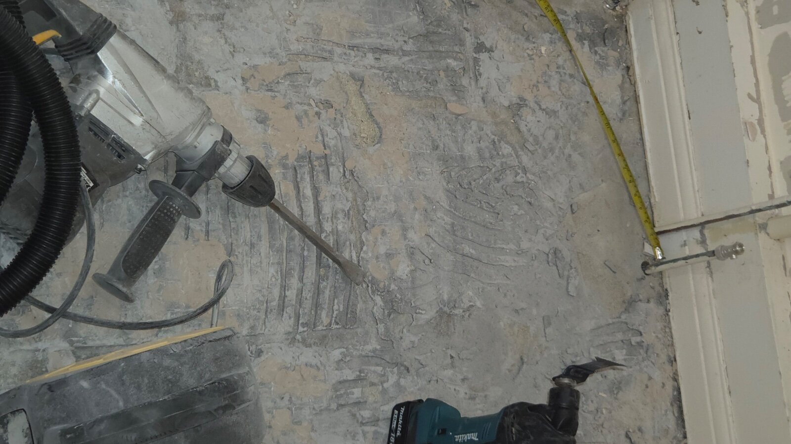

I've lifted a load of tiles put in by previous tenants in my bathroom thats got about 4sqm coverage.
They've put the adhesive on top of chipboard and I'm trying to remove the adhesive.
Is this some sort of levelling screed put down? It's turning rubbery when I've clear a bit with a multi.
Some of the tiles I just couldn't get up and separate from this adhesive, it's horrendous. I want to see whether I can at least find the joist/nail line to remove these boards.
Tried a diamond multi blade but it seems to just struggle and less effective than a Wood/Plastic normal Multi blade....Also I have an SDS scraper arriving tomorrow, not sure this is going to work either.
Does anyone have any other options???

Rip the chipboard flooring up and replace
A cheap concrete grinder might help
I have one, it is OK, not brilliant but more than adequate given the price point. That said it will probably clog once it is hits the bituminous(?) product.
Alternatively, a multitool scraper might be able to get under the cement based adhesive.
I have seen the AG as a Sander option, just means spending another 40 quid to work out if it'll work.
I might buy a cheap vacumm attachment and disc and see how that goes.

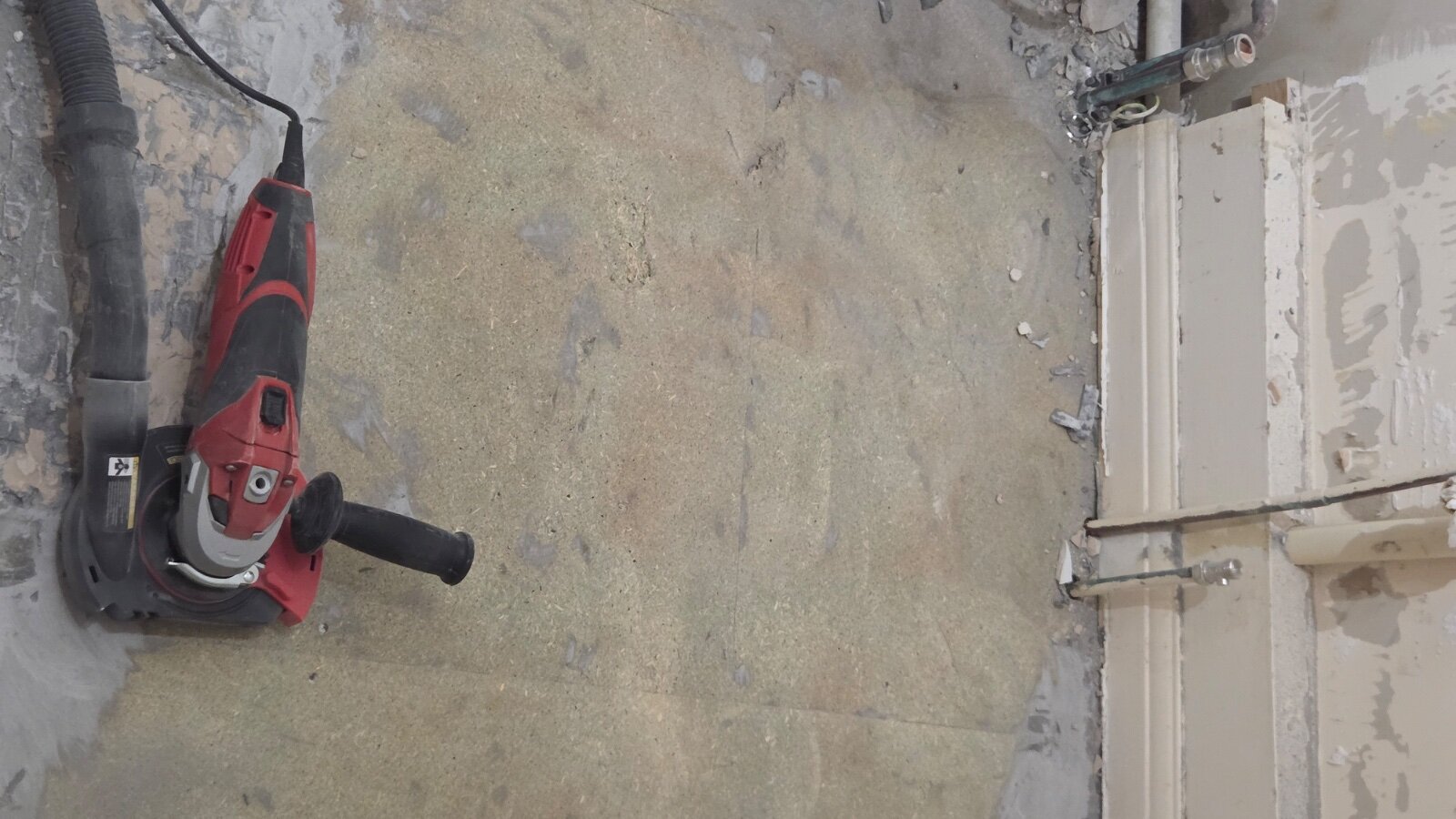

Yes as you grind through the adhesive, you will hit the chipboard, but the grinding cup will not sucessfully burn through the chipboard. Best case scenario, it will slightly burn/char the chipboard.
I've ordered an AG vacuum guard and disc to do the AG option if the SDS scraper dosn't work.

This has worked but it's been rather tedious but satisfying, I did this much in about an hour or so.
First issue was I'd not got the washer on provided in the herzo kit so it wasn't getting enough depth but that bit now works.
Plus side of this is I'm not full of dust.
The SDS Scraper on my Titan 6kg wasn't easy and kept going into the chipboard taking lumps out.
Floor seems to be flat/ish after removal with the AG.

Have you got a link for that please I made a hom made one and that alone made a massive difference when I used a concrete grinding disk on an angle grinder. I also made a DIY vortex dust collector that saved my DIY hover from dust abuse which also worked very well.
