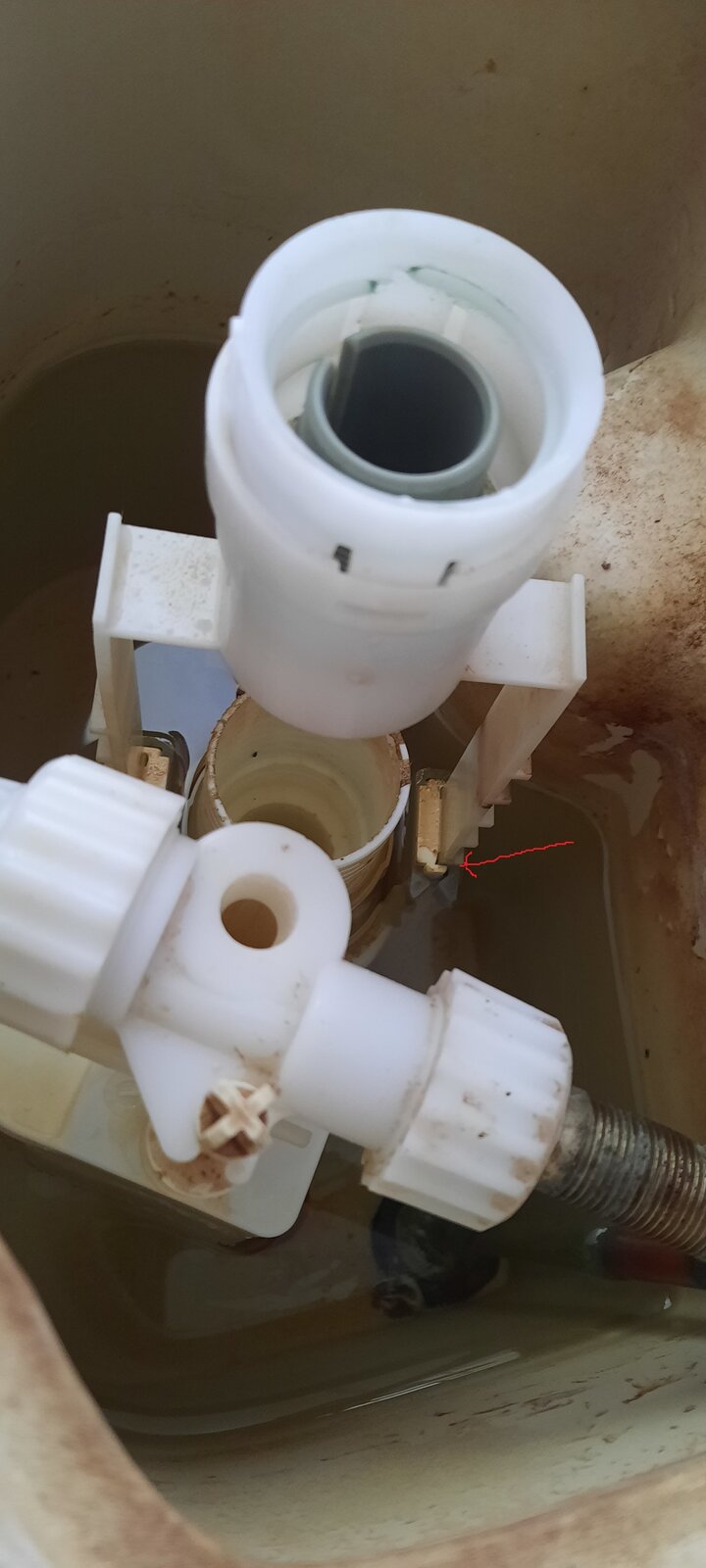

I had a leak on the inlet valve, which I replaced.
When I put it back together you can see in pic1 the buttons arnt flush. It will flush pushing both buttons.
So it looks like Ive moved something.
Looking at pic2a where I have put an arrow, it looks like this might be the place to adjust.
I have tried gently but cant move it.
Is this where I should be adjusting, dont wont to break it.
Thanks for reading.

Simple
When you know the make.
It took a while SIAMP Skipper.
In pic 2a adjust the grey part at the top.
It was obviously turning when I was put the push button back on.
This may help others
