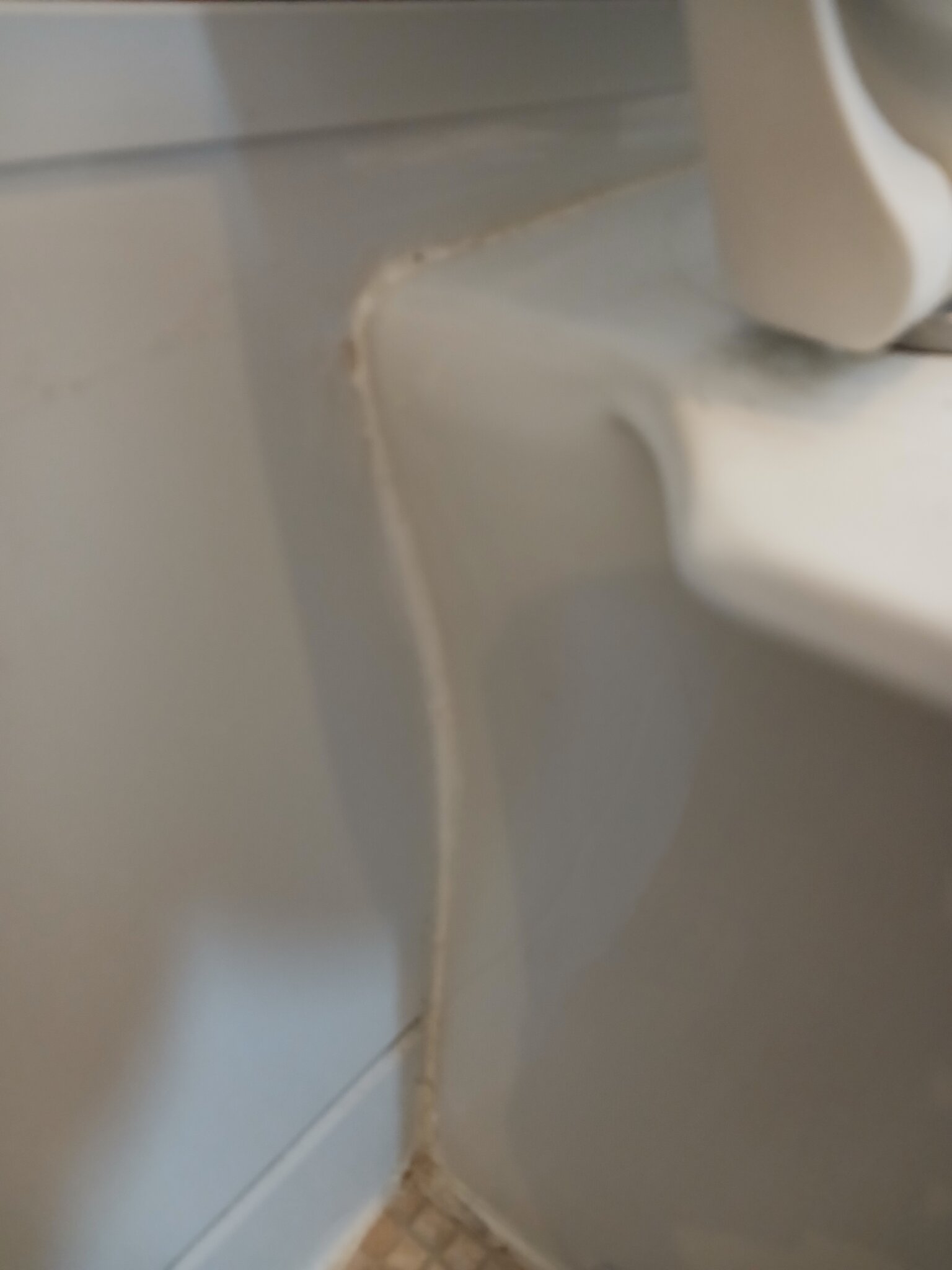

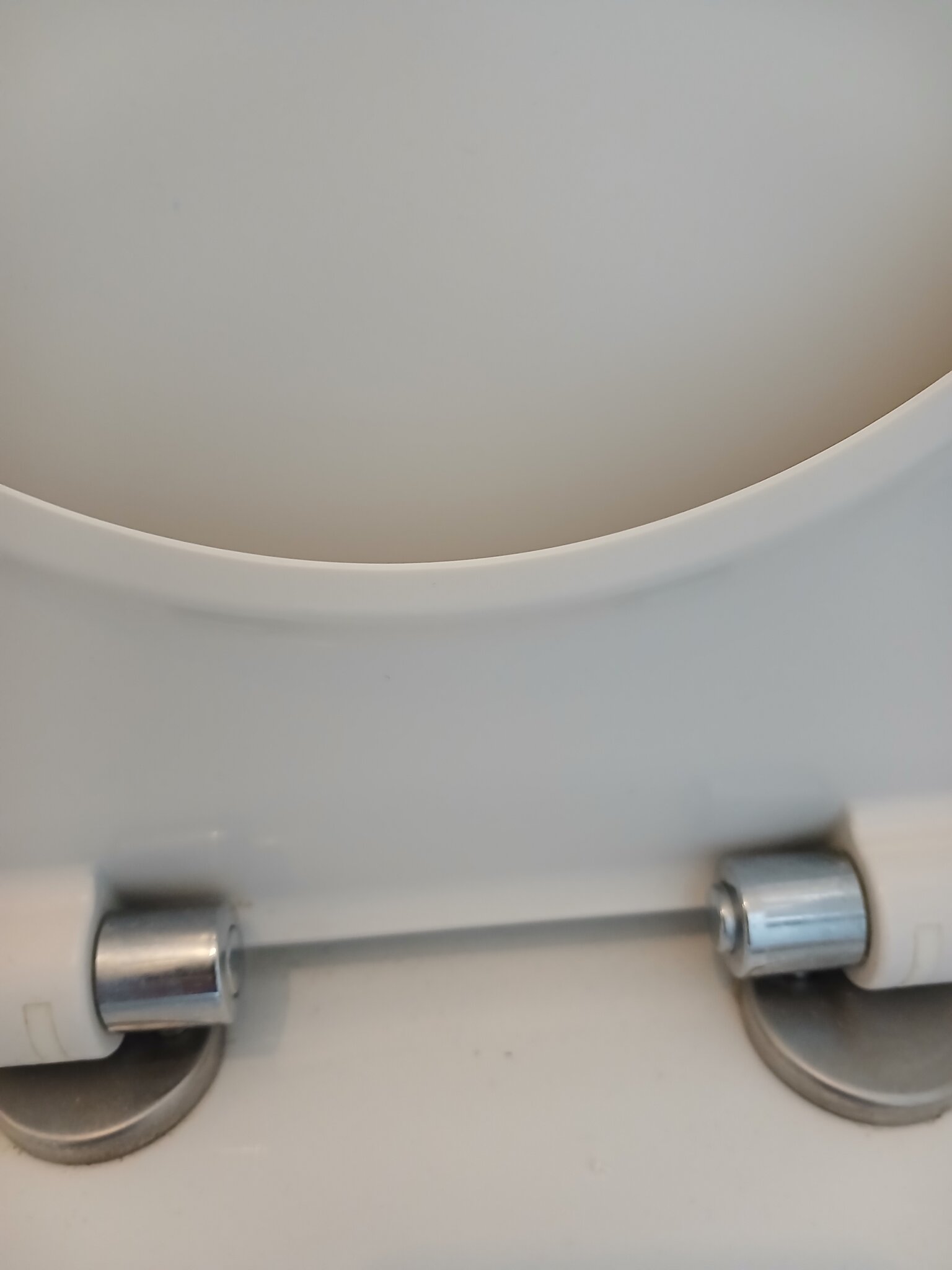

I seem to have yet another variation on toilet seat fixings. I only wish to adjust it as has moved a little since fitting and the plumber left no instructions.
I believe it lifts off the posts but I'm not sure. It appears to have pushbuttons each side. In the photo, one is in the other out. If I do lift the seat off its posts, how do I adjust the alignment ? Any advice appreciated.
Push buttons in, lift off toilet seat staight up, remove round cover plates and then you have access to the screws for adjustment.
Andy
Thanks, I guessed it was something like that but I didn't want to start dismantling it then not be able to get it back on.
Do the pushbuttons pop back out to secure the seat?
