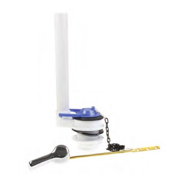

Does your valve look like this?

So can I examine the flapper with the water running and let any water go down the hole and into the bowl?
Sorry graykev, can't help with your flapper. I have the one I pictured and it intermittently fails to seat properly thereby allowing water to dribble into the pan. It's an easy fix for me but I have no clue about your flapper.

a Fluidmaster type is identical, and as the top part twists away from the base section, the new part reconnects by going in the opposite direction. (try it with the new one first, then all will become crystal - I promise.)

Yeah cheers I sorted it last night. I took the flapper unit out (by twisting as you mentioned) and when I removed the rubber seal it had an air/water bubble in it. I burst it and turned it over and it not leaking at all now :)
