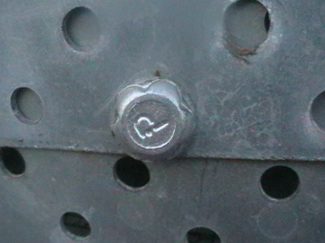

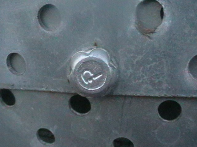

Greeting!
Attached photos of the sitex panels on the doors and windows that we need to remove
We have battery powered drills, but need the attachment

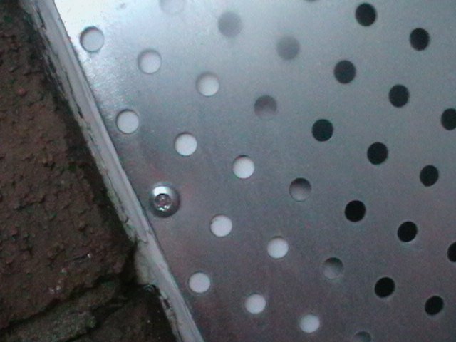

First picture by the looks of it you need an external torx socket, second picture you need an anti tamper torx bit

Your first picture might not even be a 6 sided torx, could be 5 sided, try taking photos with something better than a 1.3mp camera
I dont have another camera, but I guess I could go to the property and count them

I have had another look at it and the first photo is a 5 stud, are the female torque head not a 6?
The second one is a 6 head and looks like a T40
