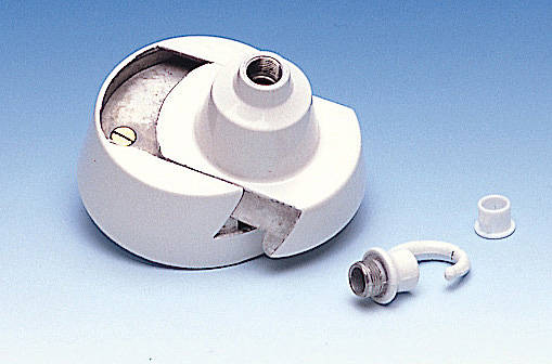

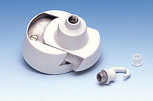

One of our contributors has this web page in my case I can unplug the light fitting and wire it on the floor, Ceiling rose.jpg but these are not that common.
