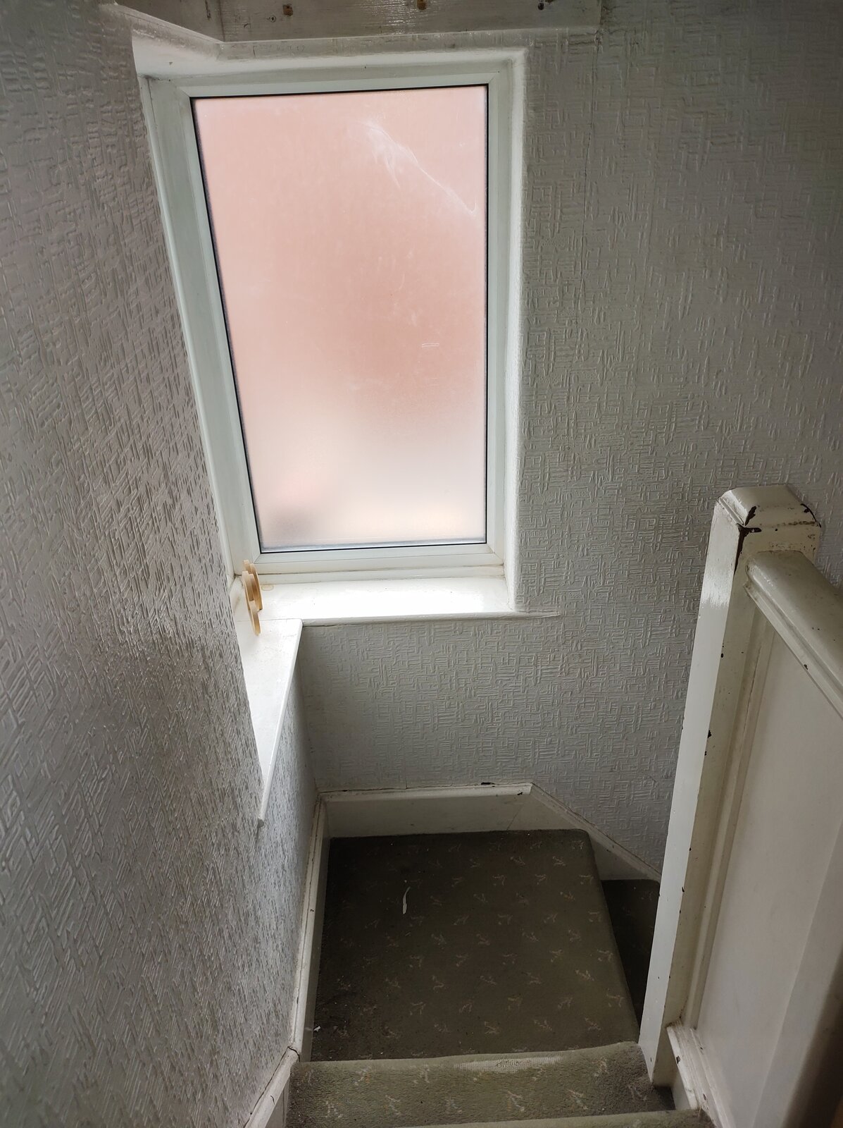

I'm replacing this window:
It is just over 800mm above the landing but the landing is only 730mm square, is there a minimum "area" in front of the window where you measure the floor from? It won't be 800mm above the first step. I suppose technically someone could take a nosedive from the step through the window.

As you say, possibly wise to toughen the one you face going down, not so much the one you face going up.
But I don't think the regulations actually cover it.

The extra cost for toughened glass for the window on the stairs is only going to be £20 max
Absolutely toughen it! It's not explicitly covered in the regs but they do stae about looking at ' risk ' and thats a risk
