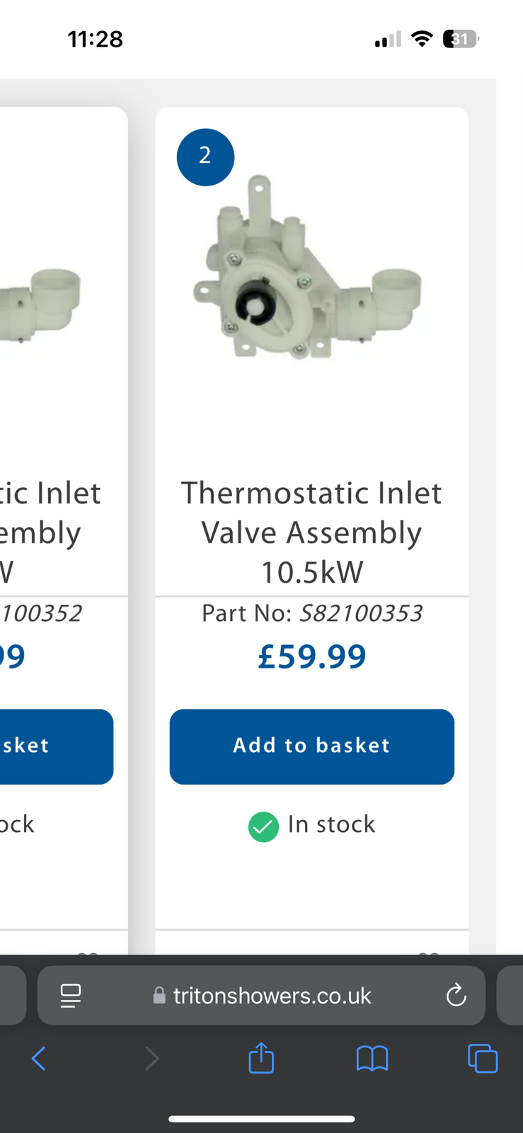

Triton T80 Easi-fit+ Thermostatic 10.5kW
My shower has gone from perfect to lukewarm overnight.
Both heating elements showing resistance, 10.4 Ohms and 12 Ohms
There’s some drop in flow between cold and hot but not huge. I honestly couldn’t tell you if less difference than when it was working or not.
Is it possible it’s the thermostatic control valve? Part No S82100353
It’s barely out of warranty but if needs must I’ll get a new one as it’s my only shower and lukewarm is torture at this time of year.
If I replace it I can’t help thinking I’d rather have Mira but it needs to be a multi fit as water and power both rear/right hand entry and no room to move shower sideways for a left fit. Would prefer thermostatic.
I’d rather repair this if possible but would Mira be a better replacement if I can shoehorn one in or stick with another Triton?

Sounds like this points back to the flow control valve I pasted in my original post. I’ve turned it stop to stop several times but nothing improves, I guess it’s knackered.
Before doing anything more, ensure power off at pull cord, remove the cover, you will be able to see where the start/stop "button" is inside, with care, restore power with the pull cord and start the shower, turn the stabiliser valve with your fingers fully hot then fully cold to see if it works, if so reposition the cover as shown in attachment.

I’d done that and tested the heater elements as per original post - thanks anyway.
I’ve ordered the new valve, fingers crossed that resolves it.

Changed the thermostatic control valve today.
The moment I turned the shower on the reduced flow was evident.
It’s working perfectly.
Not a difficult job. These showers are quite modular and it’s all push fit internals.
