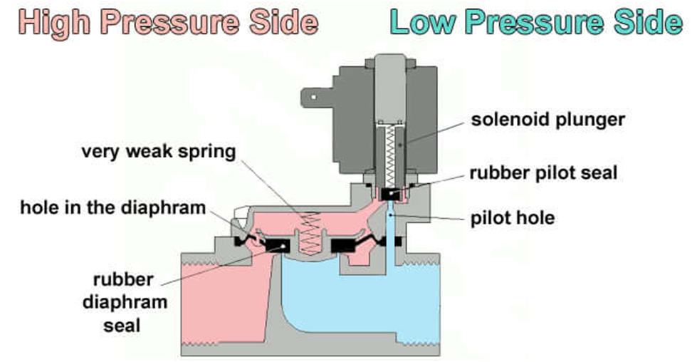

For interest, below shows a typical diaphragm type solenoid valve like the Triton uses.

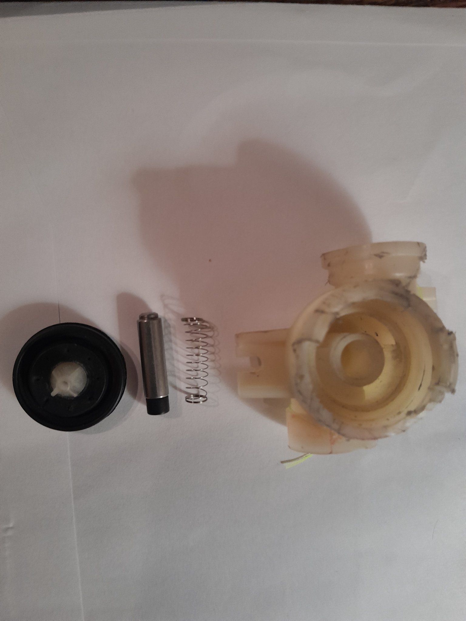

Here are the the butchered remains of the old Sol.Valve, had to cut the top off to get some idea of what it looked like. Not 100% sure how it operates, normally the plunger bleeds the water off to the outlet when the valve is energized but this one is right in the centre so in communication with the inlet side (bottom), however there are 8 tiny holes radially on top of the diaphragm which I think do communicate to the outlet. Anyway the new one works fine.
The Link here is probably a reasonable description of how these centre fed (from Inlet) pilot operated Sol.valves work.

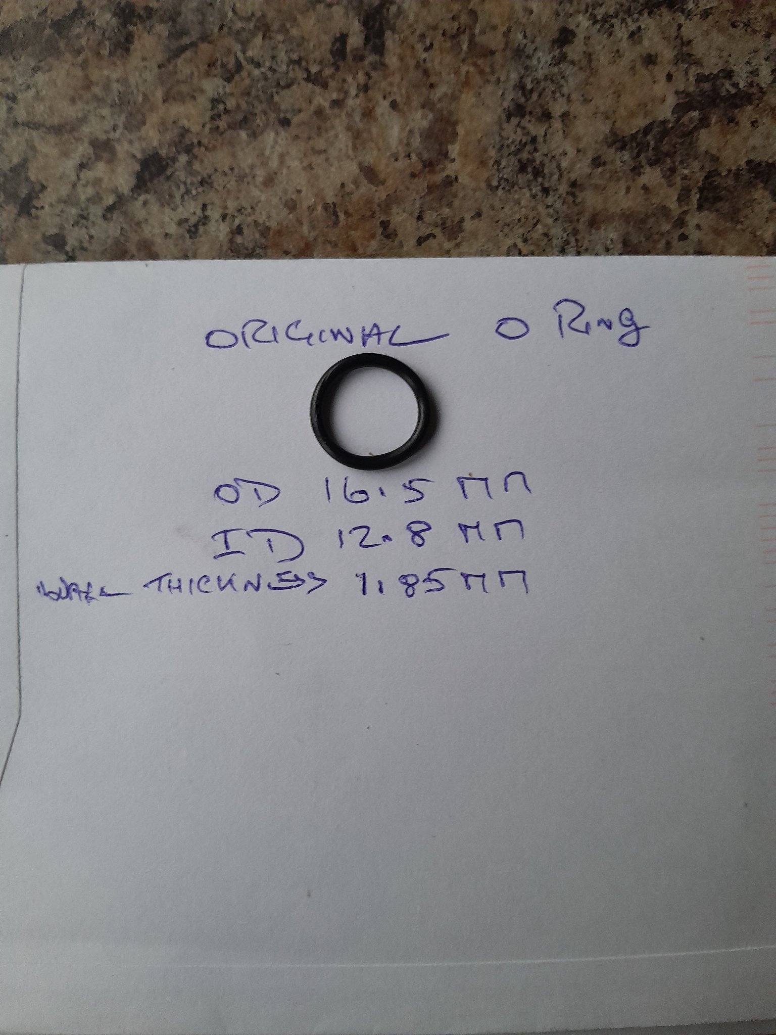

Here are the (now) dimensions (vernier calipers) of the original bottom O ring that leaked.
Apparently standard sized 12.8mm ID X 1.8mm (16.4mm OD X 12.8mm ID) are available.
