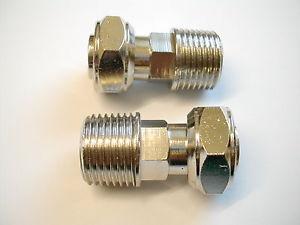

I'm currently in the process of going through the house repainting my radiators and fitting new TRVs. It's all gone quite well so far until I ran into a problem with one of them.
The new TRVs all come with tails to screw into the radiators and so I've been taking the old ones out and replacing them, but one of them just won't budge. I've twisted so hard on it with a spanner that the edges have become rounded and so I can only attack it with a set of footprints, but still no movement.

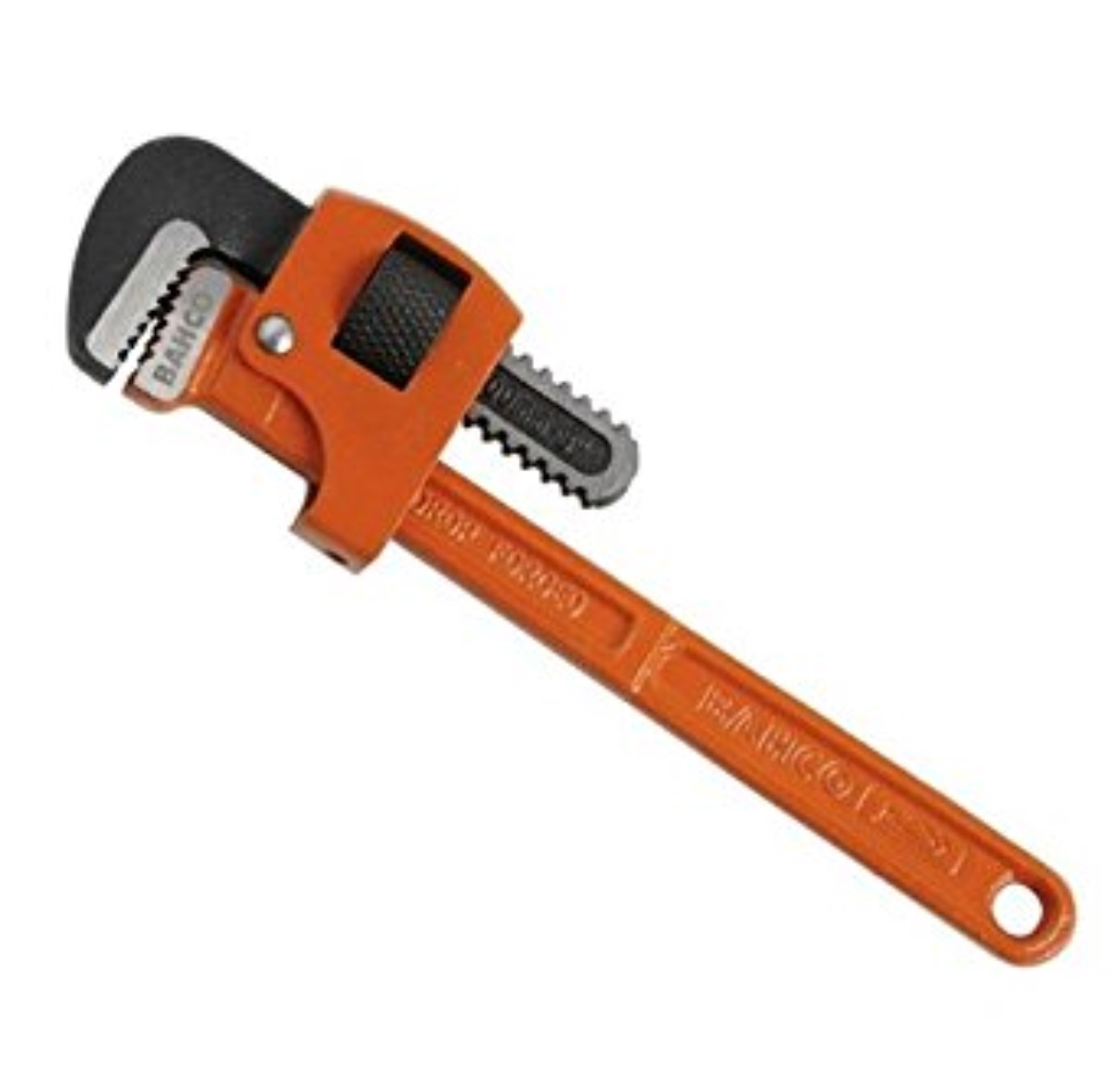

Stillsons.
Is the radiator aluminium? Some of these have left hand threads on one side.
If standard steel, then as nitro23456 suggests.
Slide a bit of copper pipe over the aforementioned spanner to give more purchase/leverage if necessary.
