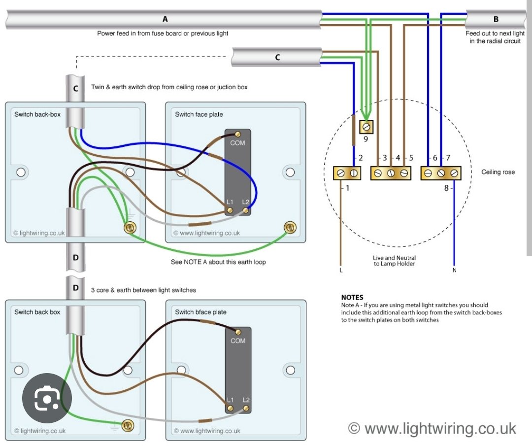

Two Way Lighting - Which way to do it?

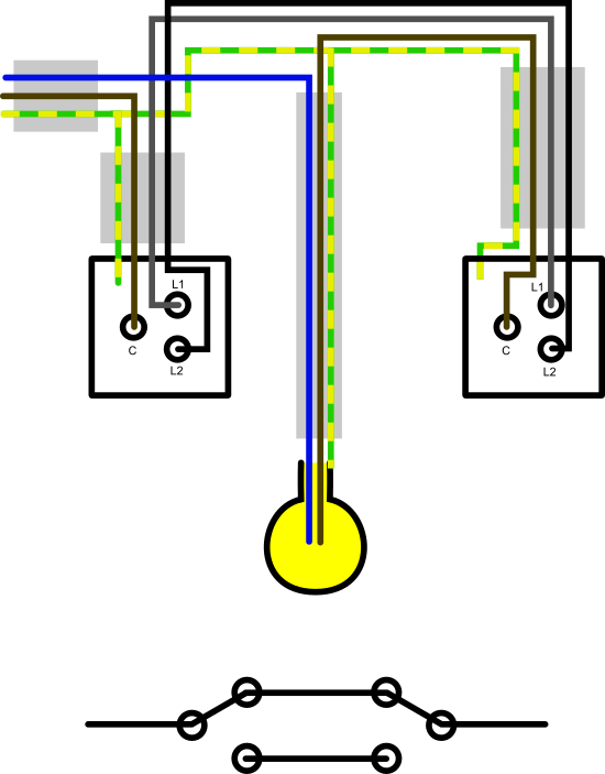

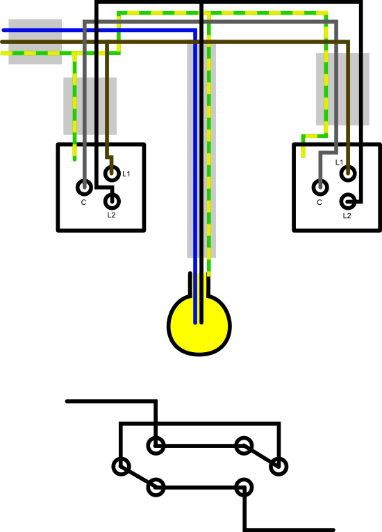

If I got you right on that one Pete isn`t tht the one I called version B ?
Yes correct but is 4 core & E readily available as such?
Single, Single & E, T & E or 3C & E are pretty common ad readily available but 4 core isnt? unless you using 5 core lex equiv to 4 cores plus an E conductor or 5 cores of SWA
Unless I missunderstand you.
Not exactly what we've been discussing but... TaDa 4C&E:

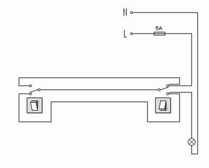

The borrowed neutral was always something that shouldn't be done done and just lazy really
It wasn't done deliberately when upstairs/downstairs lighting circuits were split.
I think it was but it didn't matter as much with re-wireable fuses....well for it to work but it was still dangerous.
The action which resulted in a shared neutral was of course deliberate, but what I meant was there was never any deliberate intent to create one.
I've known installations with a common neutral which were absolutely deliberate.
