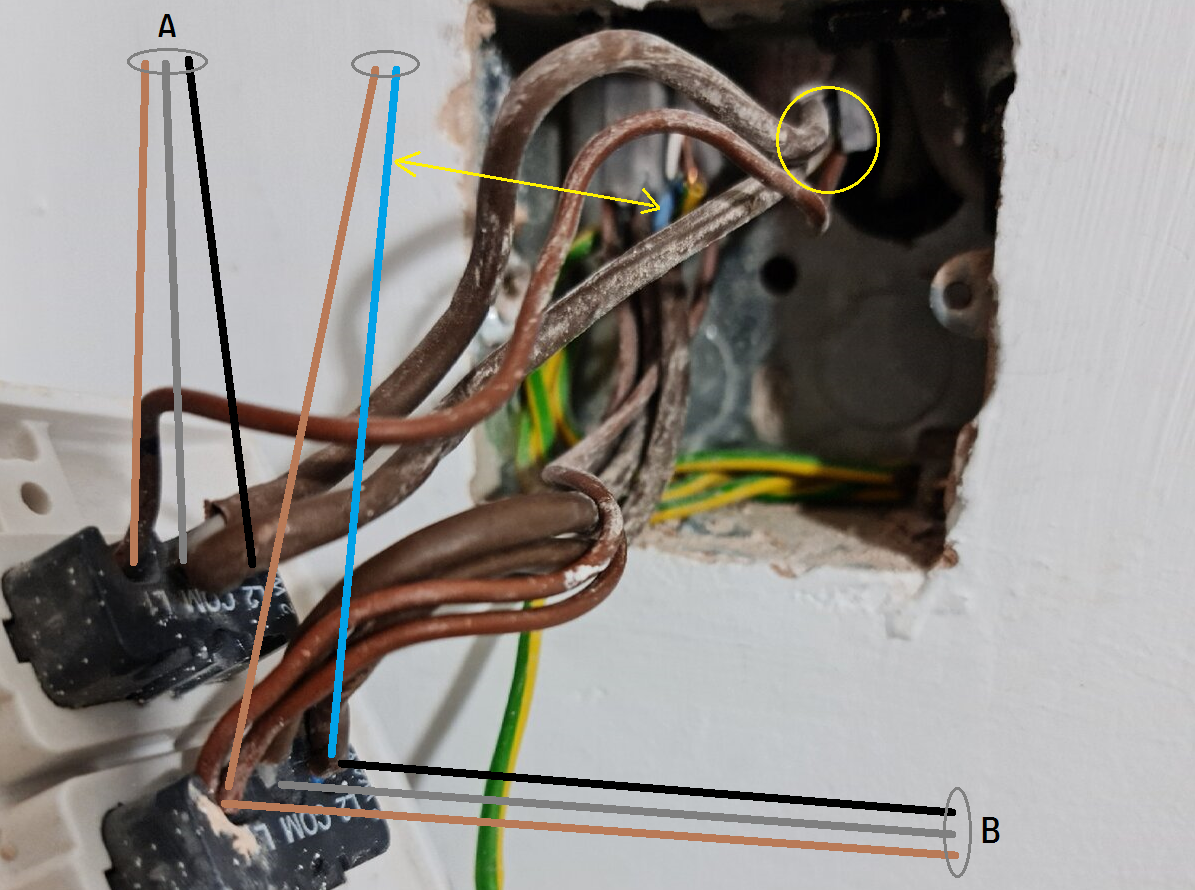

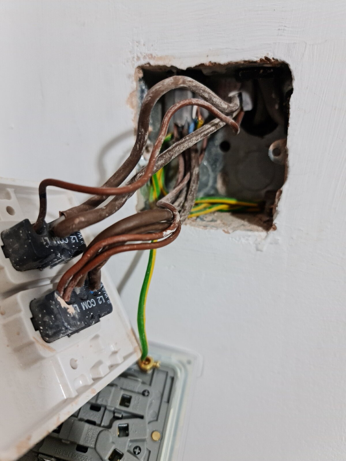

Here is a photo of the downstairs switch
When I first replaced the downstairs switch, I put little dots on each of the cables on the side of the switch that only has 3 wires. I don't think that they rewired that switch. I am guessing that they only loosened the screws to make sure that it was wired "safely".

As the MCB trips, unless they have done something really stupid, it must be because a screw has squashed a wire against the back box or earth wire.
There are no Neutrals present to cause a short.
This is what you have and looks correct.
The top switch in the picture is not 100% clear so, first make sure I have got the colours in the correct terminals.
At the upstairs switch, you should have what looks the same but will actually be reversed, with A and B swapped.
I suspect they have got the Brown, Black and Grey cables - that is cables A and B - the wrong way round.
You will have to determine at the upstairs switch which is A and which is B, then put A in the switch with the (presumably) Brown and Blue cable.
The cable with Brown and Blue must go in L1 and L2; it doesn't matter which way round; and the Grey of cable A must go in COM, and Brown and Black in L1 and L2; it doesn't matter which way round.
Then Cable B in the other switch on its own. Grey must go in COM and Brown and Black in L1 and L2; it doesn't matter which way round.
