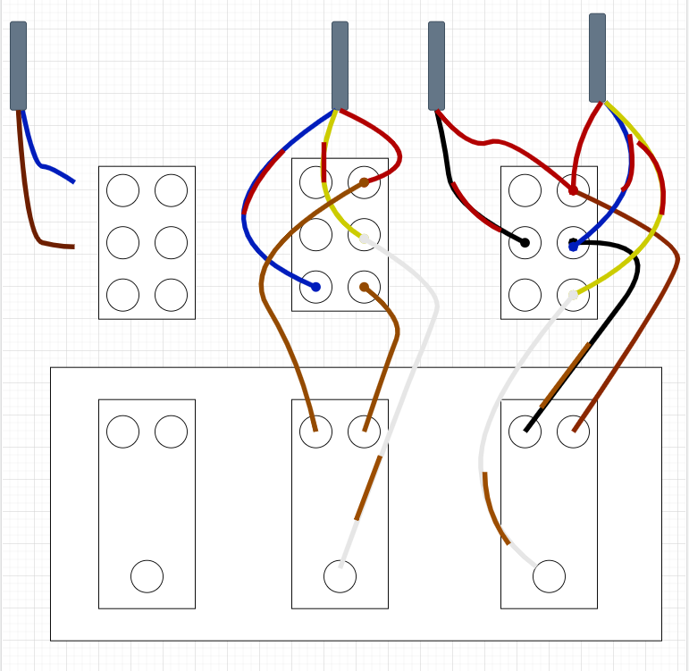

installed a new porch with 3 downlights and cabled wiring through to the hall way.
had an existing 2 gang switch controlling downstairs hall light and upstairs hall lights.
both ground floor and 1st floor lights have intermediate switches.
have replaced the 2 gang switch with a 3 gang switch and now need to wire in the new line from the new porch. The existing setup is now working but what's the recommendation here to wire in the new lights?

here is the current wiring:
I guess the three boxes at the bottom are the three switches? What are the blacks with 6 circles?

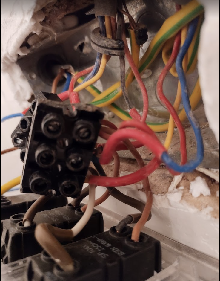

Really need an actual photo of the wiring. History shows that a schematic often doesn’t tell the actual situation, usually it’s the poster’s belief of what is there, and often there’s more to see. Thanks.
The boxes at the bottom are the three switches and the boxes with the 6 circles are the terminal strips
Blimey, what an unholy mess.
sorry to be negative but, as far as I can see you do not have a neutral in that switch box. This means that you cannot power your new lights from that switch box. You will need to run a neutral to the new lights, or to the switch.

1. The switch probably has power from two separate circuits. There is two way switching possibly from upstairs and downstairs lighting breakers. You’ll need to make sure you do not take a neutral from downstairs and a live from upstairs.

enerally, I do not know why the terminal blocks are need. While you are at it the whole thing needs sorting out.
