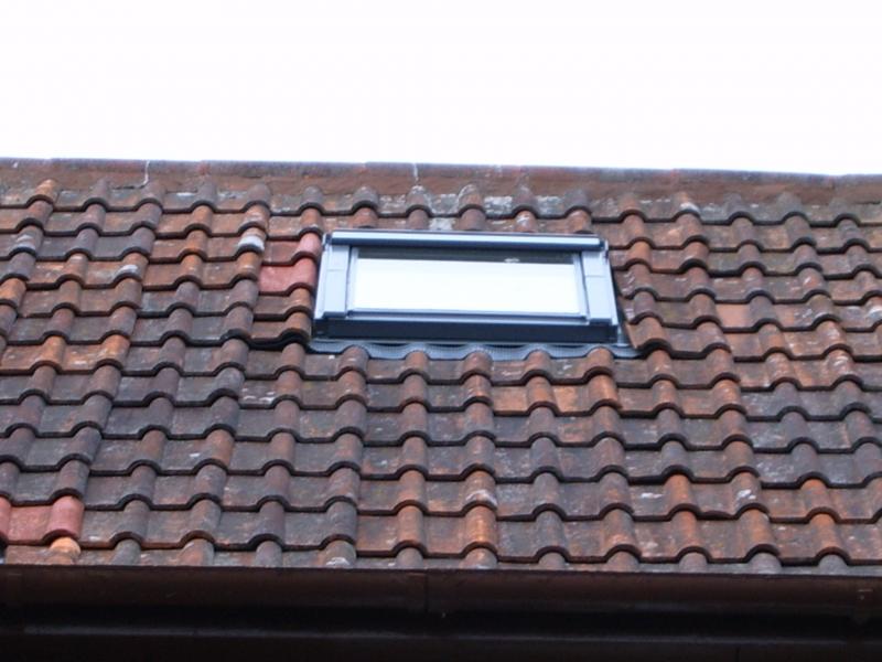

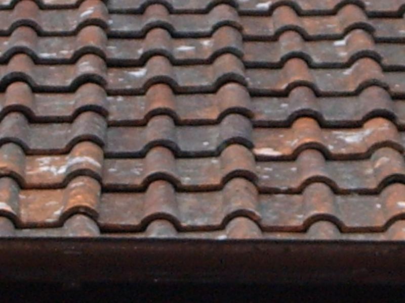

Type of Tiles
They are clay double roman tiles, you can get a universal vent from any Klober stockist, or a lead slate with a piece of pipe and mushroom on the top..these could be painted to blend in a bit better..
Most roofing merchants will get one made up for you out of the actual tiles on your roof, just take down a sample and they send them off and are back a couple of days later.
I would just like something setup so I didn't have to open the window up as the house lies to the SW an wi the prevailing wind it alway howls in there...
A roof vent on its own wont really do any good as you need some sort of extracter ie vent on roof and vent in ceiling/wall.To only put the vent on the roof will only aid air flow between felt and tiles not roof to attic.Hope this helps.
