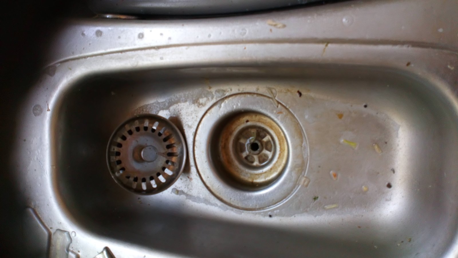

Unblocking this kitchen sink plughole
27 Nov 2016
224
:idea: thats your answer,try not to push the gunge further down your drainage system and consider a replacement house maid.
pic shows neglect :mrgreen:
Yeah I know I need to clean more
So wet and dry vac from top?
There are 2 nuts,1 disconnects the trap from the outlet pipe and the other is on the Ubend of the trap.
Remove Ubend and check it is clear, no harm on wet vac on outlet pipe either whilst you are at it.
