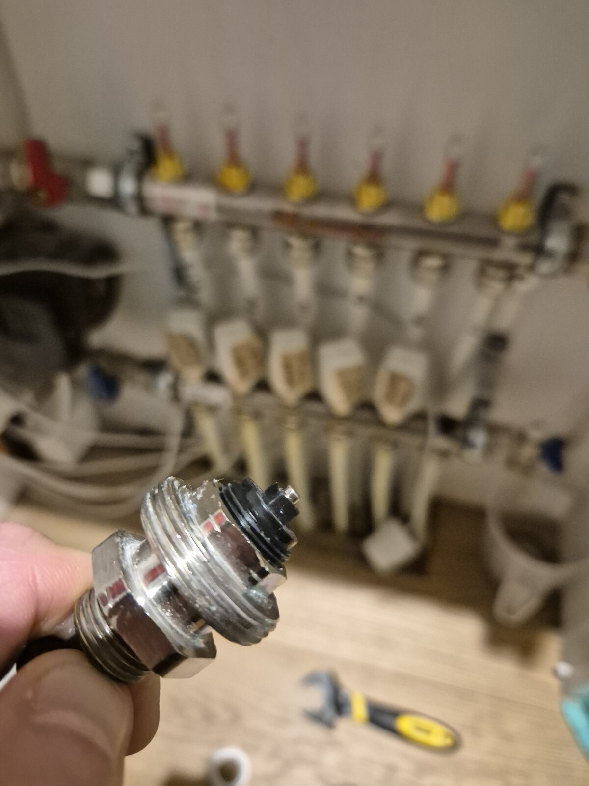

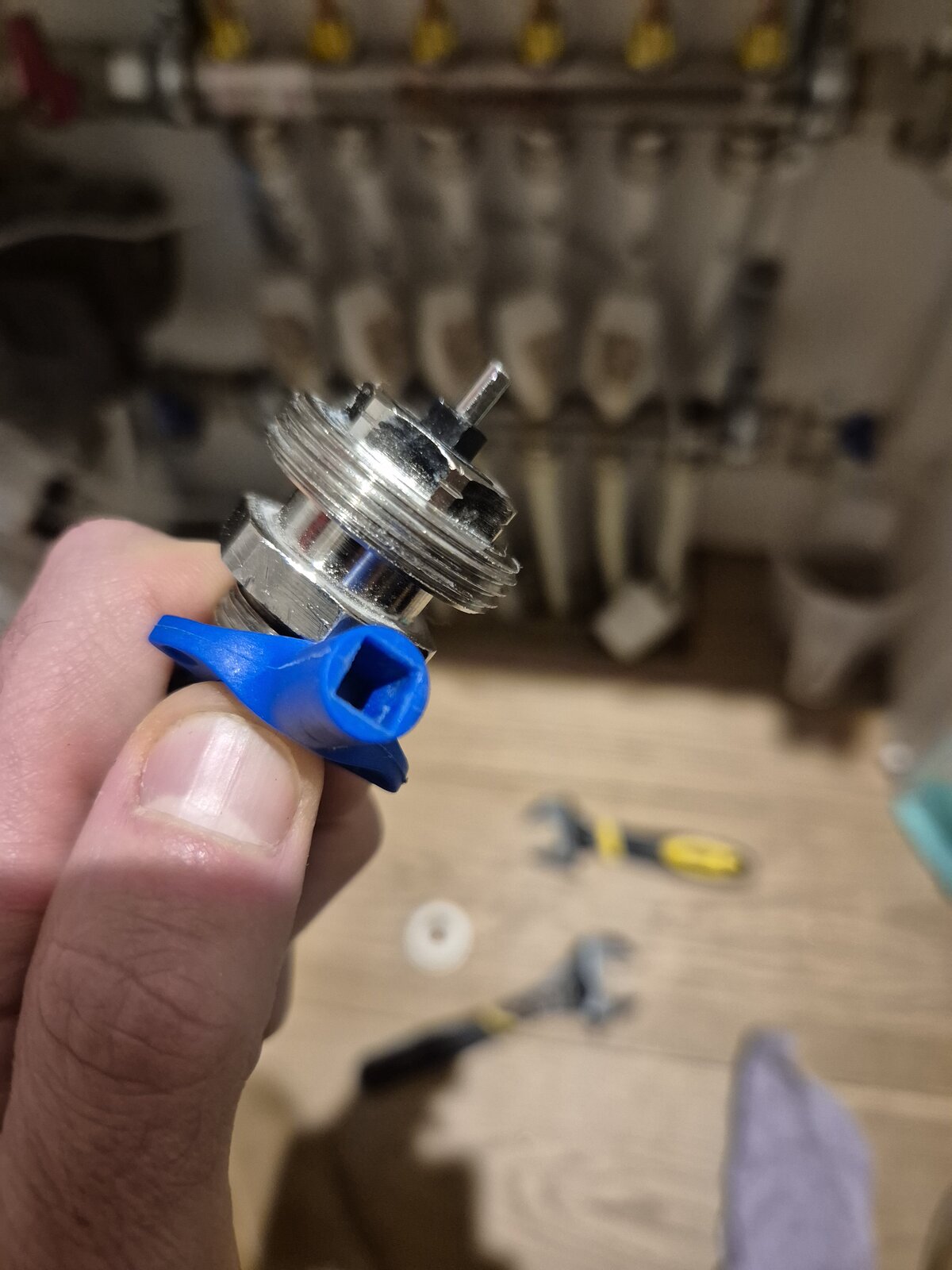

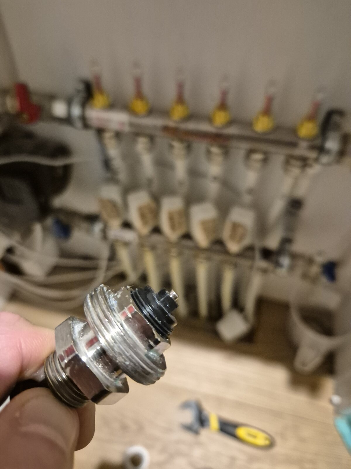

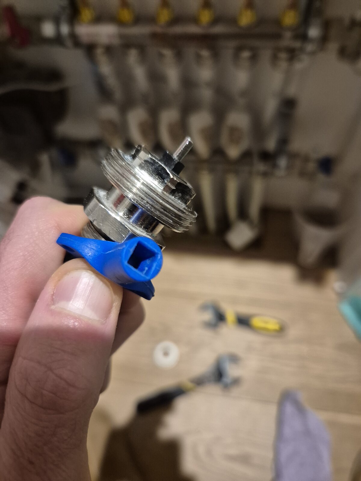

Removing actuators usually causes the valve pins to rise up = to close the valve in most UFH manifolds. The opposite of TRVs where the pin is pressed in to stop flow.
The Actuators should, via the expansion of a wax insert that is heated electrically, operate the pin valve on the return manifold ... that moves from closed (no flow) to fully open slowly... it takes many seconds (minutes) to move the required mm or two.
If there is flow in a circuit (meter will show?) without the actuator calling then it's either mechanically stuck in the open (or part open) position or has (somehow) been mis-adjusted to effect the same. I believe the flow meters do something similar to adjust flow rate on the flow manifold side (in your install)?
Check the manifold flow meters!

I'm going to go zone by zone, valve by valve, flow meter by flow meter to see what happens when one is opened. But I seem to have a style of return pin valve that I can't see anywhere else (maybe what you were referring to about adjusting flow rate at the manifold?).
Pics attached - the pin itself doesn't seem to move on any of them. But they are threaded, and using a little plastic bleed piece, I can turn the pin so that it's fully exposed (no visible threads - assume that means valve closed?) or turned so that the threads "rise", with very little of the pin exposed (presumably valve open?). I THINK that when he came, these bits were all almost totally off (pin fully exposed), which he couldn't understand so opened them up almost fully).
Could it be something to do with these, such that having them now fully open means the actuators aren't doing anything and they're just permanently "on"?
