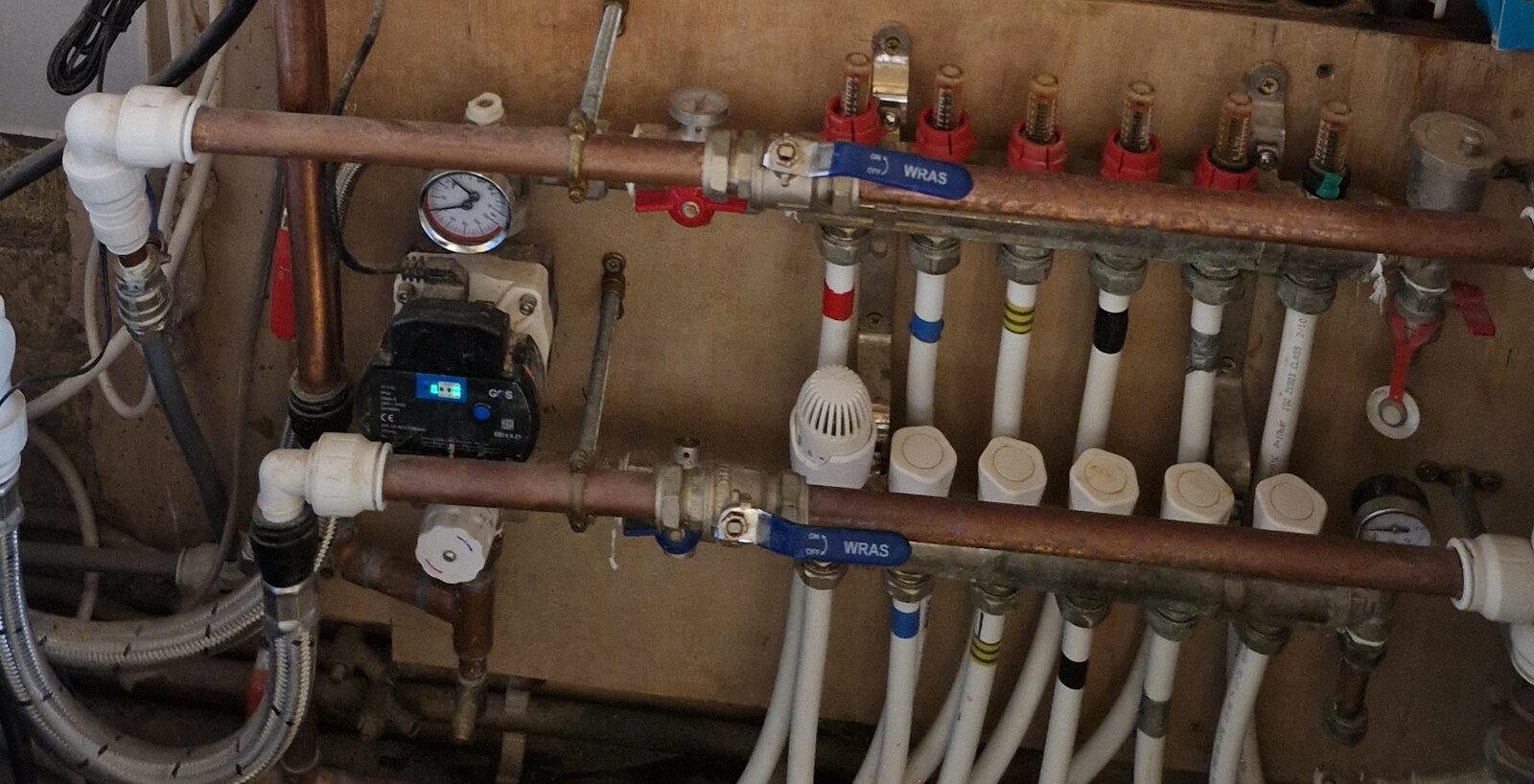

I have 6 circuits of underfloor heating on one manifold. The first 4 circuits are through a concrete slab the last 2 are under a suspended floor.
The first 4 are great, they warm up very quickly, the last 2 do not heat up much at all. In trying to diagnose the problem I have turned off the first 4 circuits at the actuator valves and left the last two circuits on, initially together and subsequently separately. After many hours the floor is barely noticeably warm.
I tried bleeding the system, only water came out.
Currently the system is controlled by one thermostat which turns everything on at the same time. I do intend to upgrade in future to control actuators to individual thermostats.
It doesn't make any sense that the circuits under the suspended floor are so radically different from the other circuits, I have been told that it has been fitted with trays and insulation correctly.
What other causes could there be? or tests I could do on the system?

The loops on return are cooler, I have been measuring the return and adjusting the flow to try and get it close to 7 degrees difference on all loops. The last two loops (covering the timber floor) have a difference of less than 10 degrees, when all the loops are on then the last loop has the lowest temperature going out, about 10 degrees lower than the hottest loop. I am considering investing in auto balancing actuator valves which will sort out some issues but I can't see it impacting the low floor temperature of the timber floor.
Ok, I think there has to be an understanding that the 2 different floor types will not react in the same way. The wooden suspended floor needs to be controlled separately and more heat fed to it as wood will act as a thermal insulator whereas concrete acts as a thermal conductor. That being the case the concrete slab will always react faster and feel warmer that the wooden floor.
Unfortunately the big mistake was the installer didn't know what they were doing setting it up on the same system. The problem is when retrofitting the suspended floor that the wood was retained, do you know if any PIR insulation etc was installed below the suspended floor or is it just the spreader plates? The best way to retrofit UFH into a suspended floor is sheet underneath, fill with PIR, lay the UFH pipework onto that and then top it with a biscuit screed, or then use the spreader plates, then a cementitious flooring goes on top of that.
You are now in a position whereby you are trying to balance the heat output in an UFH system when it is using 2 different types of flooring that performs completely different. If you keep them running on the same system you may find that it will be nigh on impossible to level them out. So it may be time to rethink.

To try and understand what you have, is it - 1x2port valve on flow > 22mm flow into a thermo blending valve > through into the pump and then into the manifold then 22mm return back to the main system? You say you have 1 stat controlling the whole manifold, so is that connected into a control centre or does that control the 2 port, if there is one?
The way I would look to approach it would be s - when looking to doing this, shut down the UFH in the loops that run through the screed, then try and bring the suspended flooring up to temp, that will tell you if the system can actually cope with that part of the UFH. If that succeeds then you can try and balance the screeded section.
You say you are getting in touch with the installer, when was this system put in and has the suspended area ever been warm enough?
Picture attached - although not a great angle and pipes in front of the manifold which are not part of the heating. Yes it is as you described.
1 stat controlling 2 port valve. No control centre (yet!)
