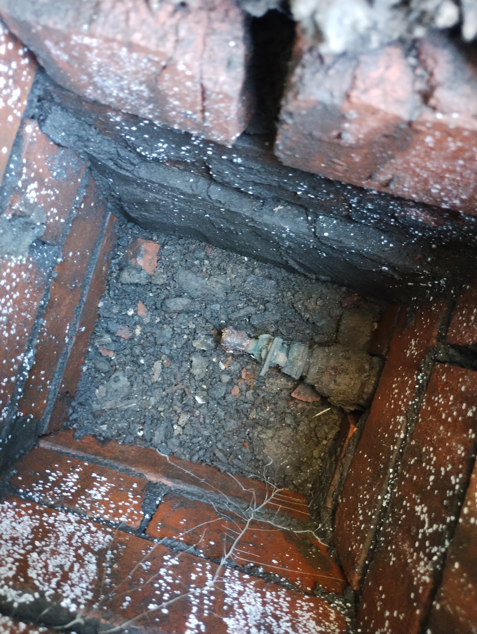

Unknown pipe by front door
5 May 2024
37
This pipe is under a metal lid next to front door. seems to be defunct. Plumber did not recognise. Gas box is elsewhere.
Any ideas what it is?

Looks like an old gas appliance tap on that pipe stub.

As above, it looks like a very old gas appliance stub, where a bit of rubber pipe was pushed onto the stub, leading to the appliance, with a tap to turn the gas on. Normally, I would expect to see one, indoors, adjacent to an appliance position, like an old gas fire. Why that is outdoors, I cannot even guess. Probably best to ask Transco or whoever, deals with gas pipes in your area, if it is live.
Is it on your propery or does your front door open on to a public pavement
Looks like it's possibly some sort of test point, but in my opinion you need get your supplier to check if it is live or dead and cap it off to prevent future confusion.
