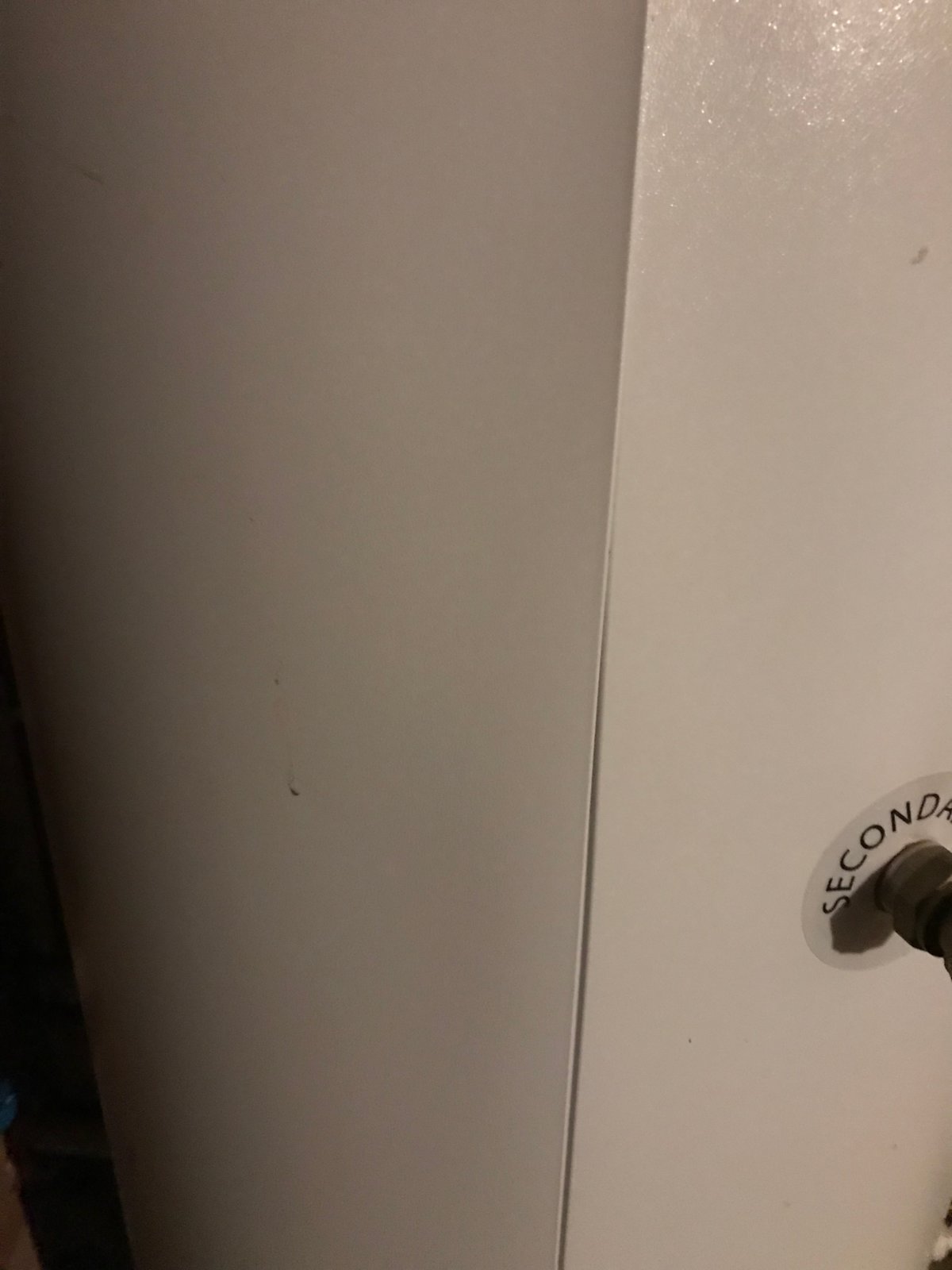

Hi Everyone,
I happened to pass my RM Cylinder Stelflow 210l Unvented Cylinder today and noticed that it was bulging slightly at the seam. Bulge may not be the right word - it's more of a slight curve. To be honest it might have always been like this.
I tried to take a picture of it but couldn't really pick up the curve, but you can see the seam has widened slightly.
It was serviced about 6 months ago by a G3 engineer and installed by a G3 engineer.
No change in performance in my system, no funny noises or anything.
Cause for concern?
As Dan says its just an outer casing, behind that casing is insulation then the actual cylinder, if it was leaking you would have water signs
