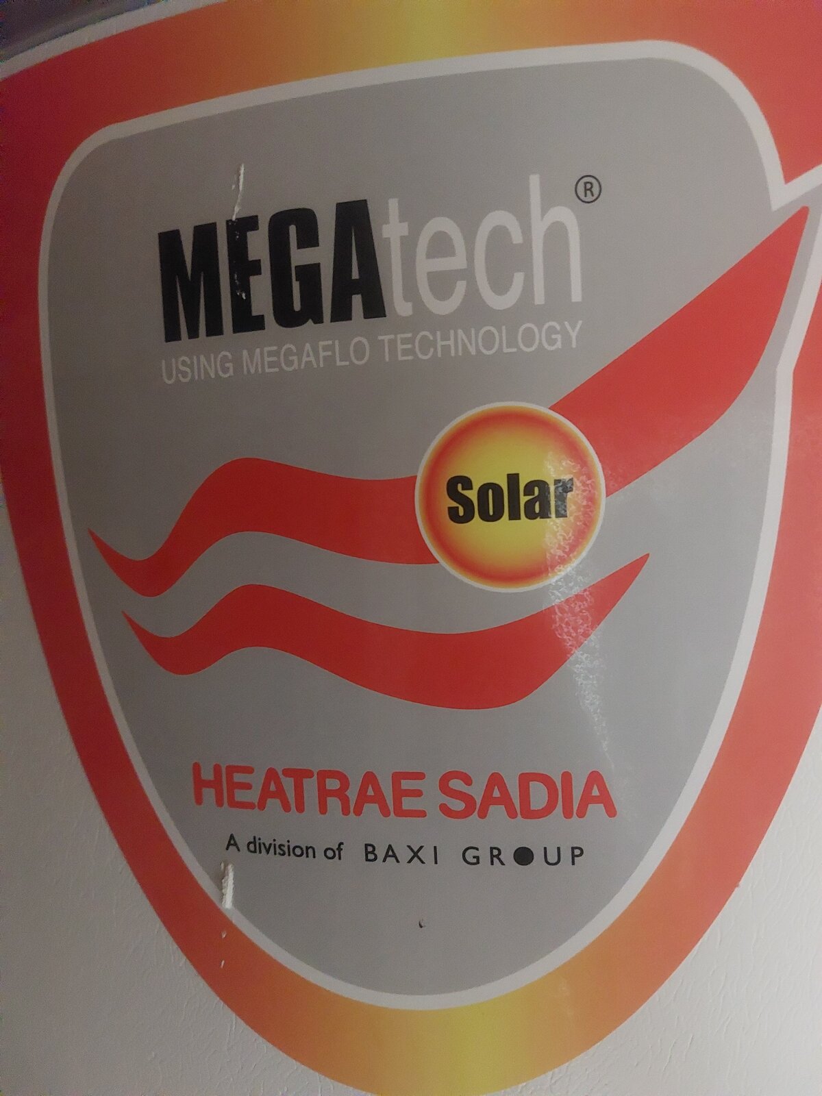

Perhaps @Madrab has been inadvertently misled by the OP's lack of attention...he quotes a Megatech in the post, but shows a photo of a Megaflo which, in all the cases I have seen, has an internal expansion space.

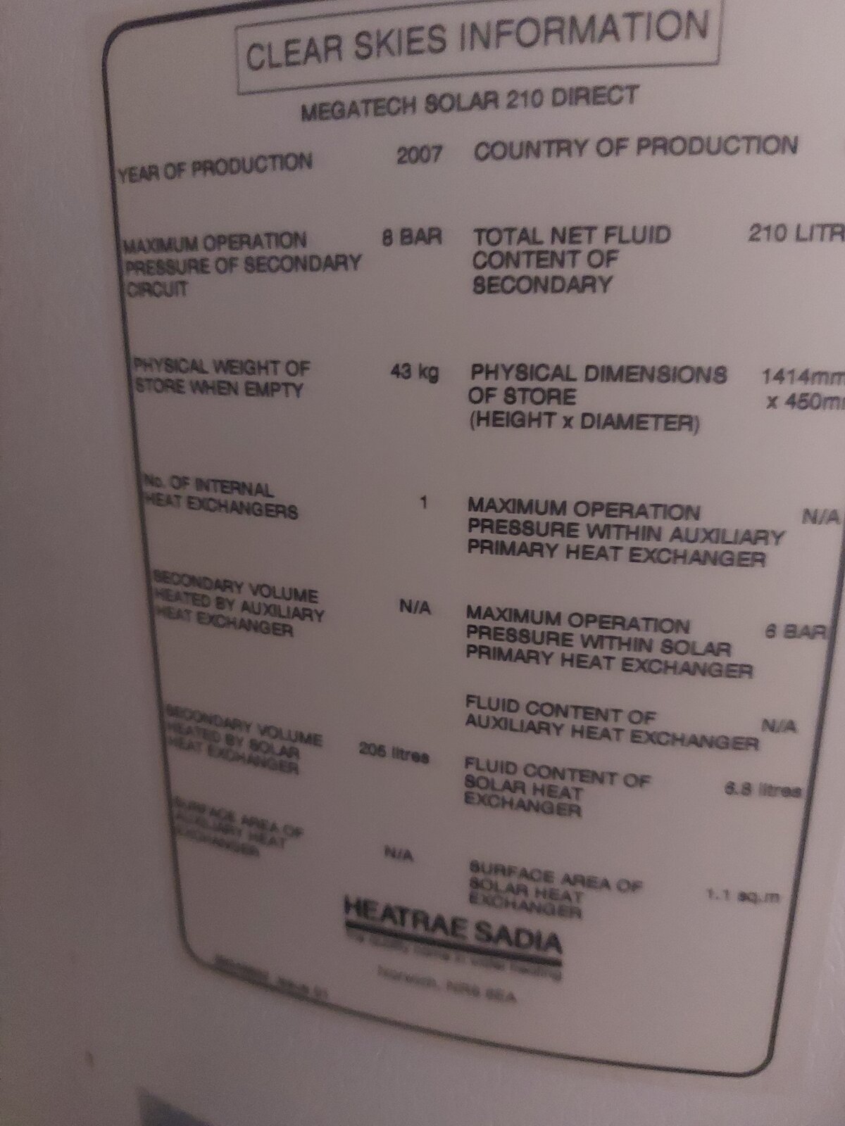

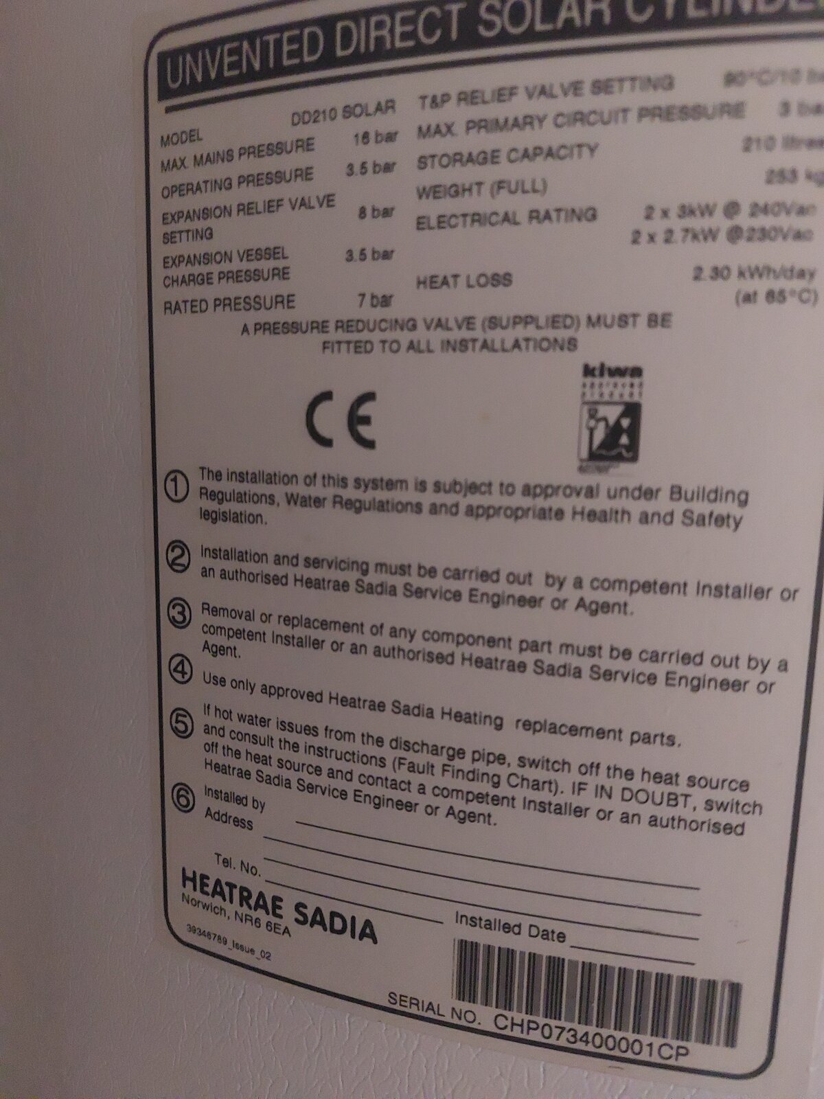

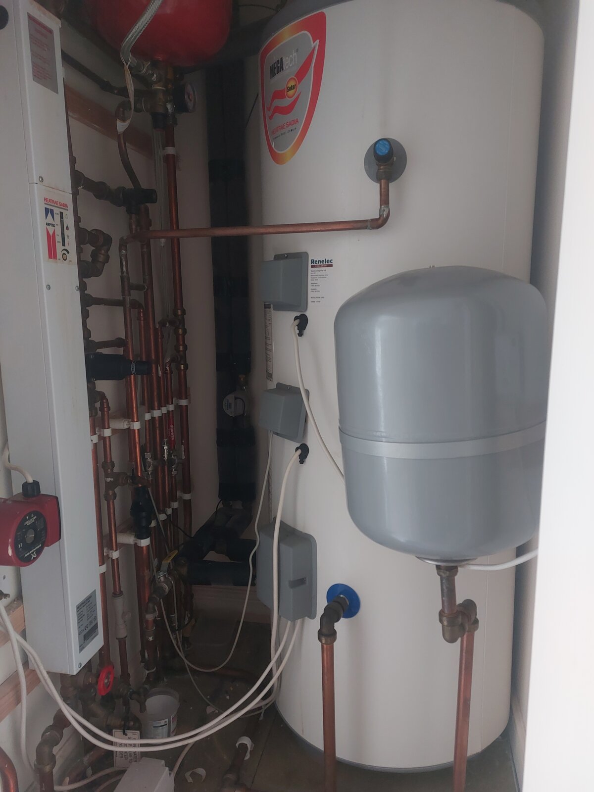

Here are some more pics to try and indicate what the cylinder is.

If the photo in your post #1 is yours with a expansion vessel adjacent and the outlet of that expansion vessel is teed into the cold water supply to the cylinder then there is NO air bubble (at least required). but the EV then requires attention.
This is indeed a Megaflo Megatech cylinder , my apologies to @Madrab.
There should be a separate grey or white expansion vessel on the cold water inlet pipework or inlet control set. This vessel will have a schraeder (car tyre) valve at the opposite end to the water connection.
1. Turn off the mains and open the hot tap as before.
2. Using a car or cycle pump, pump air into the expansion vessel to a pressure of 3.5 bar....whilst pumping you should see water issuing from the open hot tap.
3. Close the hot tap and re-open the cold mains.
4. Re-test as before with immersion heater.
If it didn't pass when under pressure but cold then the T&P seal is likely good.
I would think, looking at that EV position, that the whole cylinder has to be drained down, at least to below the bottom of the EV and precharged at the air end to 3bar, then refilled.

EV pre-charge - as per the units MI and on the side of the unit in pic 1 - 3.5bar. PRV as part of the control set is factory set to 3.5bar.

Yes, there is a grey cylinder on the side. I've plugged a bike pump in and the thing is totally flat. I did tentatively give the pump a squeeze to see what would happen, and sure enough, water came out the hot tap in the kitchen.
Yes, that's my cylinder cupboard. I've just recharged the air gap again, this time holding the PRV for a longer time. Oddly, after the gurgling has stopped completely, the tundish then starts to release a drippy stream of water and continues to do so. Ive stopped it for now by clicking the PRV closed, because this was going on for half an hour. There is no label on the cylinder with instructions with regard to recharging the air bubble.

Carry on then, pump up the EV to the 3.5 bar as stated on the data label.
There is probably no air bubble in the cylinder, hence the supply of the EV and the data sheet showing its pre-charge pressure.
THERE SHOULD NOT BE AN AIR BUBBLE in that cylinder !!!!!

Set the EV pressure right with hot tap open to release water in EV and all might come good.
Or not. The PRV may continue to let by and need replacing.
