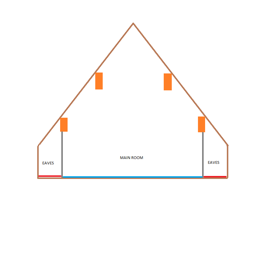

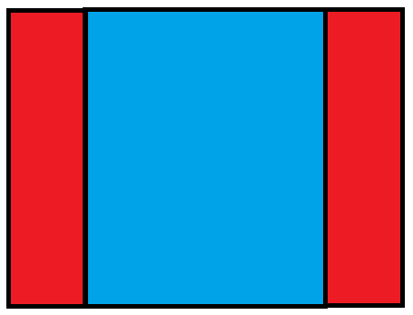

My house is a stone-slate roofed mid-terrace in 'uddersfield built around 1900. The attic was converted into a single room probably when the house was built or soon after.
The attic room is approx 5 metres front-to-back. There is an 'eaves' area at the front and back of the house (obviously either side of the room) that are both ~ 1.5m front-to-back.
My question is, say I wanted to make the room bigger by making the eaves areas smaller. What determines how small I can make the eaves / how big I can make the room?
See my 'paint special' attempt at showing what I mean.
The eaves are in red, the room in blue.

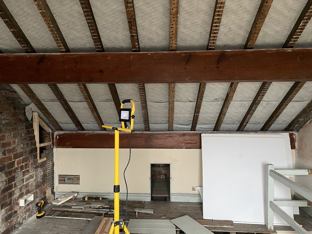

So what does the eaves area of a converted attic actually do? Is it just the space that's not been converted?
the large drawers sold as "pan drawers" for kitchens are really useful in the low positions.
