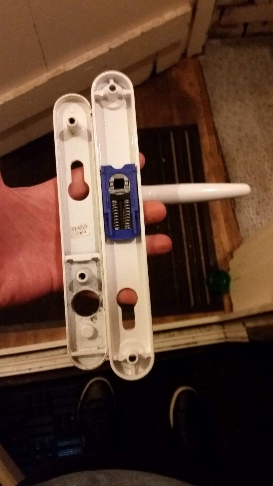

Hello all. Our back door handle needs replacing but im having a lot of trouble finding a handle that fits. I measured 120mm from screw hole to screw hole and 220mm overall length.
I went down to b&q and bough a 220mm long set of handles only to find when I got home that the don't fit whatsoever!
So you thought being a 220mm handle the screw holes would be 120mm.........nah pvc door handles don't work like that unfortunately, without knowing any of your other measurements and using my 150 years experience I would suggest a Hoppe atlanta handle would fit, it has 122mm hole centres, the top screw hole is below the lever not above and its a 92PZ
