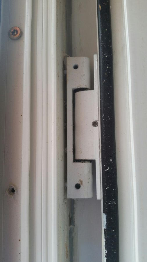

Hi
The top hinge on my shed door has come away from the frame (see attached pic)
What do I need to do to fix it?
If screws are needed what type?
Thanks for help.
Those hinges will be screwed into the metal reinforcing of the frame, Most likely with size 4 self drilling screws.
Screws with a larger thread will be needed, Probably a size 5 or 6 but with small countersunk heads.
Thanks Gazman. I will get some screws and give it a try.
