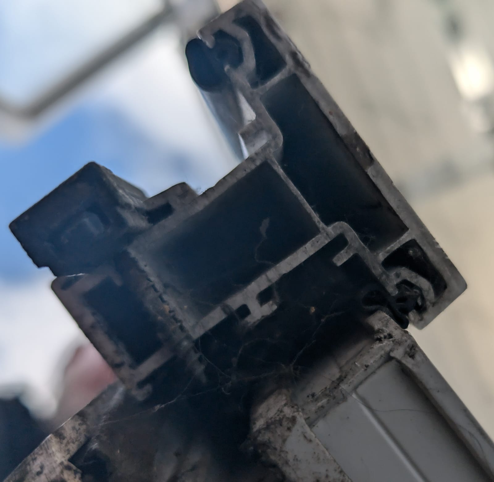

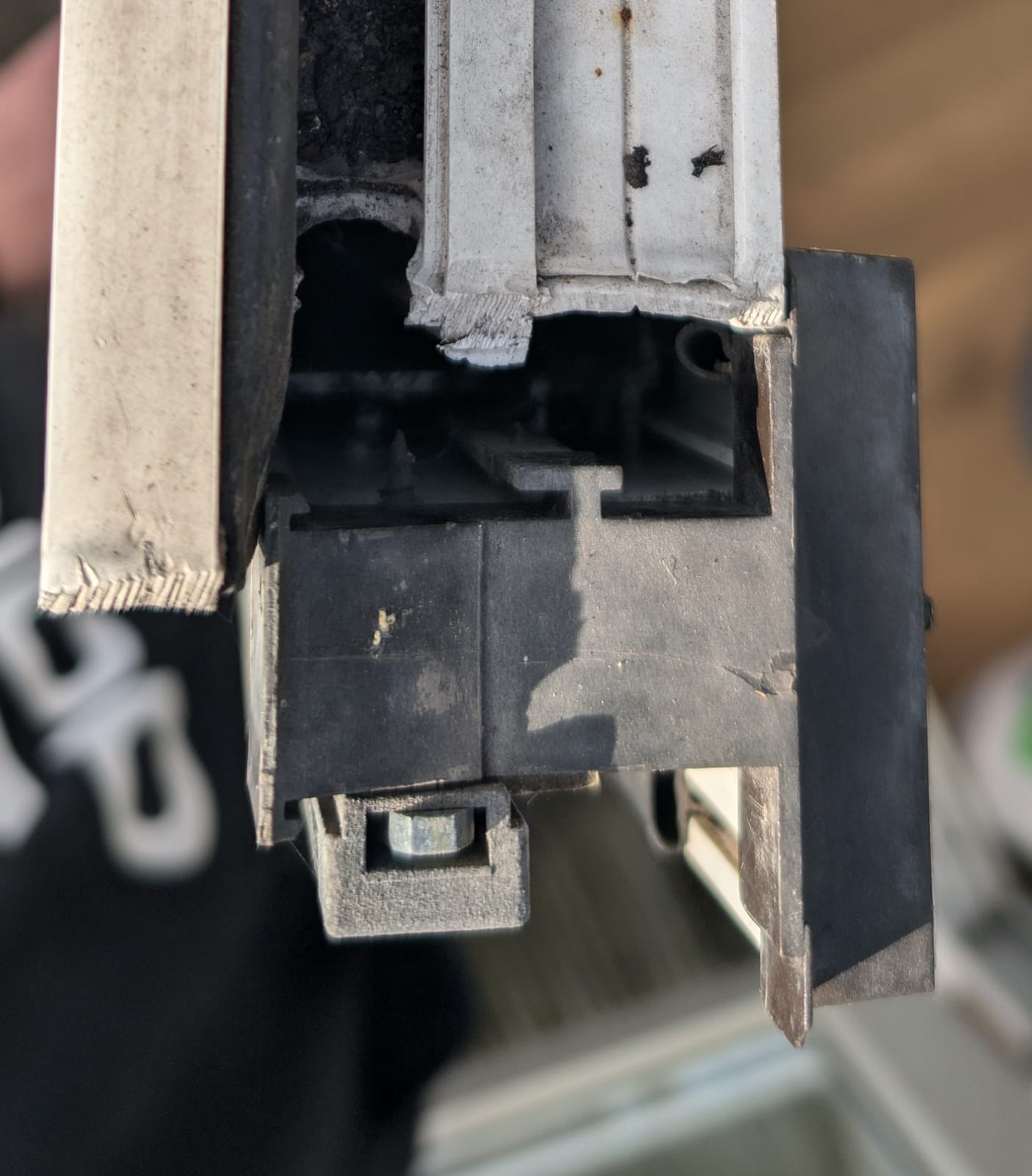

Hi, just moved into a property and the bottom mullion is missing from the French doors. Anyone any ideas what brand/type model no is needed. The first pic is the top of the door. The 2nd is the bottom.
Thanks in advance!!

No luck unfortunately, my kit that I refer to goes back to around mid 90's and this is a lot older than that possibly mid 80's, the squared off corners and the surface mounted dog bolt(shootbolt) is a dead giveaway along with the lack of a euro groove, its an old profile and even if I knew the make the chances of finding an end cap are slim to none. I have known some people to get then 3D printed before
Thanks very much for the reply. At least it stops me from looking everywhere for the part. I could probably take the top cap off and try and assemble something similar out of UPVC for the bottom. If that doesn't work, like you said get a 3D printed one.
