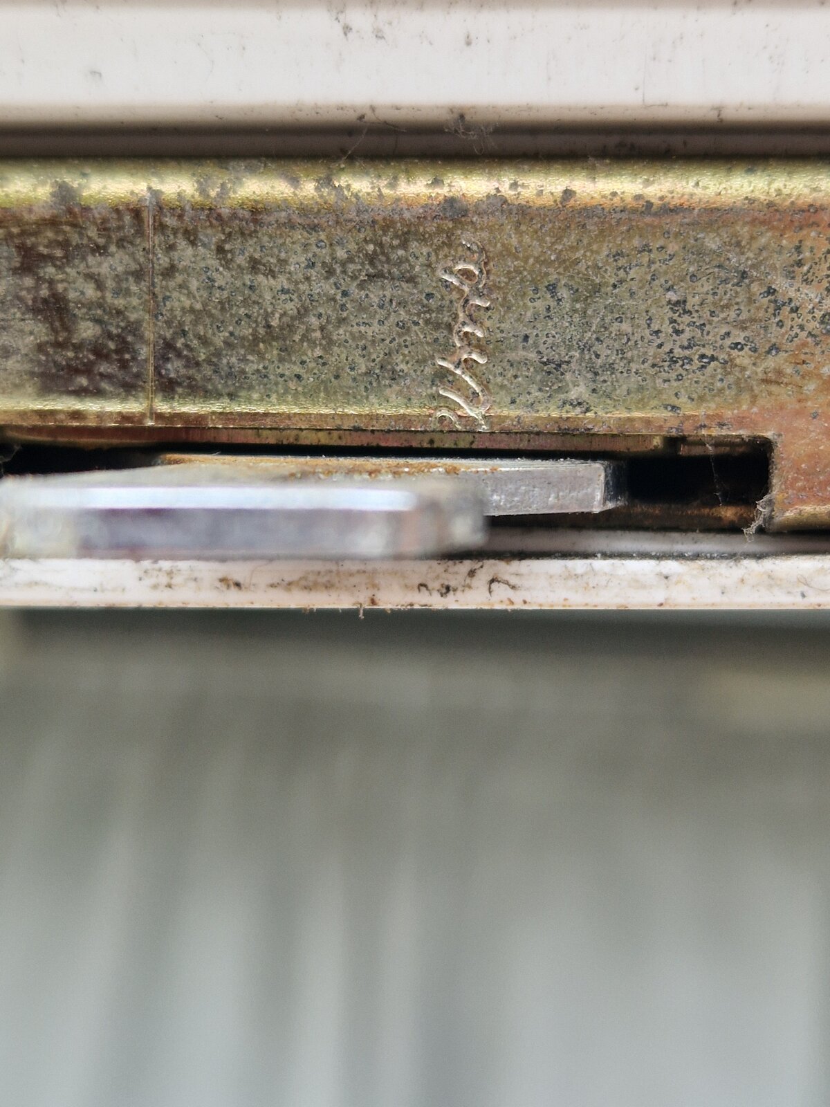

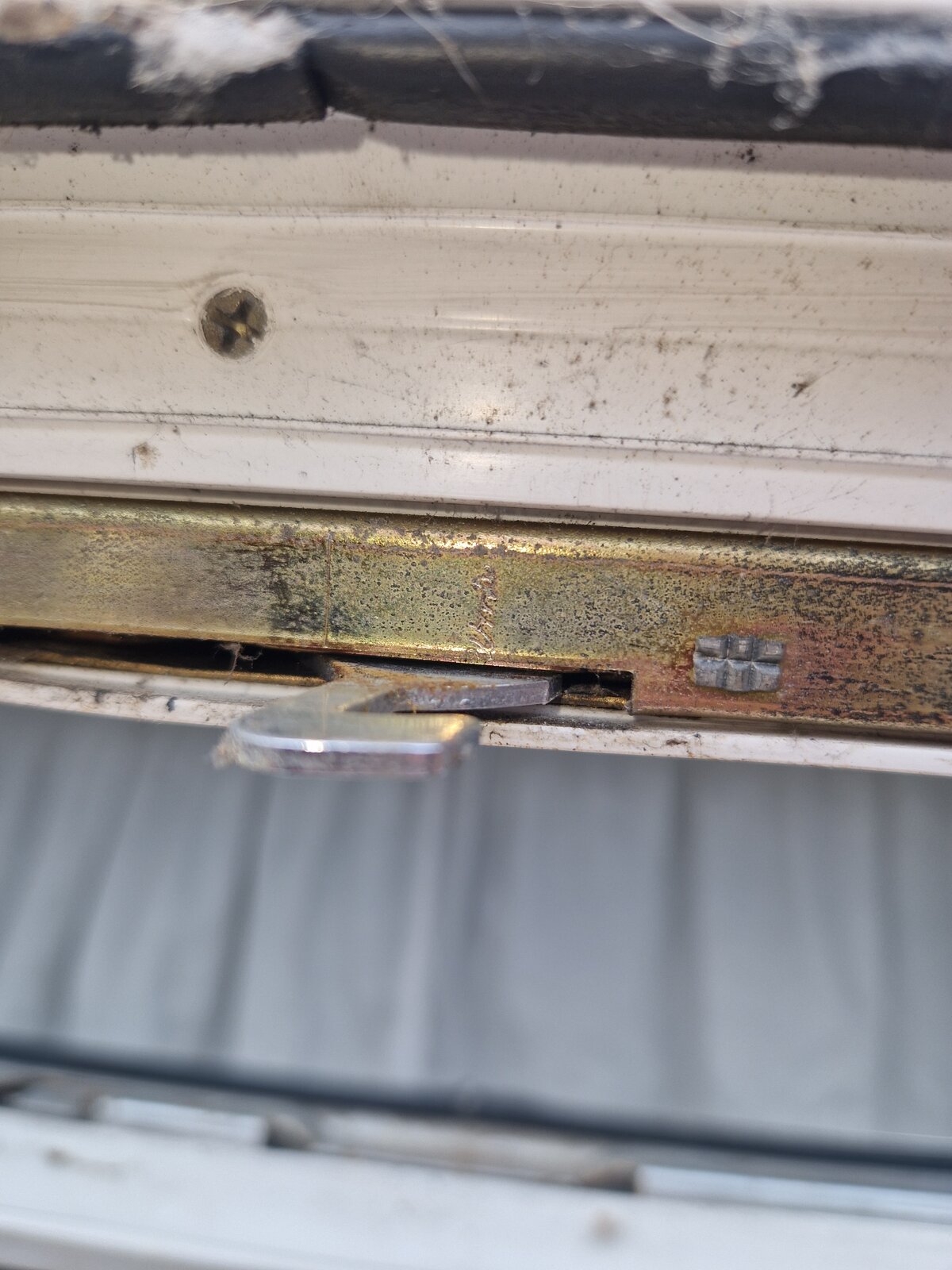

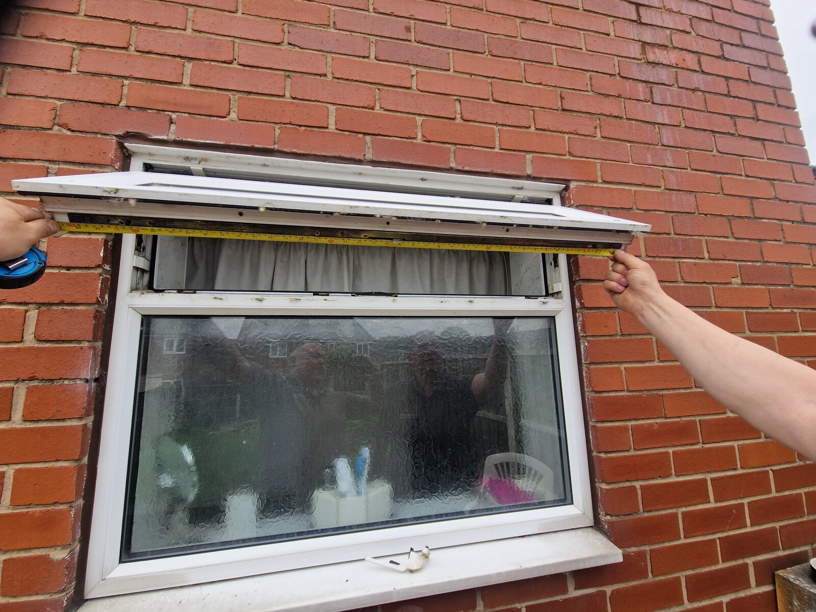

Hi
Advice needed please , gear section has shattered where spindle goes , can this be replaced or is it full mechanism if so any one know where I can buy one please..thanks

That's an old Coldseal window, they had various versions of locks over the years but all obsolete now, if I remember rightly your style has a one piece stainless steel locking keep on the frame that's either still got the protective tape on it or it's gone rusty?
If you Google Coldseal window locking mechanism you'll find lots of results for a modern upgrade including new keeps
