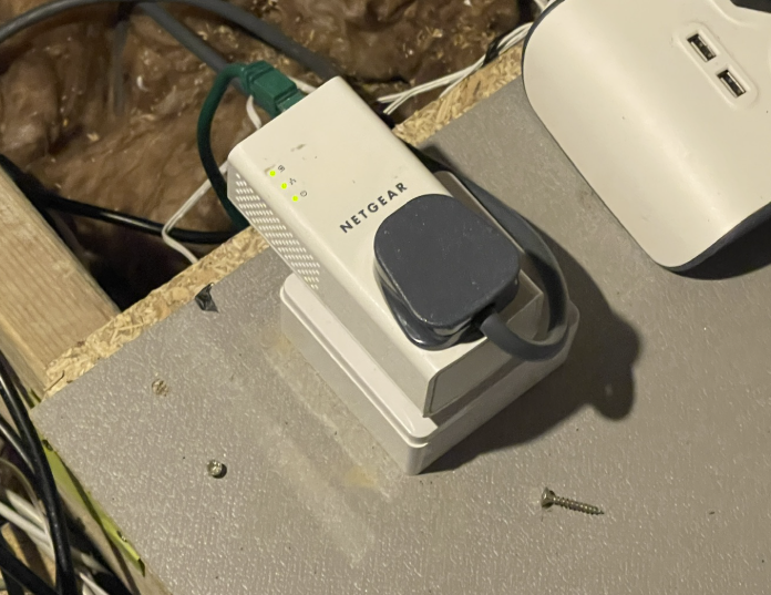

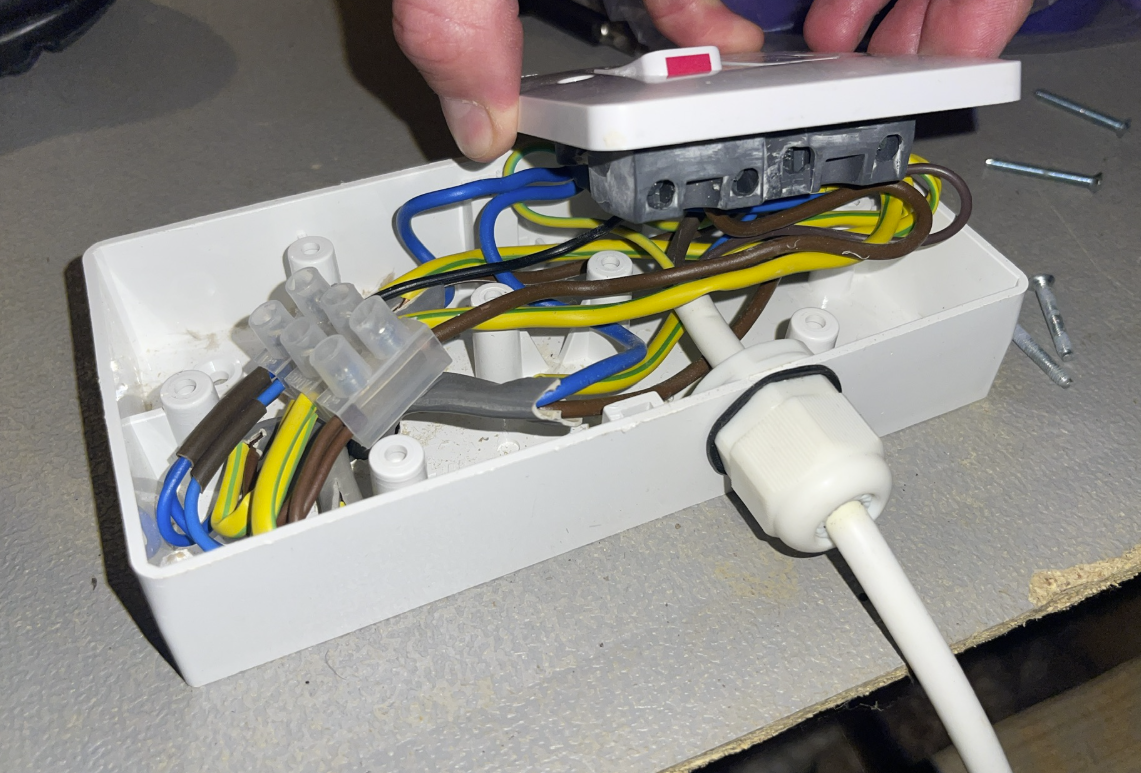

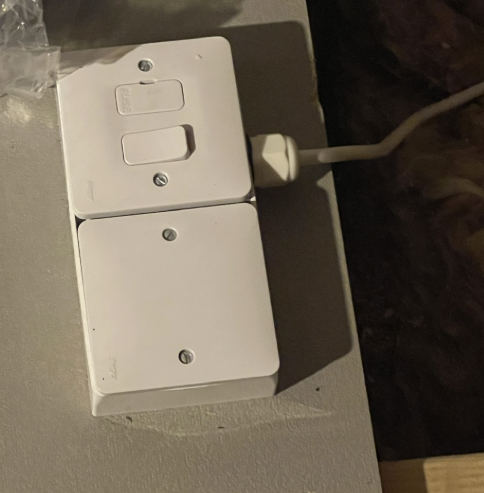

I’d appreciate some advice on this.
I’m looking to install a split-system air conditioner in my front bedroom. Accessing the power sockets in the bedroom would be difficult, so I was wondering whether the installer could instead use the loft circuit for power.
The loft has a dedicated 16A MCB on the consumer unit. Currently, the loft powers the following:
  • A Vent-Axia MVHR unit (120w/0.12kWh)
  • A 12 volt network switch
  • A powerline adapter connected to a CCTV NVR
  • A TV aerial booster
The total load on this circuit is currently light.
Would this circuit be suitable to supply a typical domestic split-system AC unit?
I am looking at a small units such as the Mitsubishi Heavy IndustriesSRC35ZSP-W, which has a rated input of 1.65kW and a cooling capacity of 3.2kW and a heating capacity of 3.6kW.
I’ve attached a photo showing the powerpoint in the loft. The fused spur in the image supplies the MVHR. The bedroom is just below where the fused spur currently is.
Thanks in advance for your help.

MHRV ducting is nowhere near large enough to be able to provide cooled air, so yes an air-con unit would be required for what you want.
With a split system, the outdoor unit is going to use the majority of the power, the unit inside the bedroom is going to use very little (Except possibly in heating mode, if this is a large convector heater instead of a heating and cooling heat pump. So where you power the outdoor unit from is the important bit, the part in the bedroom would be fine in a 16amp circuit
Thanks, so what I am thinking is run both the outside and the inside from the loft circuit seeing as it is 16a, cable thickness is the same as the 32a circuits and it has minimal load on it currently and won't be having anything else in the future unless someone were to convert the loft.
