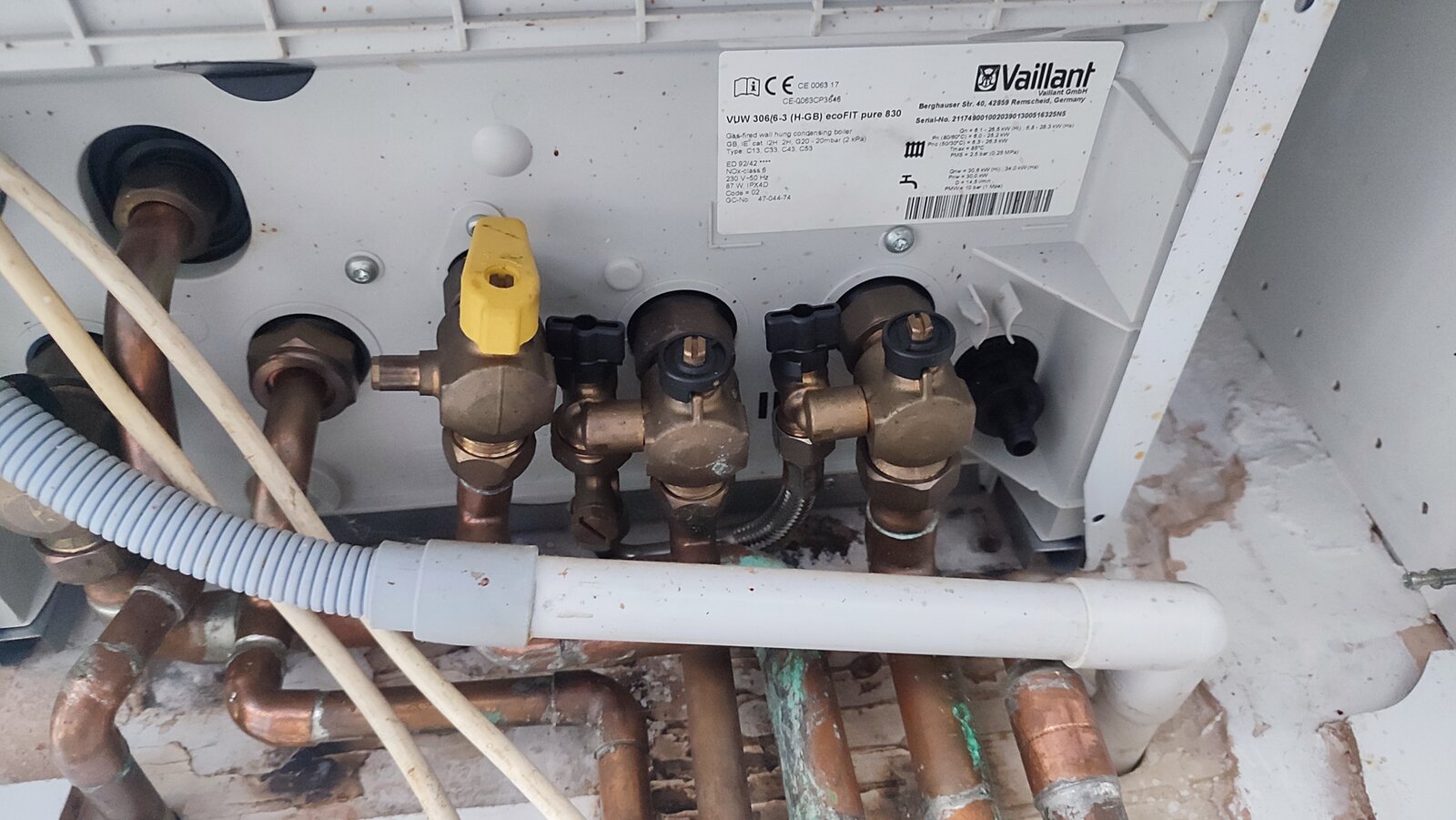

I called another engineer and he suggested turning off the isolation valve after re-pressurising it for a few hours. He said if the pressure then drops it could be a Boiler fault.
I've checked underneath but cannot work out which is the isolation valve:

Then simply get it up to temperature, turn it off, and isolate
That info would have prevented the waste of more than 50% of my last post.
Simply get it up to temperature, turn it off, and isolate at both heating valves.
Note the boiler pressure, and wait.
What is the boiler pressure after 1 hour?
What is the boiler pressure after 8 hours?
Does the boiler pressure go up or go down when you re-open the heating valves?
Sorry I thought by stating the model number would be sufficient.
I have just been told what you have suggested but any chance you can tell me how to isolate it? Also, does turning it off mean turning it off at the mains?
