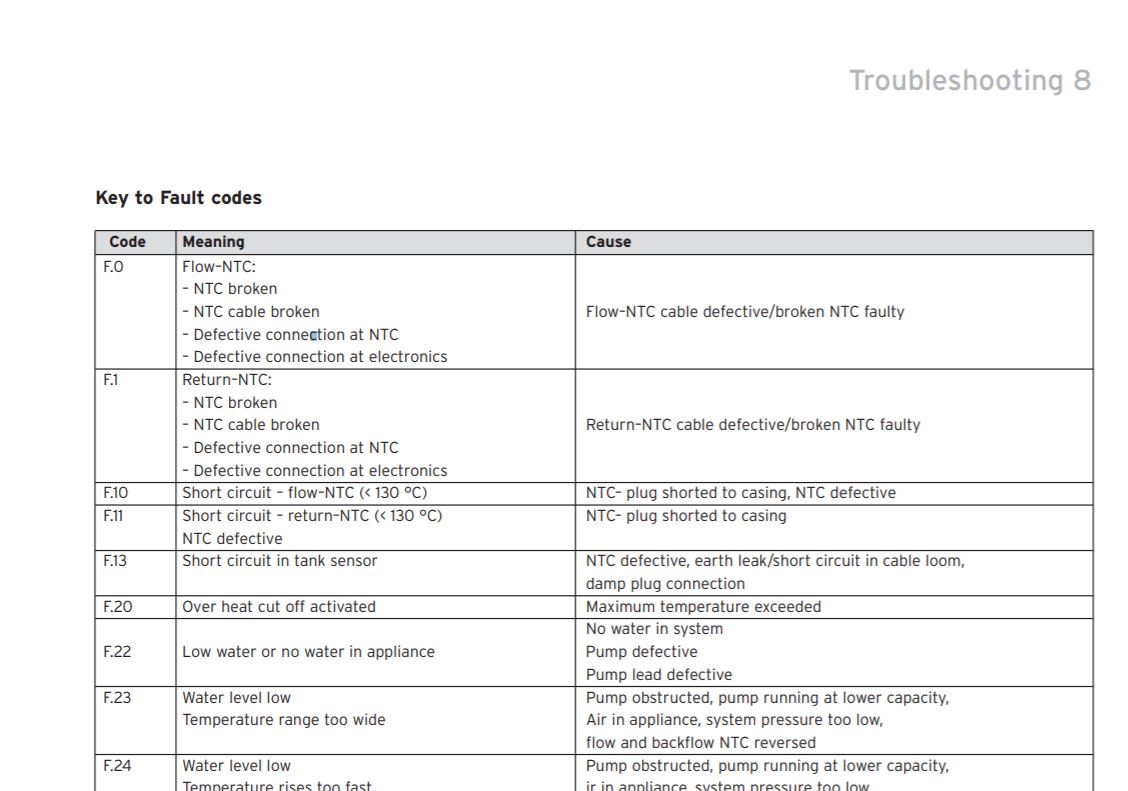

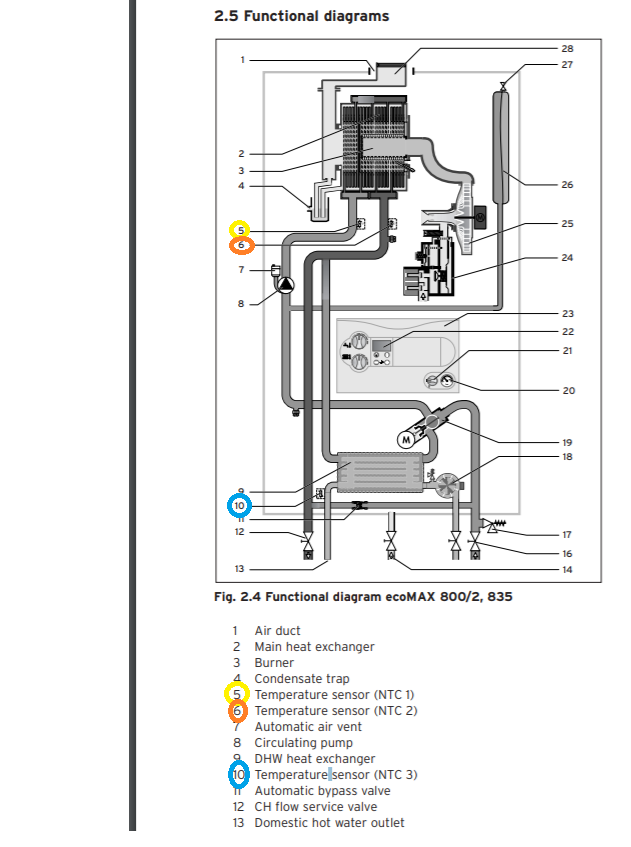

So looking at the manual, I thought I saw a clue... F.0 clearly stays is a "FLOW" NTC fault, only I can't quite work out which of the NTC's relate to flow, as in the same manual, they're just called temperate sensors... I think it's number 6, but that's the one I've replaced today with no difference

The NTC on the flow pipe is number 6 in the diagram. However, in the troubleshooting guide the problem may relate to 1 (or more) of 4 problems. Assuming you have replaced the NTC itself then the problem could be the connection to the NTC itself, its connection at the board or a broken NTC cable. If you have a multimeter with resistance and continuity reading, you could check the following (all with the boiler electrically isolated):
1. Disconnect the plug for the NTC from the NTC (if it is plug connected), and likewise disconnect the plug from the board (again if plug connected). Check the continuity of each side of the cable. If either side does not show continuity, replace the cable.
2. Measure the resistance of the NTC. It should be about 2,000 ohms at 25 degrees, dropping to about 250 ohms at 90 degrees. A mug of 3/4 boiling, 1/4 cold tap water should give you about 75 degrees, say around the 450 ohm mark. If the limits are out by more than about 15%, replace the thermistor.
If neither of the above identifies the problem, then it is probably the board. Then its time to call in an expert.

Have you tried phoning Vaillant tech help for a description of what the boiler thinks an F0 fault is? According to your diagrams F0 relates to temperature sensors only, or the main pcb. Measure the resistance from the point where the NTC sensor wiring connects to the main pcb, at least then you'll be able to determine whether it's a sensor/wiring loom or a pcb error.
