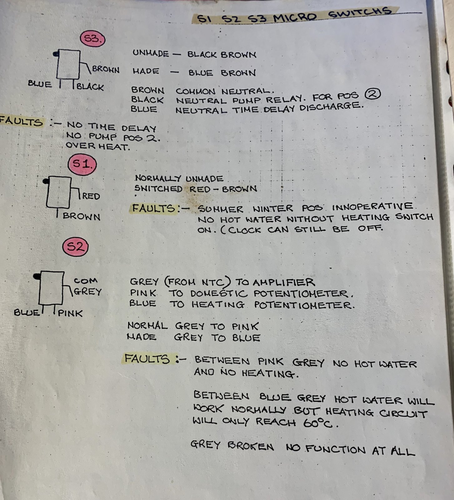

Ok, that’s an easy fix. Wax capsules are not an exact science, so it looks like yours is a bit sluggish and the flow temperature is rising above 60C before it contacts the left hand switch. So in doing so it’s turning off. Try bending up the left hand plate so it contacts earlier and see what happens.
OK, in that case it may be open circuit on that from Grey to Blue on the microswitch. Try spraying with contact cleaner with the power off and pilot out, or replace the microswitch with any standard changeover microswitch. Check the normally closed/normally open routing through the switch and make a note of the colours when you take the wires off. Unmade or rest in DHW, means the made circuit is Grey (top spade/common) to Pink (middle spade of the three).
Here you go, the page you need from my Germany training folder. Useless info for nowadays, apart from who needs it! The left hand switch is known as S2. The text near the bottom pins the fault down for you.

Much appreciated. That page is gold dust. I'll clean and check the switch tomorrow.

I checked the continuity of the microswitch S2 and it seemed ok however, to be certain, I replaced it with a spare that was definitely ok. But still no change to the boiler's behaviour. It still fires in bursts, does not exceed 60C and the thermostat knob has no effect whatsoever. It surely can't be a break in the wiring loom between the S2 blue and the CH pot (or the CH pot kaput) can it, because when I first reset the switchplate clearance the boiler reacted to the thermostat correctly but not since.
