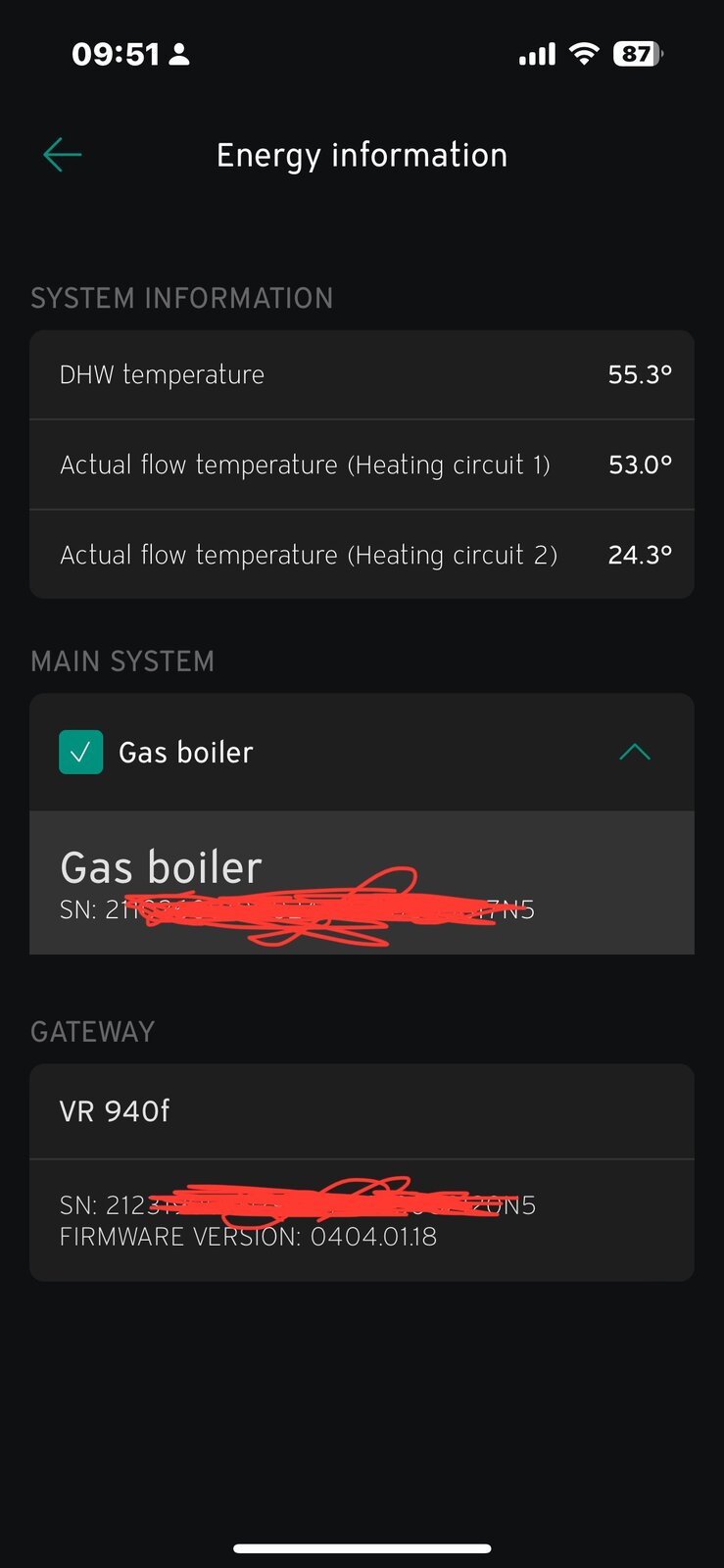

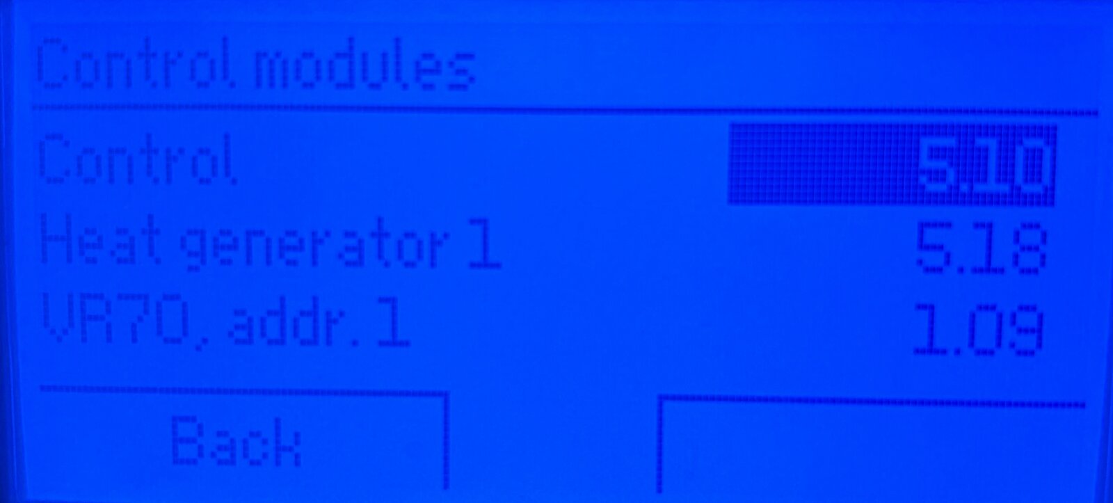

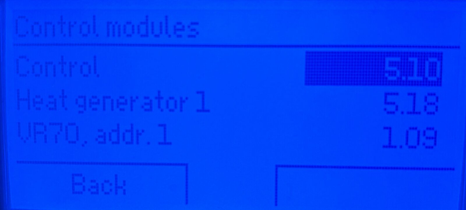

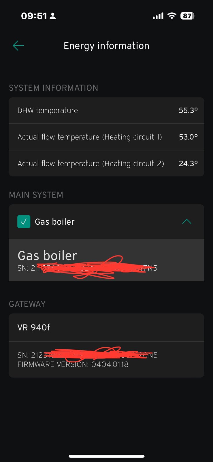

Here is what the VRC700 and Gateway see - this is the 728, the 730 doesn’t show up at all even though it works
Only heat generator 1 - my brain tells me it should also see heat generator 2
I am wondering if I need to adjust the eBus ID wheel on the 730 to give it a unique ID on the eBus -- maybe it is the same as the 728 and there is a conflict which kicks off sometimes (although I cannot see a way to change this ID on the 728 so this may be a red herring)
