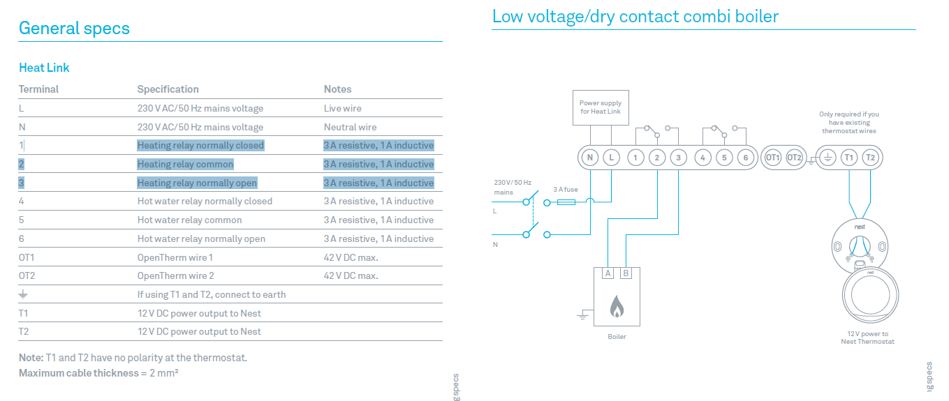

I'm in the processes of swapping my out my Vaillant VRT 360F to Nest.
Currently the Vaillant VRT controls my ecoTec 831 boiler over the eBus connection. When the Nest is installed, is it a just a case of unplugging the eBus connection from the boilers board? Nothing needs changing in the software menus on the boiler?
When connecting the Nest HeatLink module to the boilers 24v RT terminals do I use:
Option 1
Common (Pin 2 on the HeatLink) and Heating Relay Normally Closed (Pin 1 on the HeatLink)
Option 2
Common (Pin 2 on the HeatLink) and Heating Relay Normally Open (Pin 3 on the HeatLink)
Image attached of the pin options
I think option two as an open relay to me by default suggest the circuit is not complete so the boiler is off by default. I assume if I get it the wrong way around the boiler will either not fire up or do the inverse of what is being asked by the thermostat.
For completeness, the Heatlink will be wired to the boiler via a 5 core cable, so when the fuse spur for the boiler is turned off, the Heatlink will also be dead and safe too.

I take your point on board but, if that is the case, why are there new and old threads about similar topics with replies?
