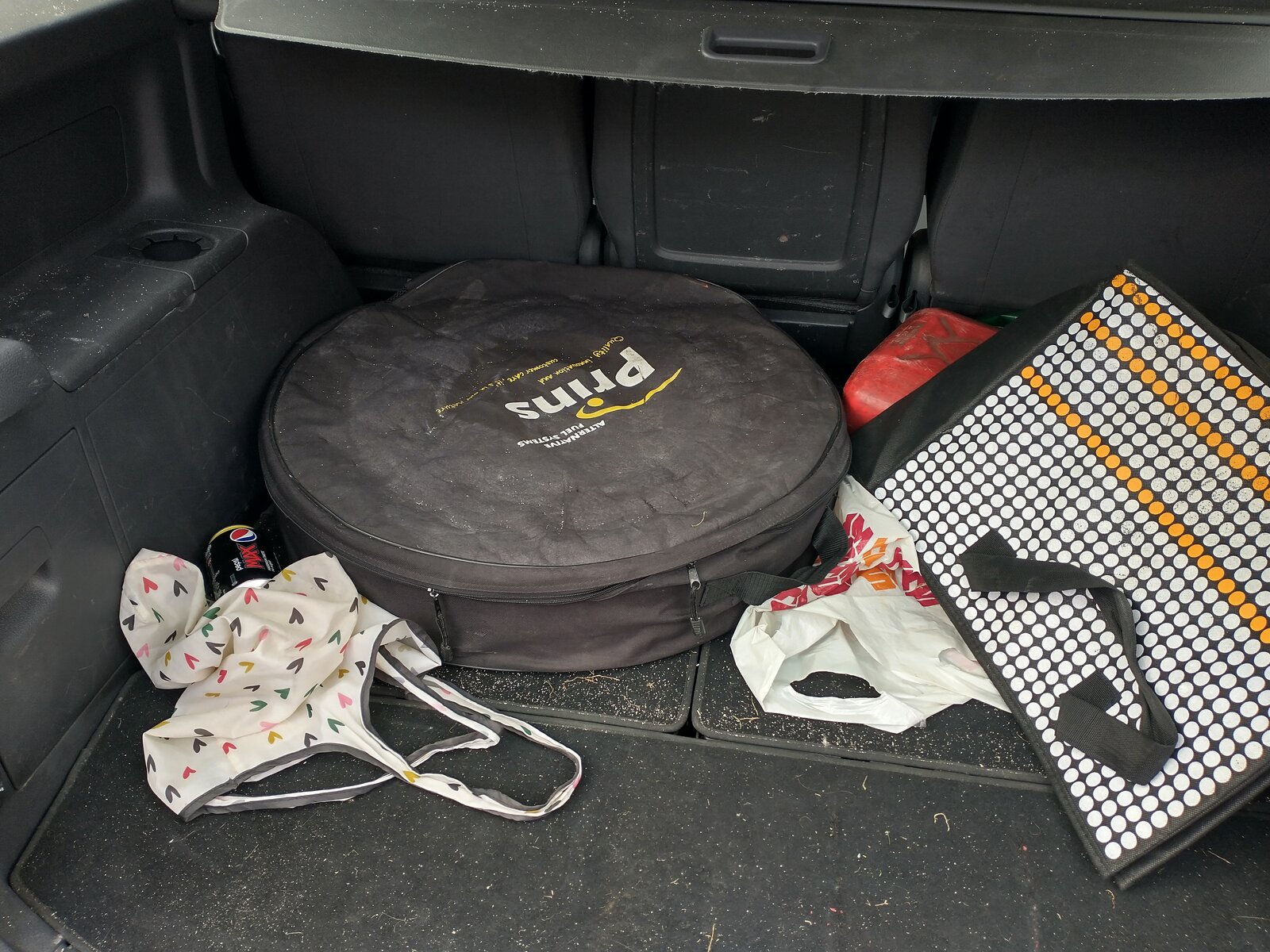

Advice please... My wife got a puncture the other day and discovered there's no spare in the boot. TyreWeld rubbish lasted a whole 1.6 miles before the tyre was as flat as before, so I want to get a proper spare.
- Full or skinny tyre? Obviously full handles better, but is it worth carrying the extra weight in the boot for months, only to use it for two days while I'm waiting for the replacement tyre?
- If skinny, what size do I need? Will any 16" work, or do I need to get a specific width/height? Also, what's a good make? I've found RoadHero, K.O.M and no-name stuff so far.
- If full, do I need to get alloys like the proper wheels or can I get a steel rim? I believe the wheel nuts are different - does this mean I just need different nuts for the spare or are the bolts different too?

I'm happy ish with a space saver. We have a VW Touran and the spare wheel well is occupied by the two rear seats so the space saver sits in the boot (a bit of a pain but I'd rather have it than not). I also carry the can of foam and used it the other week (tyre was soft and wouldn't pump up, we were in a rush and I couldn't be arsed with the spare). It got us back 60miles. My tyre place absolutely refused to repair it (despite being a Holt's product which promises not to damage the tyre, just wash it out etc). Not a lot I could do to argue with them but in the end when they took it off the nail was in the edge so they couldn't have repaired it anyway - but lesson learned for me.
