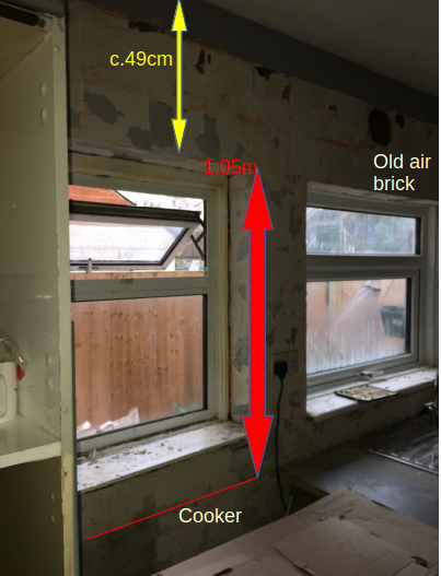

Hi all, hope this isn't too wrong a place to put this.
At the outset of renovating my kitchen, but can't make a decision on whether to bother with an extractor as the hob will be over a metre from where we would put the hood. I can see the regs have a minimum height from the hob, but not sure whether putting it this far away would be totally useless. Grateful for your thoughts, here's a pic:
More context- solid external wall. There's an old air brick further down the galley kitchen, which I was going to brick up. Was toying with the idea of getting a nice looking hit and miss grill over it, but I'm not sure we'd need extra ventilation. In the original set up there was a fireplace in this room. I'm going to get the windows and see if we can get rid of the column in the middle and have a new lintel etc.
Also discounted the idea of running a vent to the old air brick as it would basically look crap, and while we've got this apart might as well do it properly.
Anyway open to ideas from the wealth of experience on here. Thanks!
Are you planning on getting an induction hob or electric cooker as I don't think the regs allow a gas one to be installed there.
That's right yes it's electric. Out of interest how come gas would be against the regs in that position, is it because of the proximity to the unit to the left?
You don’t want to “pulling” an airflow across a window. Without getting into the science of Thermal Co-efficients v’s the temperature of the glass depending on the weather, ambient temp etc, you just don’t want to be pulling ‘dirty’ air and steam across a glass panel.
No, because of the risk of a draft or wind blowing out the flame as far as I remember. But according to simplesteve it doesn't sound like a good location for any type of cooker/hob
Thanks guys, I hadn't even thought of that as an issue but will have a rethink. Either way I think committing to a hood at this stage isn't worth it. I'll get the wheels in motion on the window first and see where that leaves us. Poss shift where the cooker sits to the left so it's well clear of the new window.

Sinks go in front of windows definitely not cookers.
Why not re-design the kitchen with the extractor 650mm above the elec hob, and an ext 750mm above the gas hob - & if possible an easy ext duct passage to the outside terminal.
Thanks, yep I understand that bit - there's a sink down the end. The thing is there's an abundance of window on that side, and very little wall. So blocking it up or re-sizing the windows is probably required.
