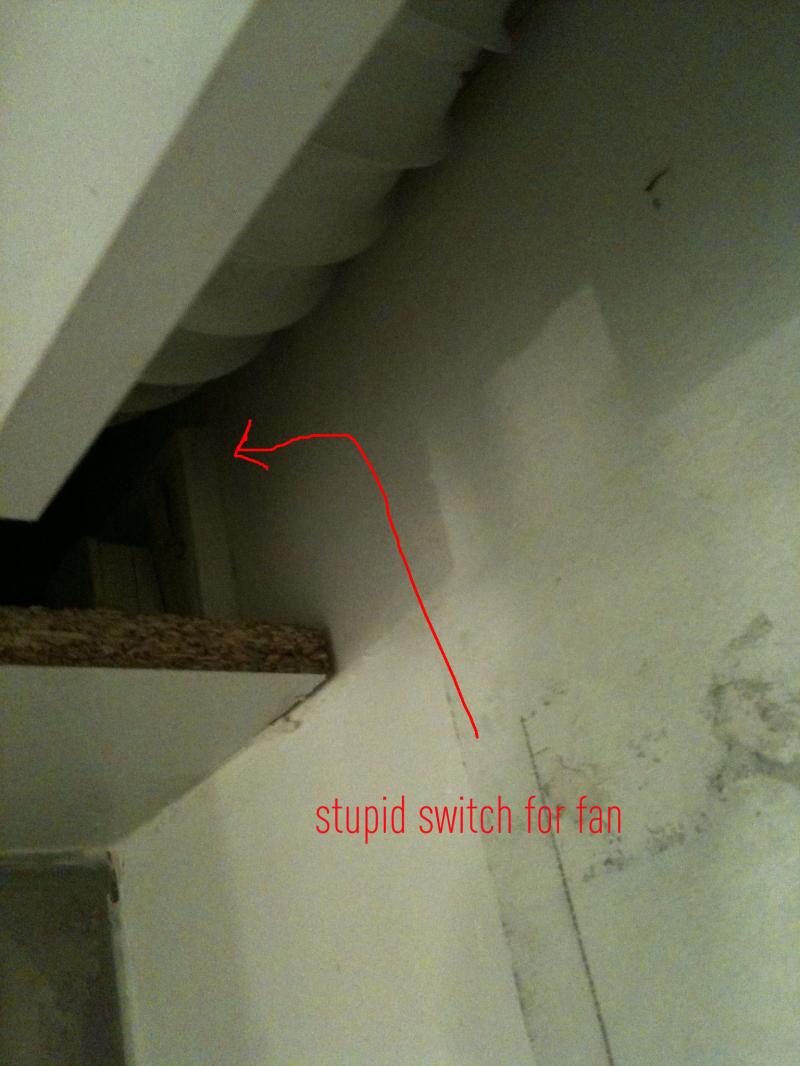

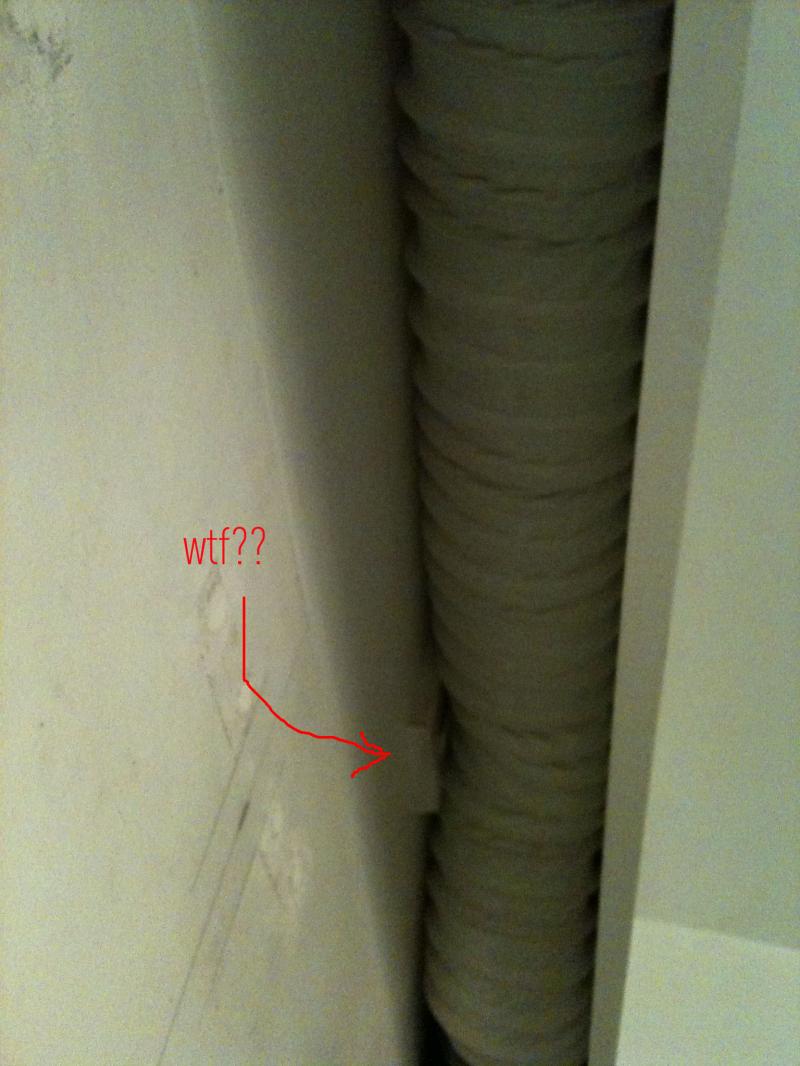

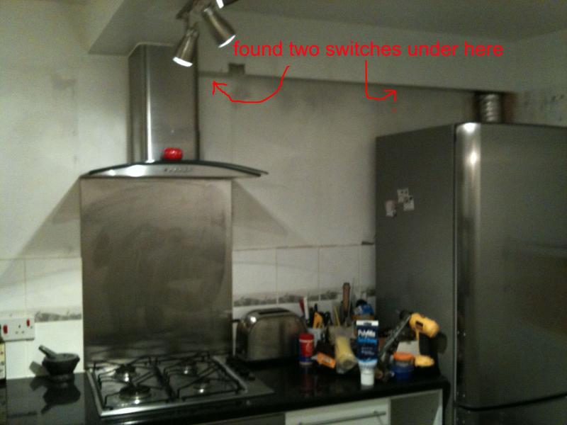

When removing the wall cupboards in my kitchen the underside of the boxing for the ventilation pipe from the cooker hood was left open. And that was a good thing really since I now can see that the previous owner made some hasty and stupid solutions. The two pictures blow will hopefully give you an idea.
The serious problem is that the previous owner cased in a kill switch and a fuse box. This is illegal isn't it?
I can also see that the boxing is made of low grade chipboard which this forum has advised me is not ideal for a kitchen. The ventilation tube itself is of that flexible wire and plastic stuff.
Now instead of hiring an expensive electrician to move fuse and kill switch could I just be a proper hipster and just use a stiff galvanised tube as in the picture at the bottom of this post? What are these steel tubes called? Would I need a pro to install it and if so what profession should I turn to? (But I've got medium level handy skills so could I have a go myself?)

My problem is that the electric bits are currently CASED IN BY THE BOXING AROUND THE VENTILATION SHAFT. That is NOT my fault, it is the previous owners fault.
If I choose to leave this open the switch and fuse will be perfectly accessible, safe and legal. However, if I don't rebuild the boxing I will need a firm steel ventilation tube instead of the current relatively soft flexible tube.
My question is about the ventilation tube, not the electrics. If I didn't care about safety, would I have bothered posted this question in the first place?

What you are looking for is stainless steel ducting. you should be able to fit this yourself if you feel capable.
I think what Emily was saying was simply that you should not touch the electrical side of things if you are not competent. This is true but maybe could have been worded a bit better. Any electrical work in the kitchen i.e if moving accessories around will have to be notified to building control prior to the commencement. As my understanding is that you are to fit solid ducting to allow access for the fused connection units then you are fine to re do the ducting.
