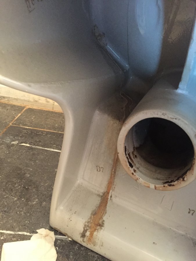

hi there,
I discovered a very slight leak in my toilet. It happens when flushing and I suspect has been going on for some time (possibly since it was installed 3 years ago).
I've taken the toilet off the wall and it looks like there is a small crack. See photo
I assume it should be thrown out but its a bit annoying as its not that old and this was presumably a manufacturing fault.
Be interested to here if this is a common problem and whether I should chuck the toilet.
Cheers,
Huw
Yup, no real way to repair a crack in the casting. Could have happened anytime, usually during shipping though as it should have been quality checked prior to that. Time for a new one.
ok thanks for letting me know.
I notice there is a 5 year manufacturers guarantee with this toilet so I'll be contacting them tomorrow
