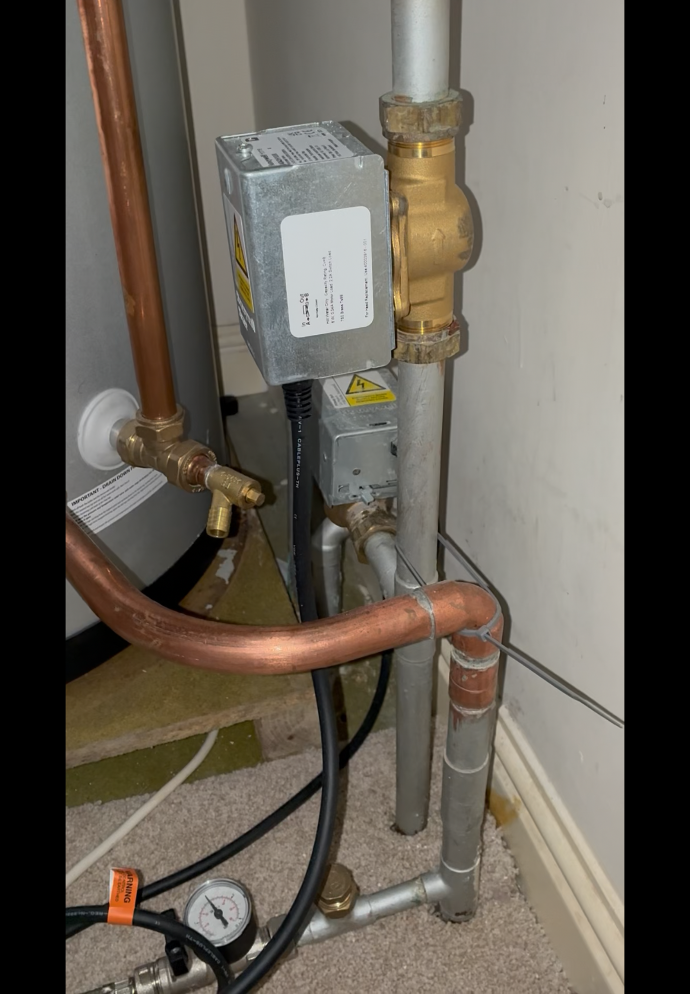

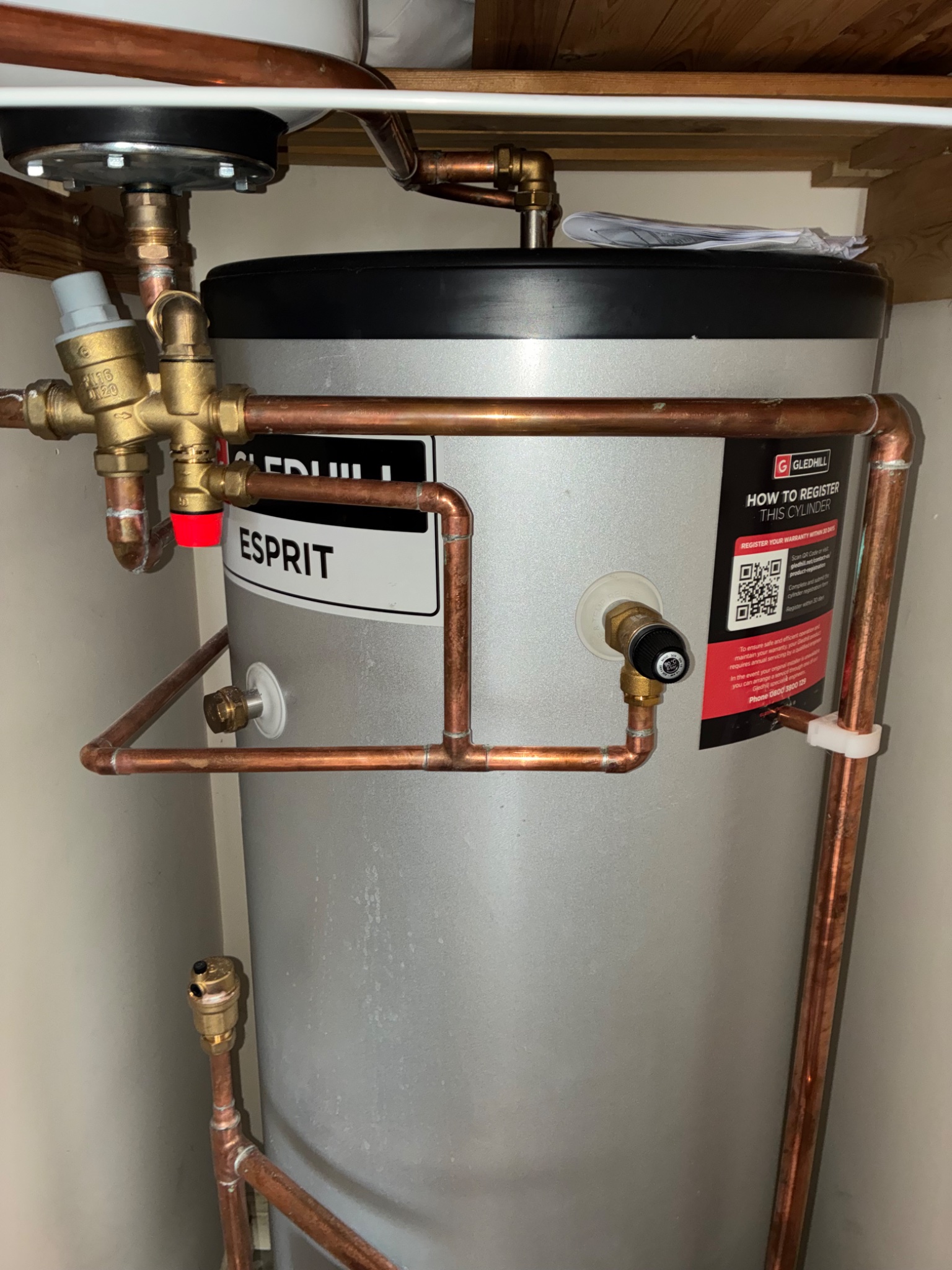

Vibrating/ droning sound since new hot water cylinder was installed.
Checked the air vent is slacked off, The lockshield valve has an outer collar, you probably new that a radiator key is too small. I don’t want to damage the outer brass collar anymore, it’s already slightly bent. I’ve order a 4 way utility key that comes today. Can you tell me, If adjusting this valve stops the noise, can I leave this lockshield valve like that long term ? Or is this a temporary solution, in which we need a ABV installed going forward? Typically it hasn’t vibrated/ droned much in the short time I’ve been at home this week; but I’m here home most of tomorrow, with my new 4 way key!
A ABV installation is still recommended even if the boiler (like yours?) has a internal one, to cool down the boiler heat exchanger but if there is no banging/noise from the boiler on pump overrun when it shuts down without it, maybe leave it.

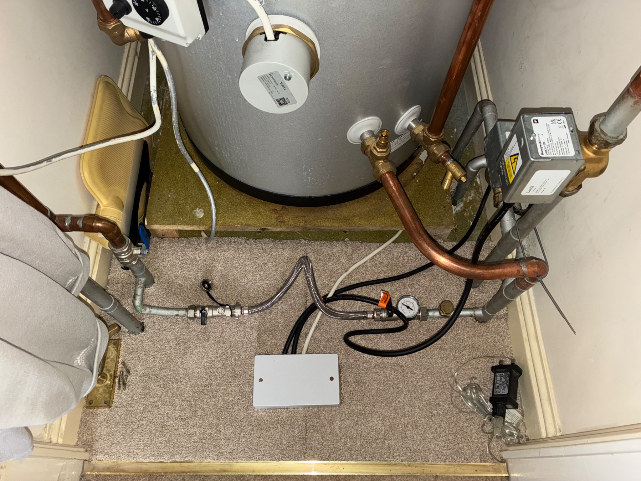

Update on the return pipe spindle:
Hi again,
Thanks for the advice. I managed to turn the spindle on the return pipe using my smallest pliers (the 4-way key wouldn't fit). I marked the original starting position with a pink marker pen so I wouldn't lose my place.
Here is what happened:
  • I managed to turn it one full turn clockwise. As it got tighter, it started making a much louder water-flowing/rushing noise, likely because it was nearly closed off.
  • Because it was getting stiff to turn with the pliers, I backed it off anticlockwise until that rushing sound stopped.
  • I ended up leaving it half a turn more clockwise (closer to closed) than where I originally started.
The result: The drone did come back briefly later that evening, but it was much milder and only lasted for a few seconds.
Am I on the right track here? Should I try to close it down a bit further using the pliers to see if the drone stops completely, or does this indicate a different issue with the valve or balance?
Yes, just adjust until the noise stops, then monitor for a bit.
If it all works as expected then job done.
Update
A different heating engineer was here today to service the boiler (he installed the boiler about 6 years ago.)
He had a look at the cylinder and said it definitely should have an automatic bypass valve.
It started to drone slightly, unbeknown to me, he took the brass collar off of the lockshield gate valve and adjusted it with his fingers, it stopped instantly. It hasn’t made a noise all evening . He said ideally, I should have a ABV fitted.
He also changed my programmer, so I can now have my hot water and central heating on separate times. So my hot water is now on 3 times a day for 30 minutes…Thanks for all the help everyone!
