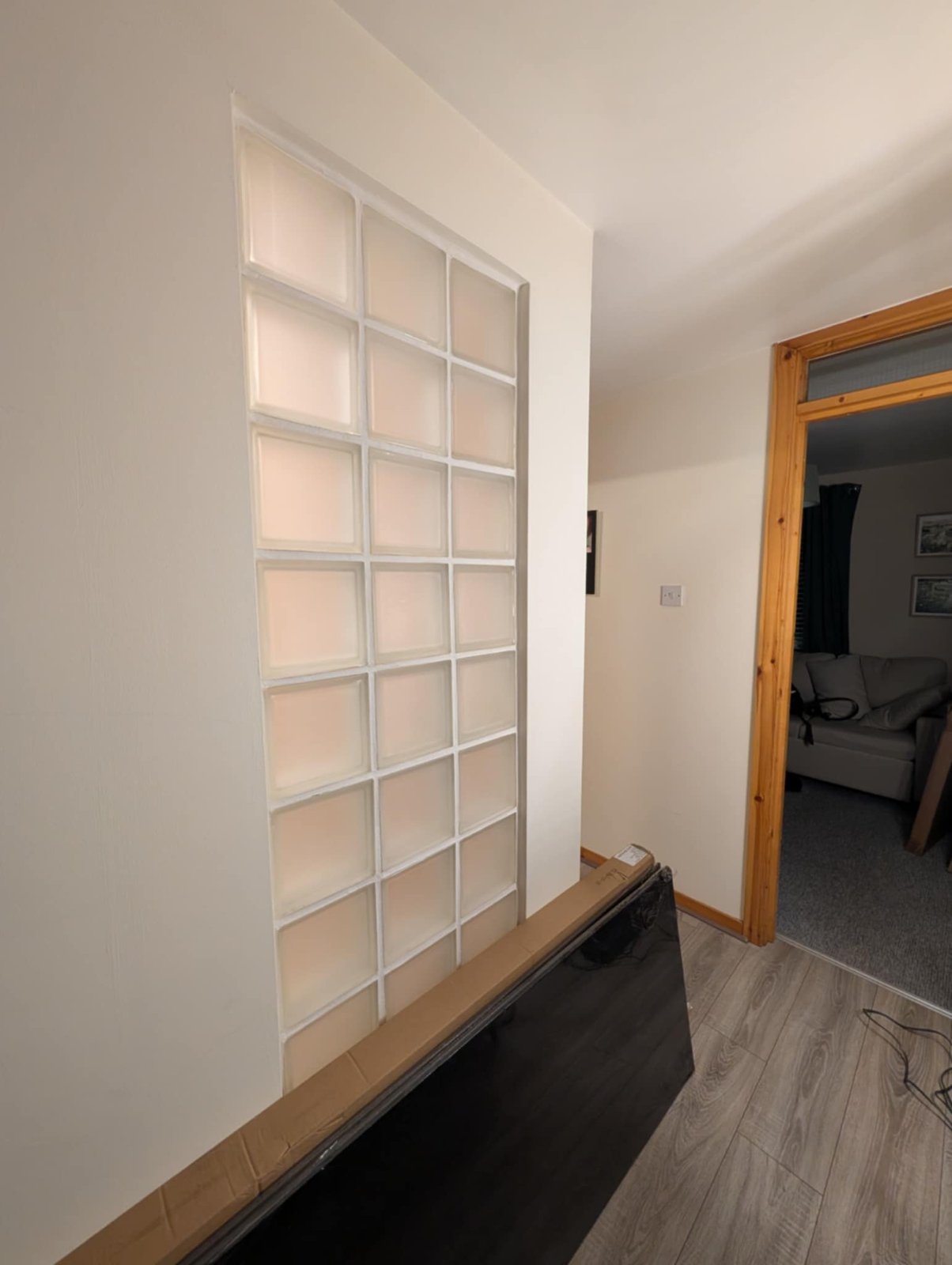

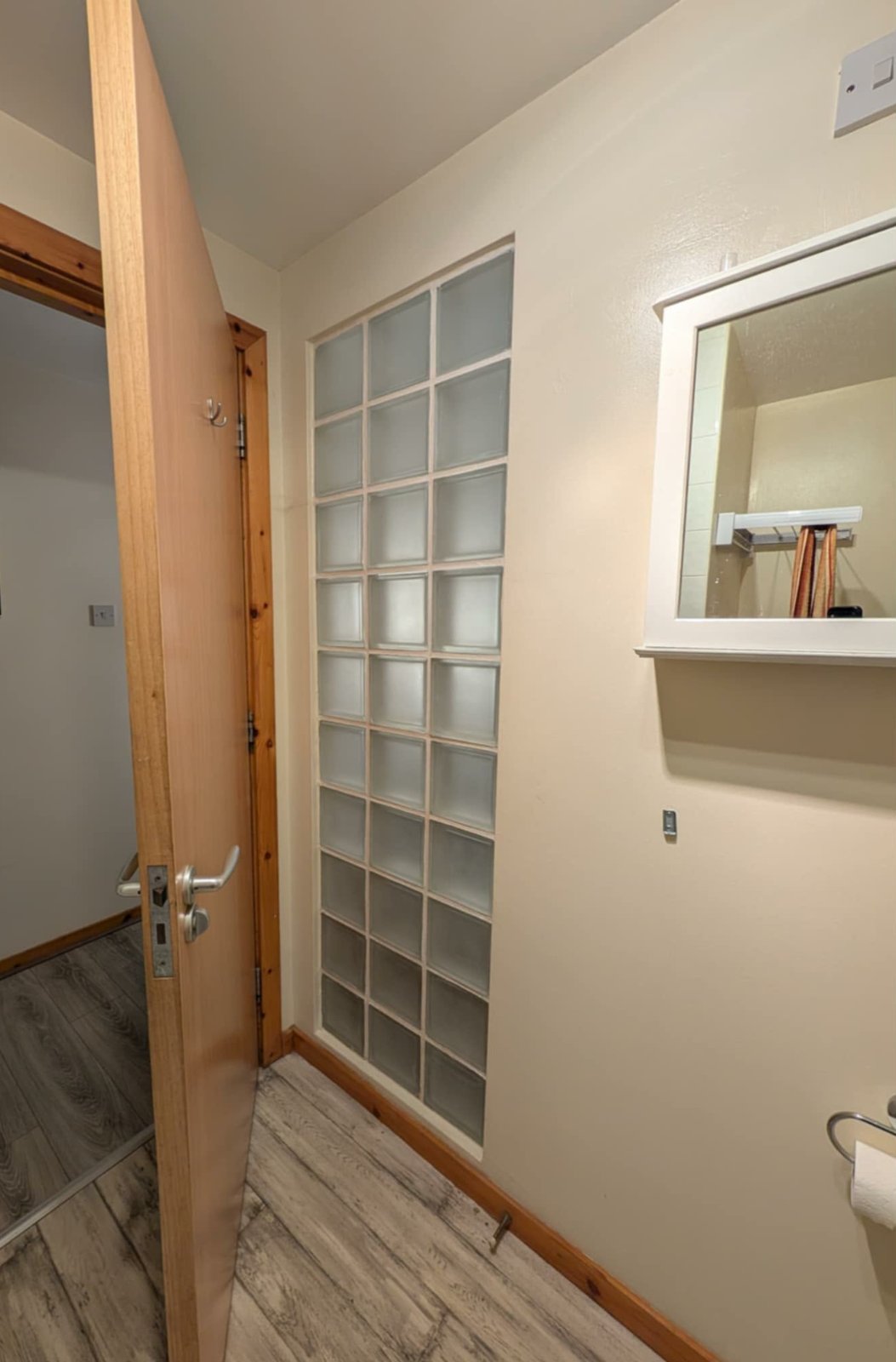

Hello, I have this wall (glass bricks) that divides a hallway and the bathroom, I am interested in removing the glass bricks and filling it in, basically so it is the same as the surrounding wall. How much (approx) does this tend to cost? And how long will it take?

Assuming its to be plasterboard on the other side too, probably about 2 days, maybe a day and a bit to remove and stud it out and board it up, the next day to come back and skim it. I'd assume something like £600-£1000 depending on whom you employ including disposal of rubbish. Though you might be able to sell or give away the glass blocks on Marketplace if the can be deconstructed. It doesn't look like the skirting is affected.
Looks from the pics to be room to just bond a bit of plasterboard over the blocks?
