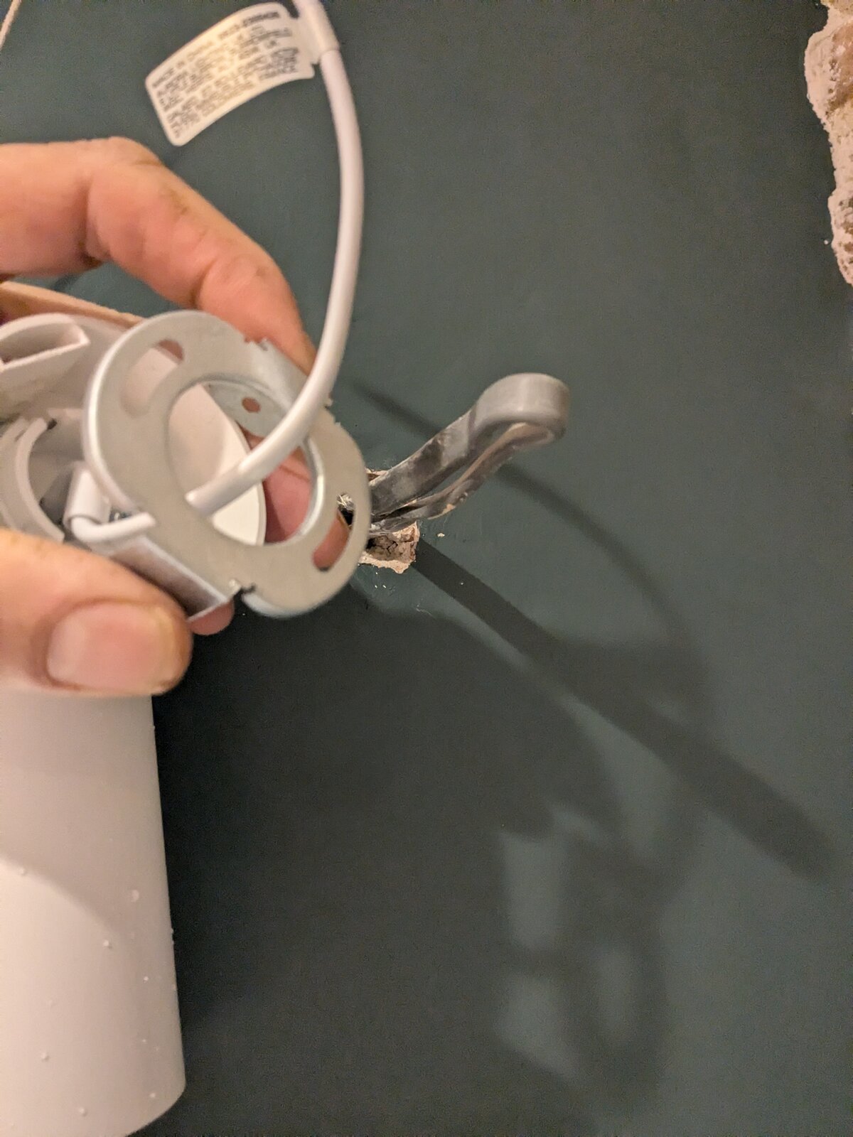

I thought I was being pretty clever when I pulled cable for a wall mounted spotlight to illuminate bathroom mirror - daisy chain from downlights......
I fixed a triangle of timber into corner of stud work so there was something solid behind plasterboard to attach spotlight to... With the cable sticking through a hole in said timber....
Now I come to fit a spotlight, to find I can't push the cables back through, and there is no way they will fit behind spot.... Grrrrrrrrr.!
Anyone know of a wall mounted spot with plenty of spaced behind??

Something like this, providing it's more than 600mm from the edge of shower/bath. Otherwise you'll need something with a higher IP rating.
It appears ample room if you strip the grey and the white sheathing more
@theflyingpig
From your initial post, it appears you intended to push the join back within the wall.
How would that conform.
@trojanhawrs
I suggested terminating it within the base of the enclosure, which is the way a vast majority of wall mounted fittings are mounted.
The fitting becomes the enclosure.
No, I intended to terminate in the spotlight enclosure, but clearly have the wrong light.
@trojanhawrs
My mistake, looking at it I thought the mount in his fingers wasn't covered by the light base. Would definitely be a squeeze though
