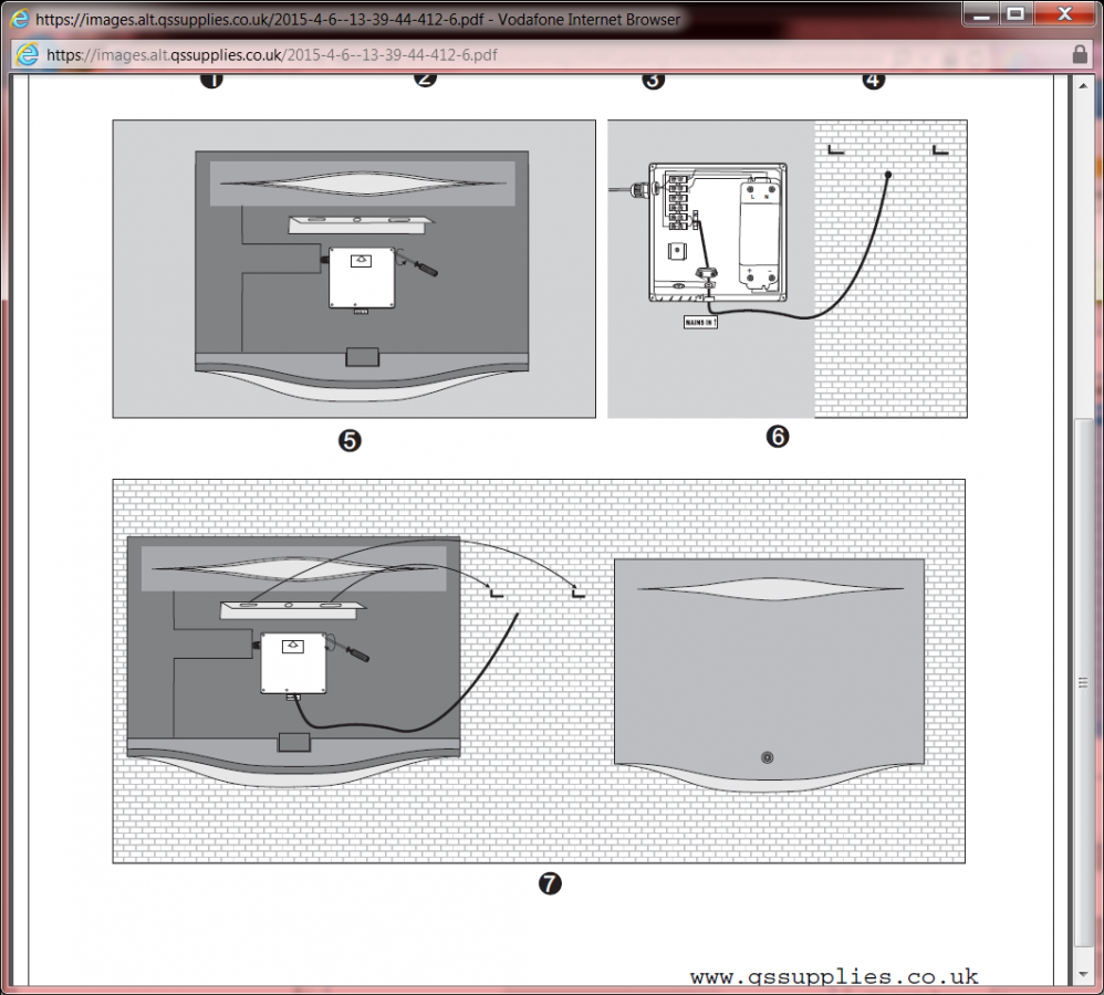

Wow thanks for the responses. Following your advice I have decided not to use a lightning cable and will go down the twin & earth route instead. I have easy uncluttered access to the loft space directly above the bathroom and these lights are bathroom graded and appear well insulated/ Below are the comprehensive instructions
for the LED mirror. Appears easy enough by doesn't suggest whether I can or cant use it with light switch off. I guess I need a proper modern style "chocolate box", thinking of a central one and then five legs off that. Any recommendations on brand or style would be appreciated. Thanks once again guys n girls
i
Cannot tell from the diagram, but does the cabinet have a switch for its lights?
If so, you need to run the supply to the cabinet from a permanent live neutral and earth somewhere up in the loft. Then you can switch on the cabinet lights separately.
The lights will require a neutral and SWITCHED live (plus earth). A photo of the wiring in your existing light might help here......
PS, its usually easier to run wires from light 1 to 2 to 3 to 4... etc, rather than bring them all back to a big central junction box "octopus style".
Does your LED mirror have its own light switch. Is that what you're asking, whether this can work with the light switch on or off? If that's what you want then you wouldn't wire it through the light switch with the rest of the lights. You'd want a separate fused spur either direct from the light circuit or from the ring main. I'll let the pros argue about which would be most appropriate and meet the regulations for bathroom zones.

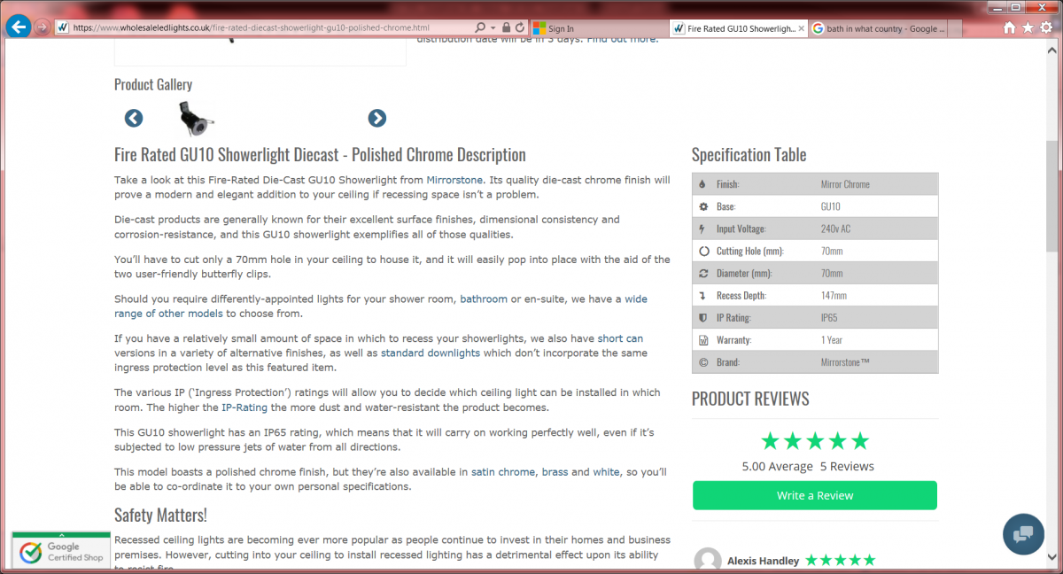

These are the downlights I have bought, seem pretty solid and pass the bathroom test. Maybe its not got a transformer then. Also the LED does have a touch sensitive on / off button built into the mirror. Anyhow Ill give it a whirl next week, cheers
Presumably that means they have the right IP rating and the maker says they are suitable for use in Zone <whatever>?
That only applies to the electrical integrity of the light in damp/wet environments. See this for an illustration (deliberately extreme to make the point) of how a light can have as high an IP rating as you like and yet offer no barrier for air passing through it into the loft.
