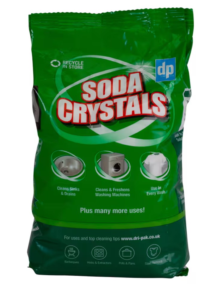

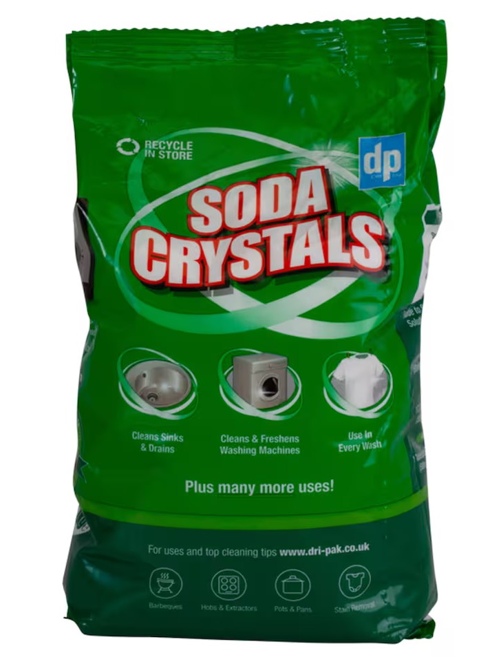

For (1) and (2) go to the supermarket or hardware store and buy some Washing Soda Crystals. In the laundry section. May just be called Soda crystals. Thus is NOT Caustic Soda which can be used for drain clearance and burning holes in skin and eyeballs.
Put a cup of the crystals in the powder drawer and run a hot hot hot wash with no soap or fabsoft. You can put white cotton towels in if you have them, they will not be damaged by the heat and will not fade.
The water in the machine will go grey and foam up because the soap sludge is dissolving out.
The towels will come out softer, more absorbent and whiter than before because the residue has washed out.
If the machine is very sludgy you may have to do it a few times.
In future, do a hot cotton wash once a week with 50% soap and 50% Soda. You will not need fabsoft.
Check the instructions on the box for the correct measurement of powder or liquid. People commonly use too much and it does not dissolve, especially at low temperatures, leading to accumulation of sludge. Washing Soda softens the water and dissolves soap and grease.
