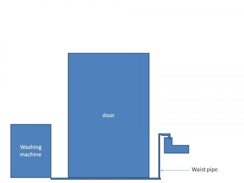

Hi All I need to move my washing machine about an extra meter away from the outlet am i ok running part of the waist pipe at floor leval?
The manual does say i can extend by a meter but i was wanting to know if running part of it at floor leval is ok,
Yes floor level will be ok. Make sure at the end it goes up a metre to stop syphoning.
Yes floor level will be ok. Make sure at the end it goes up a metre to stop siphoning.
No given height for outlet, just has to pass higher than pipe drainage it's connected to, it prevents siphoning.
