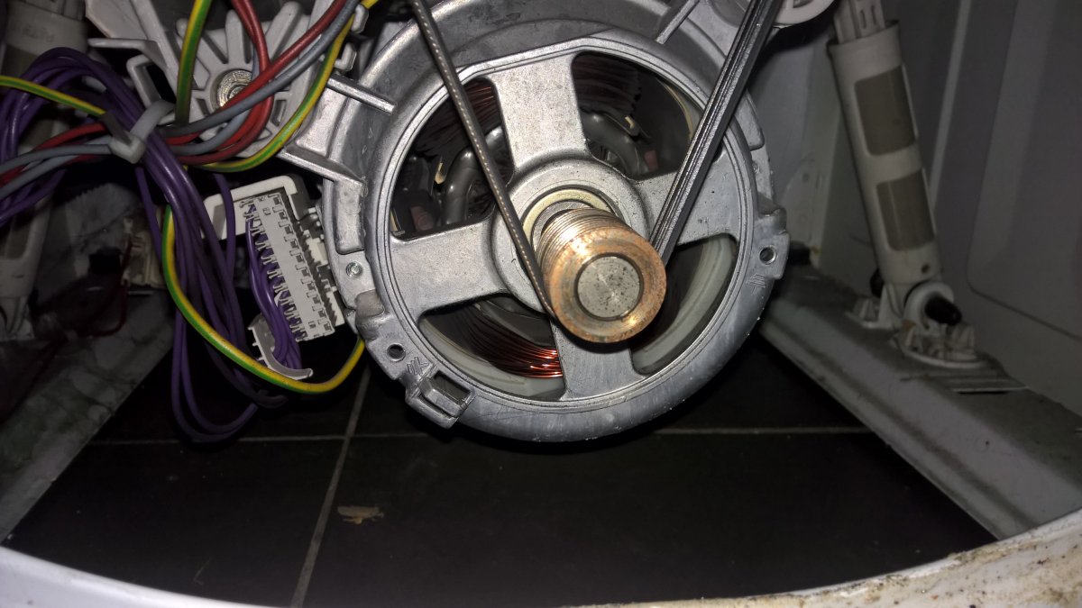

I had fixated on drain issues because of error code. I'll be honest I'm not that sure what I'm looking at in the motor to check the brushes but I'll have a look
Had a look, not sure if checking will involve some disassembly? Cant see obvious brushes, I've only ever replaced them on a drill motor before. Attached picture of motor if this helps.

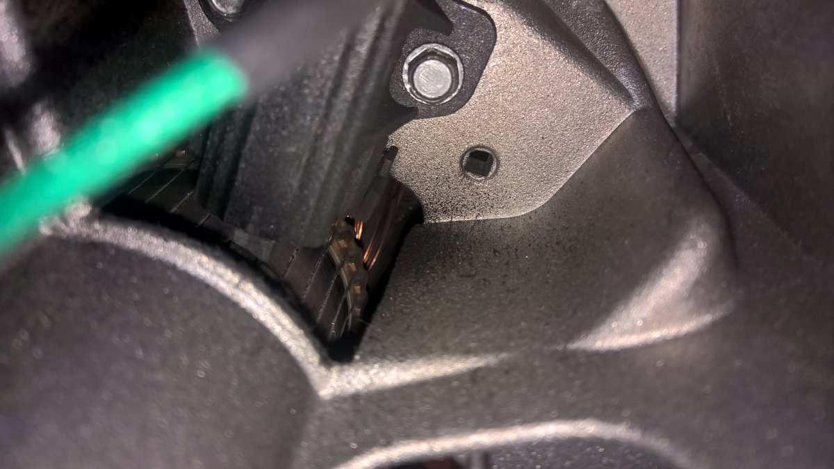

Ok, so I've managed to get a look at them. They do look worn but I don't know enough to know if that would be causing the problem. I tried to take one off however the hex bolt appears to be a 5.5mm as neither a 5mm or 6mm will budge it. So I've tried to take a picture as best I can.
They look worn but both appear to still be making good contact.

They need to be a good length in order for the spring to ensure good contact with the commutator. You really need to get them off & replace them if they are only 10 to 12mm left.

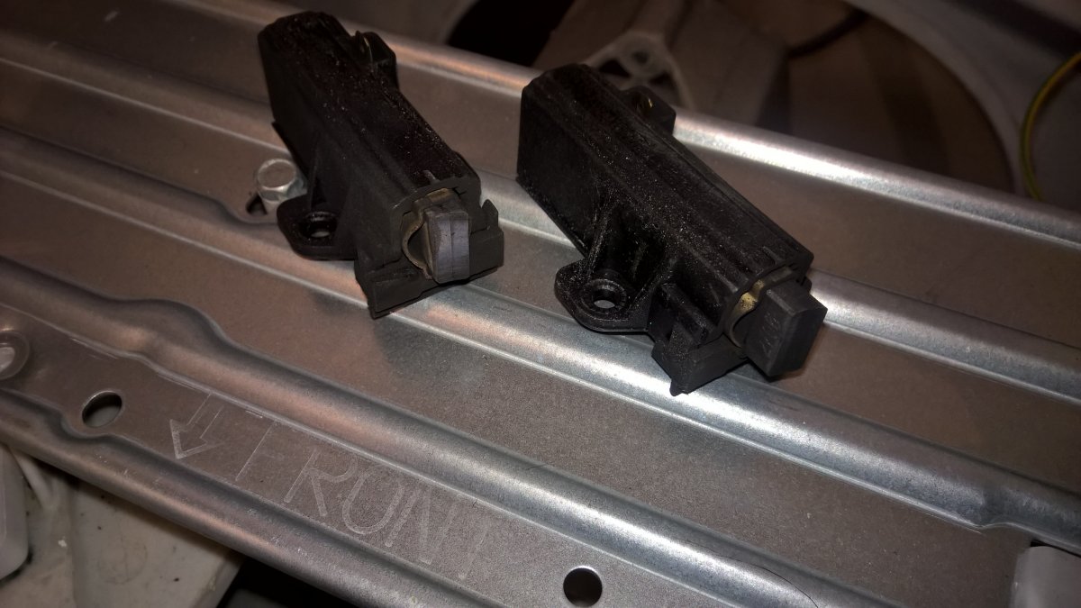

Just to say thanks once again, new brushes fitted and machine is up and running. I've done a quick test on spin cycle and the Mrs' has just put a full load in.
Here's the culprits, I must admit the one on the right was the first one off and thought it didn't look to back and was beginning to worry that this would not solve my problem. However the wear it much more obvious on the other one.
