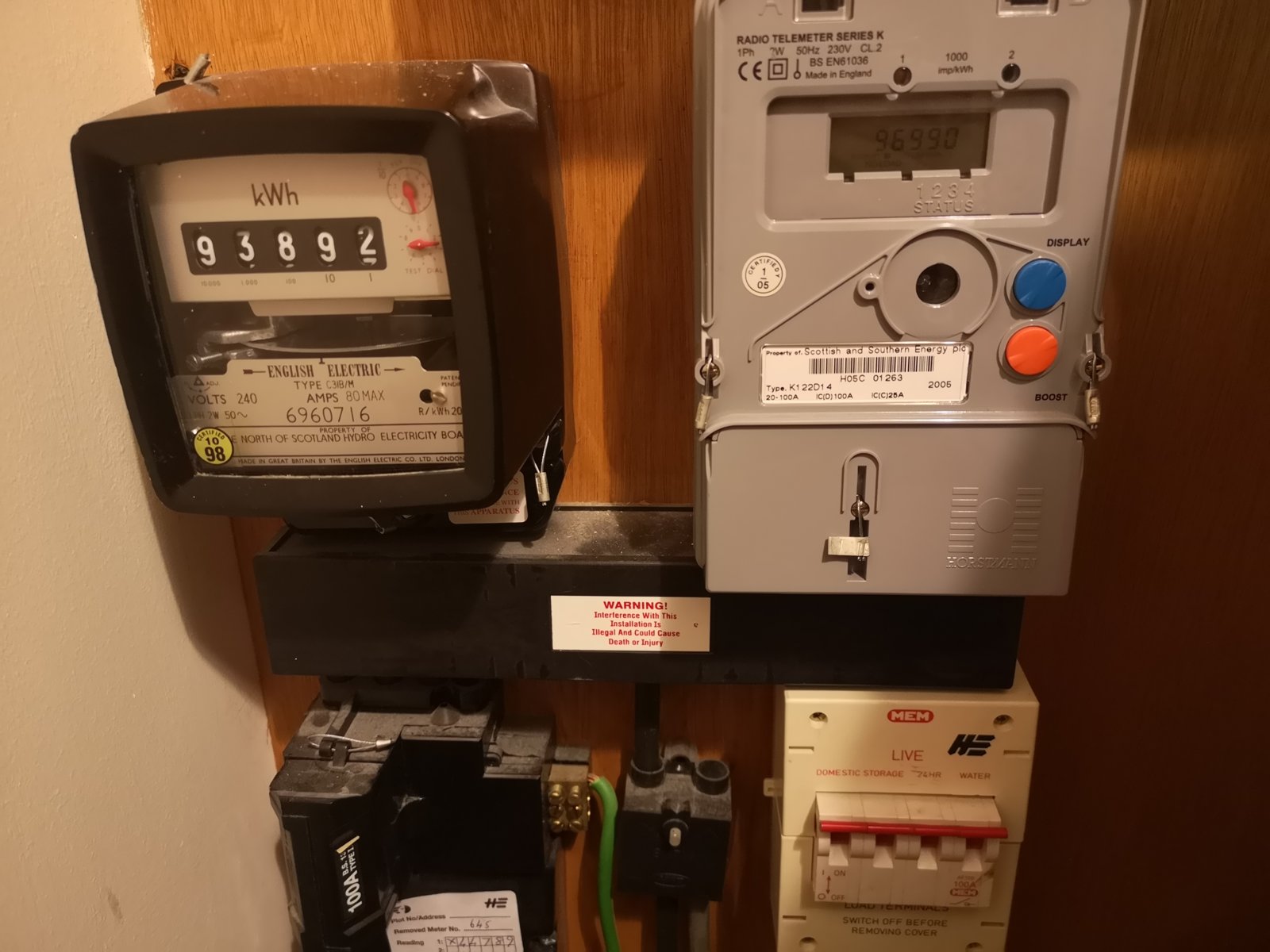

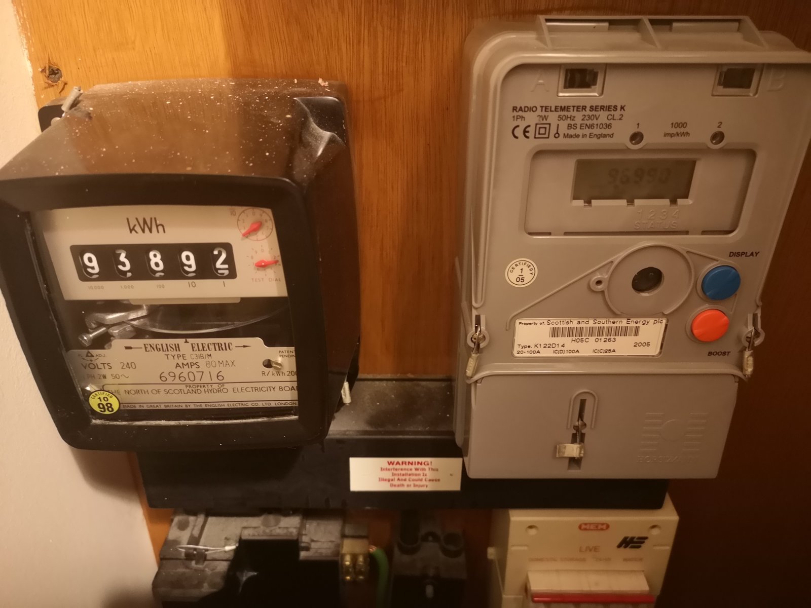

Below is a picture of my meters. Beyond the electrisaver control and the mains switches next to the tank. I don't think there's anything else to control them. Them seem quite basic n old to be honest.

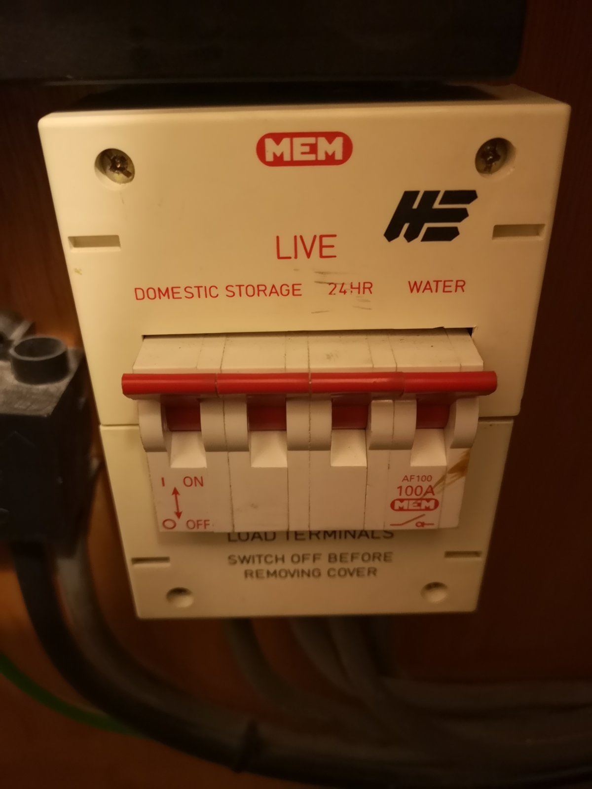

The "Telemeter" is the timer. It is controlled by a radio signal. In your case the signal may be governed by weather conditions as well as time, it is not often seen. With THTC I would have expected to see two meters. SSE should have a leaflet or webpage to explain it.
If you are on THTC it does not work the same as off-peak tariffs in other parts of the UK, and advice from non-locals may be incorrect.

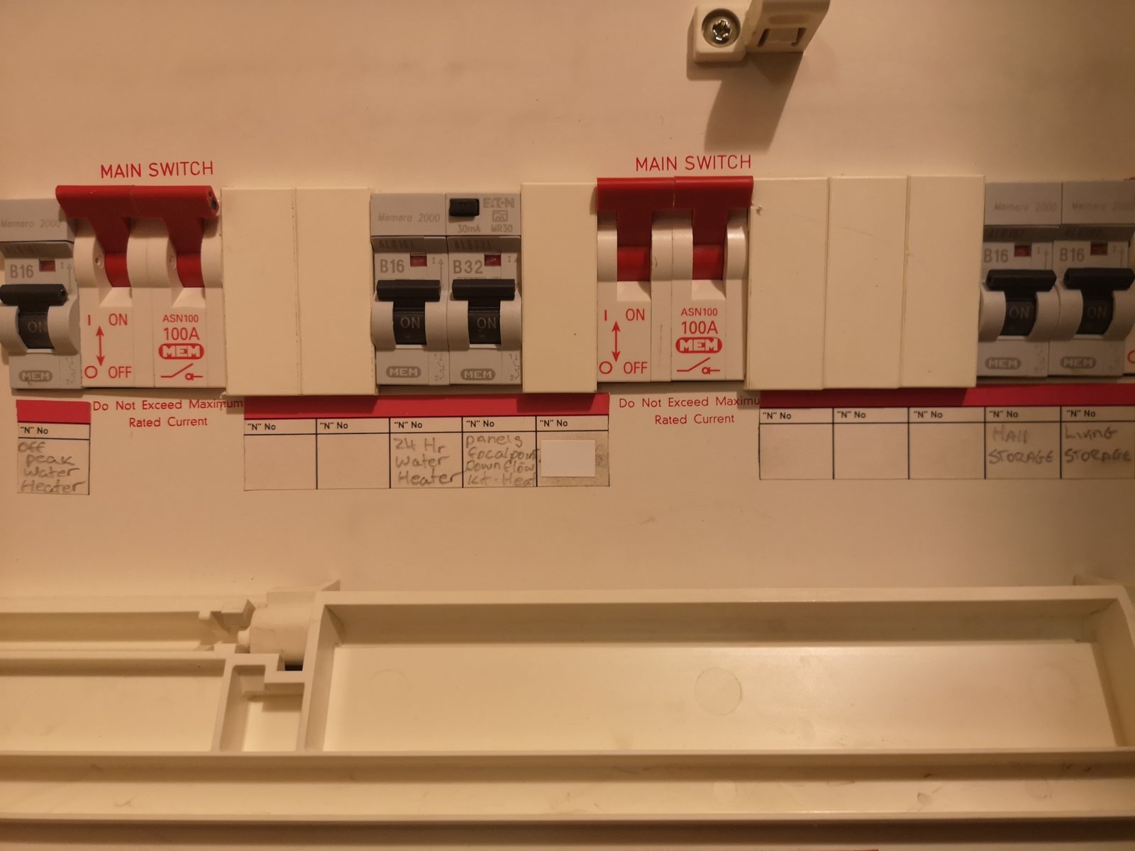

Your consumer unit(s) are what people used to call a "fusebox"
I would expect your off-peak heaters to be wired to a separate one because your normal sockets and lights need to be on 24 hours a day, not timed, but yours might be different..
Please look for and photograph it/them.
There's the black metre which still spinsand goes up. And also the grey meter next to it.. which seems to go up alot quicker. I'm not sure if the grey one runs alongside or replaced the black one though.

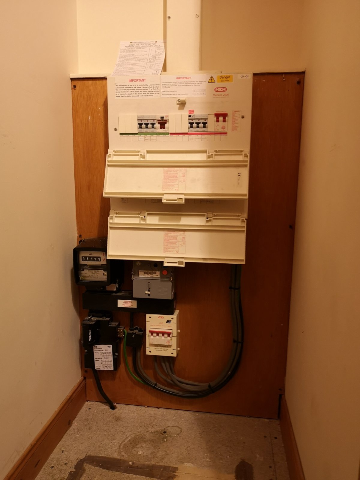

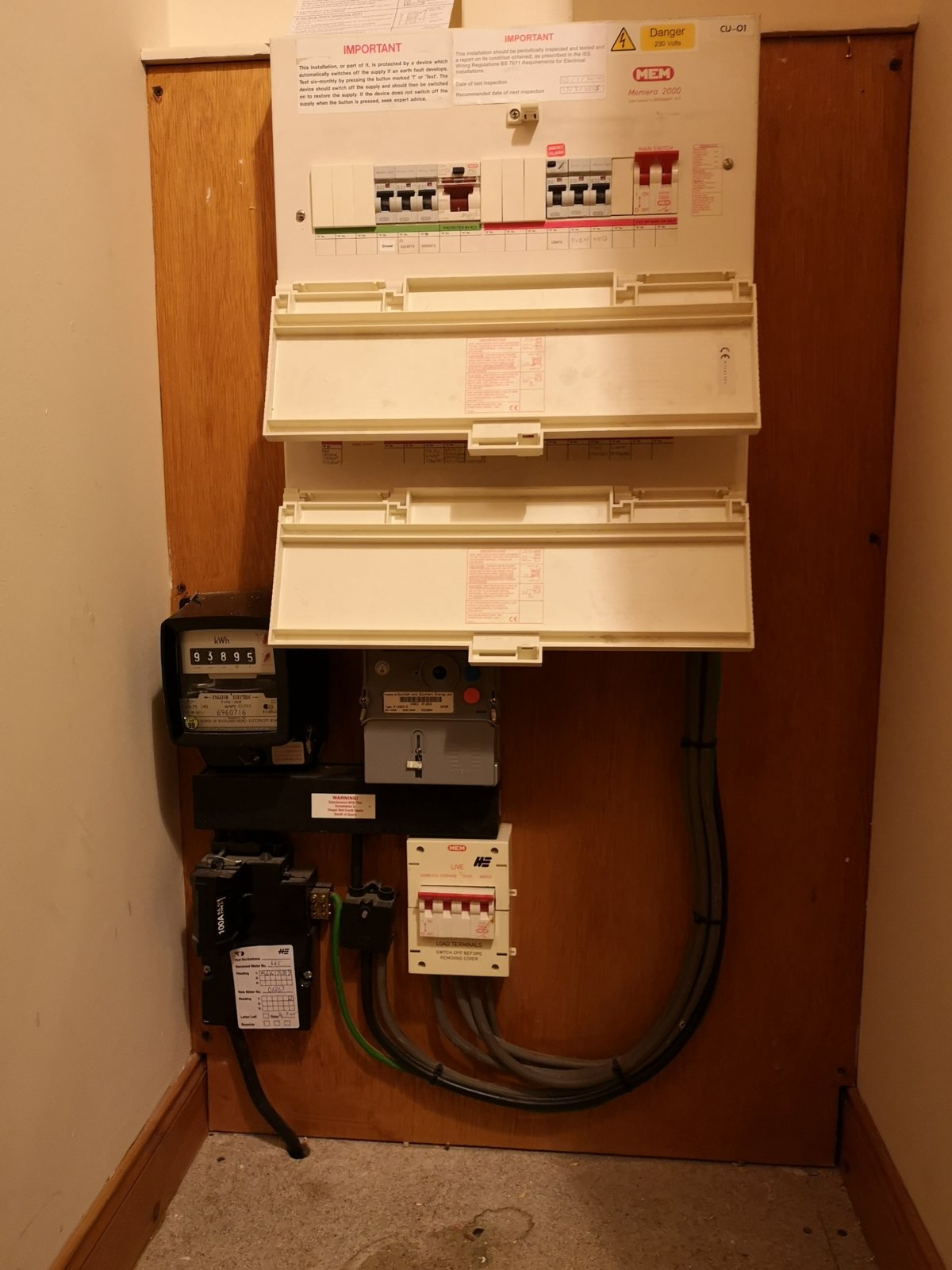

Below is my fuse box
Can you stand back and take a wider pic of the CU please

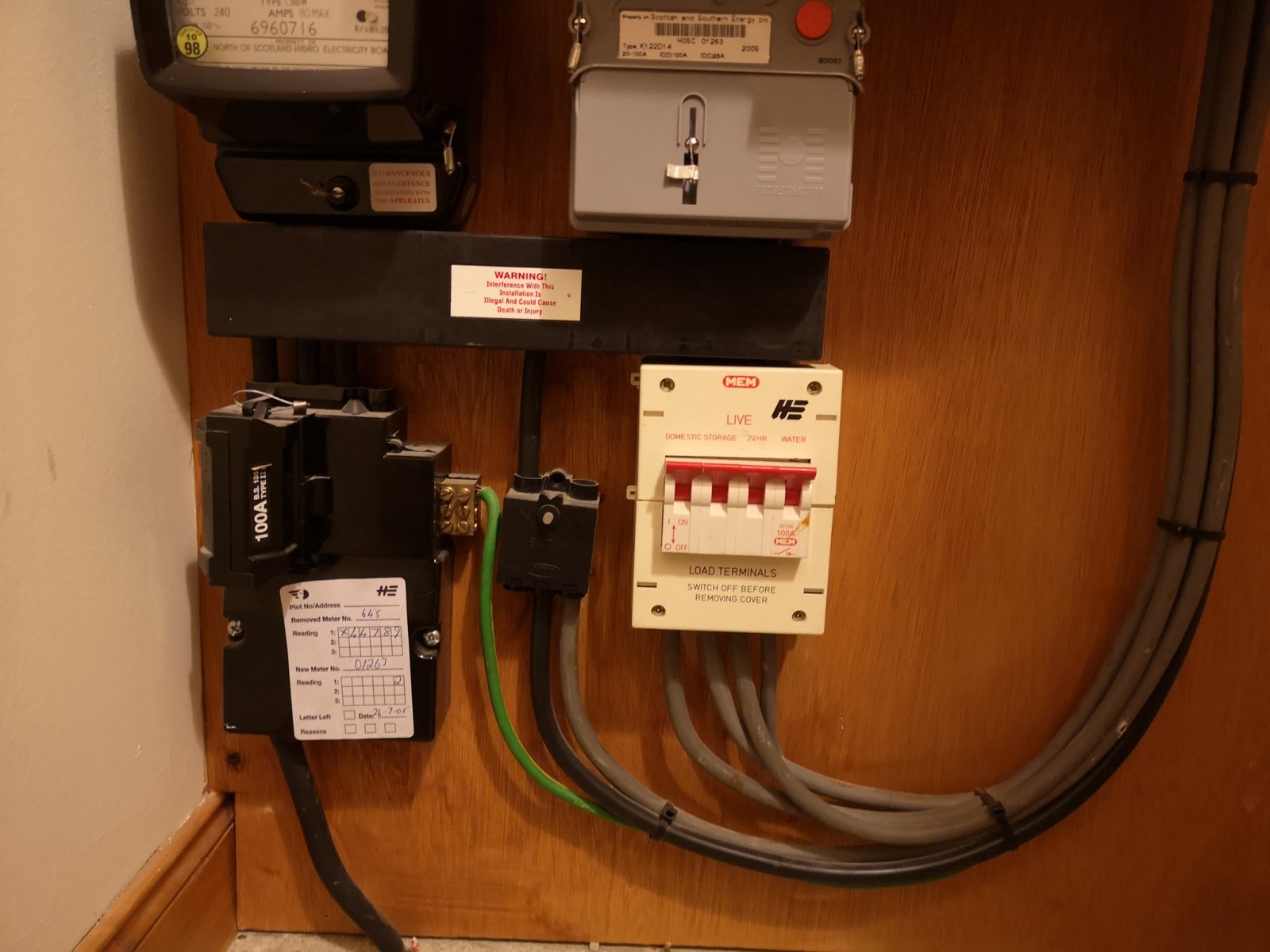

Also a pic that shows all the thick cables between your meter, teleswitch, big main switch and CU
