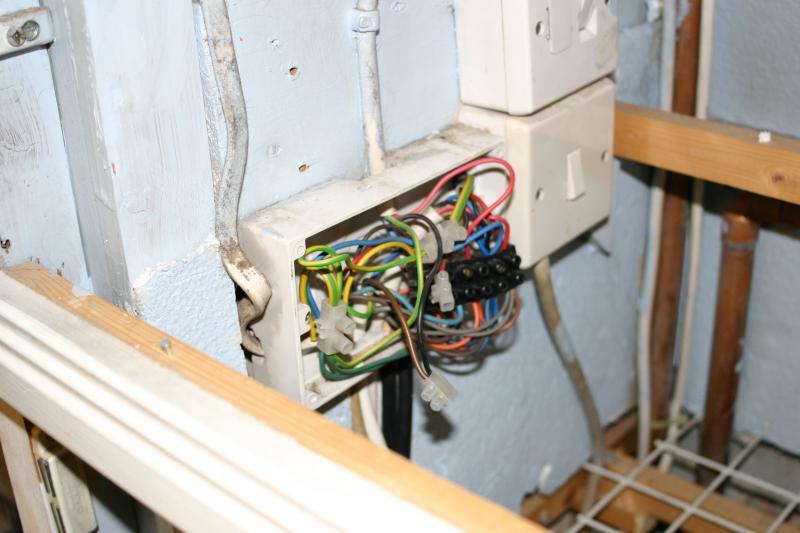

Right it seems that the pump live from the boiler goes into the external wiring centre then off to the Pump (see external wiring pic It's the Brown and black connected by the chock block). So it's wired incorrectly. Could this be a work around> i have noticed there is no CH out, DHW out, DHW off out terminals (optional extras) in the boiler. Which i think should be in place for gravity hot water.
